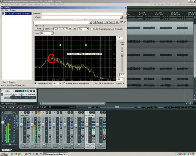

Ok, heres an example.This frequency ive circled tends to make this really annoying sound, and ive realized i only hear that annoying sound with this frequency thing.. BUT when i try to lower only that particular one. the ENTIRE tone changes...
What exactly is that source? 'Cause what you circled kinda looks like the fundamental . . .
