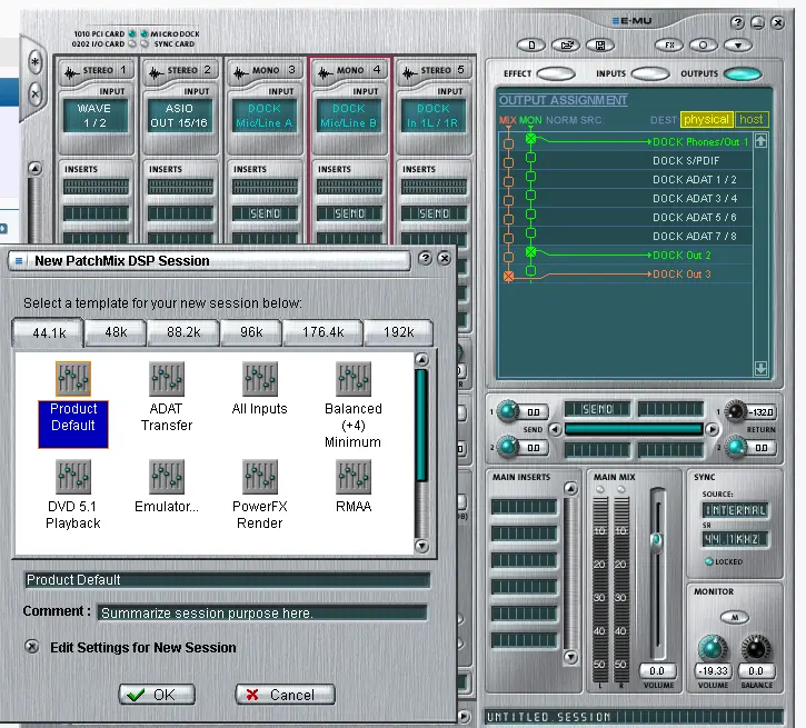

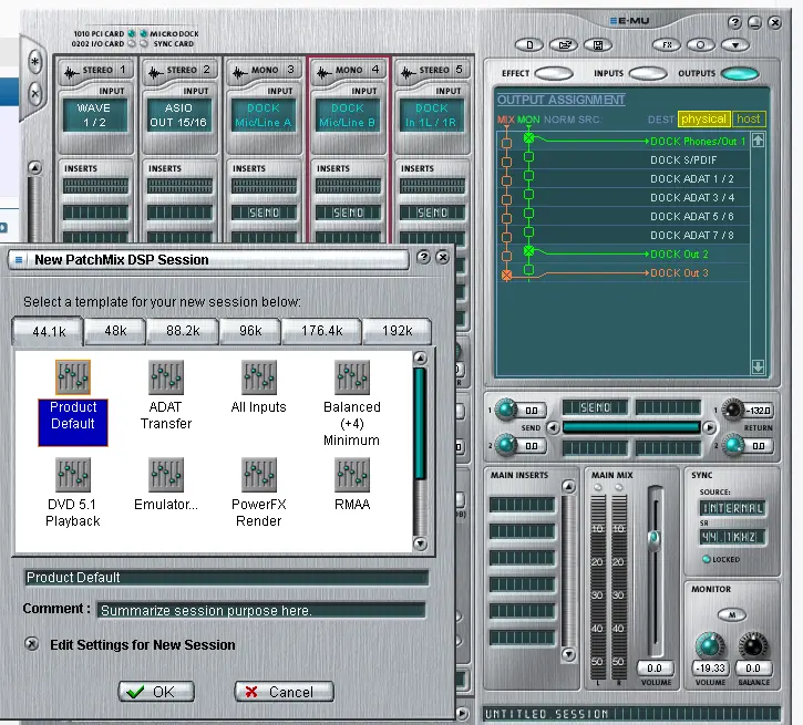

Hi again snatchman,
The more I read the problem, the more it sounds like a routing one, If one input on the dock front is making it into Reaper but not the back dock imputs could it be that the dock inputs have become disconnected (Not physically!)but un-routed in the dock?,, Something that has happened to me quite a few times which is why I stick to my saved session!.
+1.
If you can see confirmation that audio, on all channels, is getting to Patchmix then you can rule out hardware completely, including cables.
