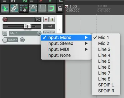

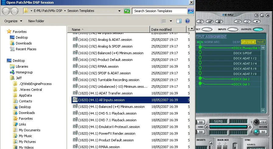

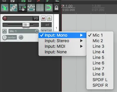

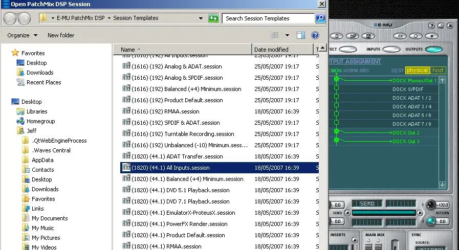

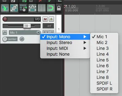

Have you tried a new session?;View attachment 101941

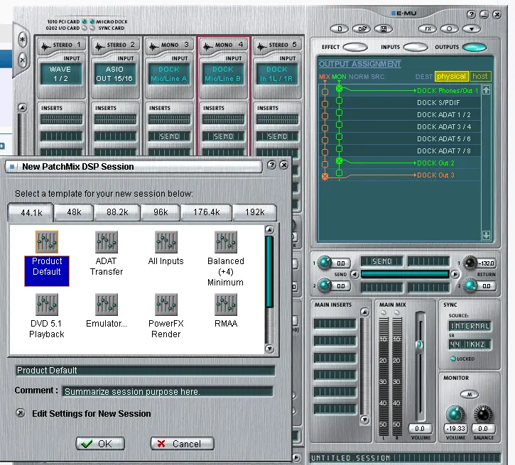

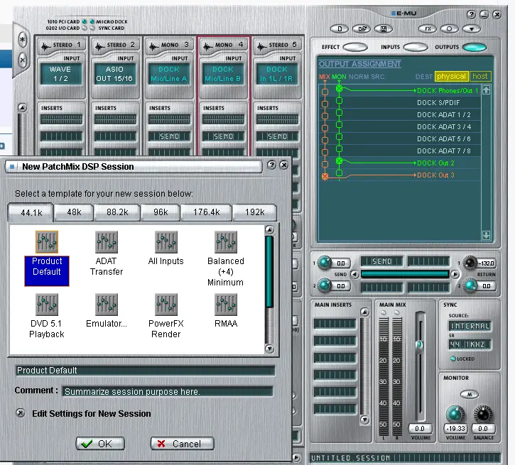

The more I read the problem, the more it sounds like a routing one, If one input on the dock front is making it into Reaper but not the back dock imputs could it be that the dock inputs have become disconnected (Not physically!)but un-routed in the dock?,, Something that has happened to me quite a few times which is why I stick to my saved session!.
Hello..Thanks for the reply and pic..!..Yes, I've tried a new session also..Actually looks similar to your pic. On the physical route in Patchmix, what's the difference between having the mix box checked vs the monitor box checked..?..They have always seemed to do the same thing. I think I have all the mix box checked, not monitor..!..
