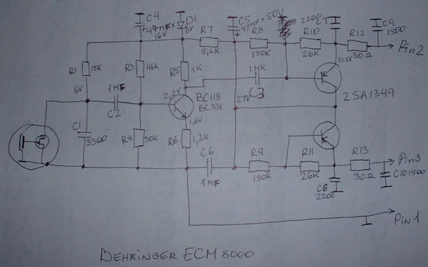

Here is complete schematics of the stock one:

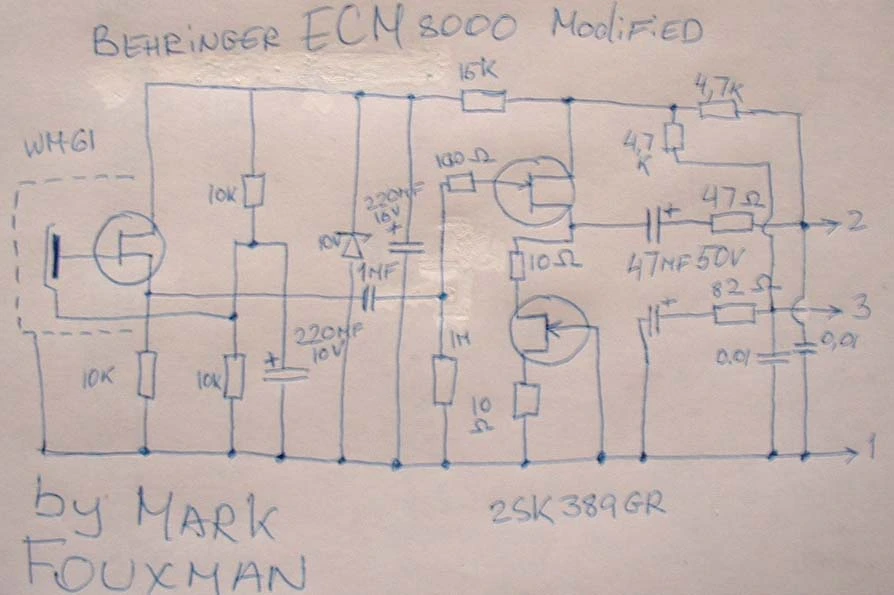

Here is the schematics. Please note (it was idea of PRR) that the capsule is floating, and not connected to the ground for even greater than Linkwitz SPL handling. The noise is considerably less than stock one. But even bigger improvement was in clarity, transparensy, details, and bass definition.
Thats a nice welcome here, I just joined and the schematic appears. thanks !
And I like the twist with the ground of the capsule at a mid-tap. Sounds like this mic just begs to live inside a kick-drum :-)
But I'm struggling a bit what the mid-tap accomplishes - techs usually start talking they need sleep when they see something they want to understand but just don't grasp at some moment.
OK, let's see, the mid-tap in fact decreases the polarizing potential ? This won't be it.
It also increases the biasing of the FET - that's closer to the explanation perhaps. Please tell (or forward PRRs description - likely he has mailed you a nice little story about this twist ?)
Bye,
Peter
If I'm correct the 2SK389GR you specified is a dual JFET. Are you using this mainly because it fits the existing layout well ?
Or do you consider the matching essential for the FET-stage ? (it won't hurt of course)
Thanks,
Peter

Peter welcome!
<And I like the twist with the ground of the capsule at a mid-tap.>
Normally, to make the capsule's FET to swing a lot of voltage, you would need to use +/- voltage (+ to drain, and - to source through bias resistor) and to connect the capsule's body (internally connected to diaphragm) to ground. Since we have only + polarity of the phantom supply, we fake it. This way diaphragm in reference to the FET is still at the same relationship.
<If I'm correct the 2SK389GR you specified is a dual JFET. Are you using this mainly because it fits the existing layout well ?
Or do you consider the matching essential for the FET-stage ? (it won't hurt of course)>
Yes it is a dual matched FET. It got to the place of 2A1349 (same package). You could use matched 2SK170 here, as well.
I soldered everything on the stock board, however, I needed to cut some traces and put many parts on the other side of the board.
It would be much more convinient to make a dedicated PCB for this circuit.
Hi,
I dared to write:
and remembered having seen nice stuff about JFETs. Marik, you probably are familiar with these articles:
http://www.borbelyaudio.com/index15.htm
JFET buffer is in fig.15 of http://www.borbelyaudio.com/ae699bor.pdf
and it also says:
If the two JFETs are matched and the
two source resistors are equal, then the
DC offset will be very small.
OK, that explains it.
Let me end with two small questions that are just based on the mentioned article, and definitely not on the hands-on experience you have with this circuit. (so please tell if they're perhaps true from the technical point of view but still can better be done otherwise):
#1 could it be that the 1M biasing resistor should also be halfway the supply i.s.o. ground ?
#2 the output to the 47 uF cap, should it be attached to the bottom terminal of the upper 10 Ohm resistor ?
(if so, the 47 & 82 output resistors would of course also change)
FWIW...
Bye,
Peter

<Marik, you probably are familiar with these articles:
and it also says:
DC offset will be very small.>
Yes, I am familiar with this articles, however in the Borbley circuit there is +/- supply, so carefull matching is essential for DC offset
reason and thus eliminating coupling capacitor. Since we have to use this cap anyway carefull matching is not crucial. At first I played without input (1uf) cap as well, using 5V DC from the capsule for biasing output buffer. However, it requared dropping the voltage on the buffer to 10V, which reduced its overload capability.
<#1 could it be that the 1M biasing resistor should also be halfway the supply i.s.o. ground?>
No, I use this resistor as a gate leak one, so the buffer is self-biased. If you connect it as a bias resistor the stage will draw too much current and the supply voltage will drop considerably. (know that, done that)
<#2 the output to the 47 uF cap, should it be attached to the bottom terminal of the upper 10 Ohm resistor ?
(if so, the 47 & 82 output resistors would of course also change)>
Yes, it can, however the difference would be small.
