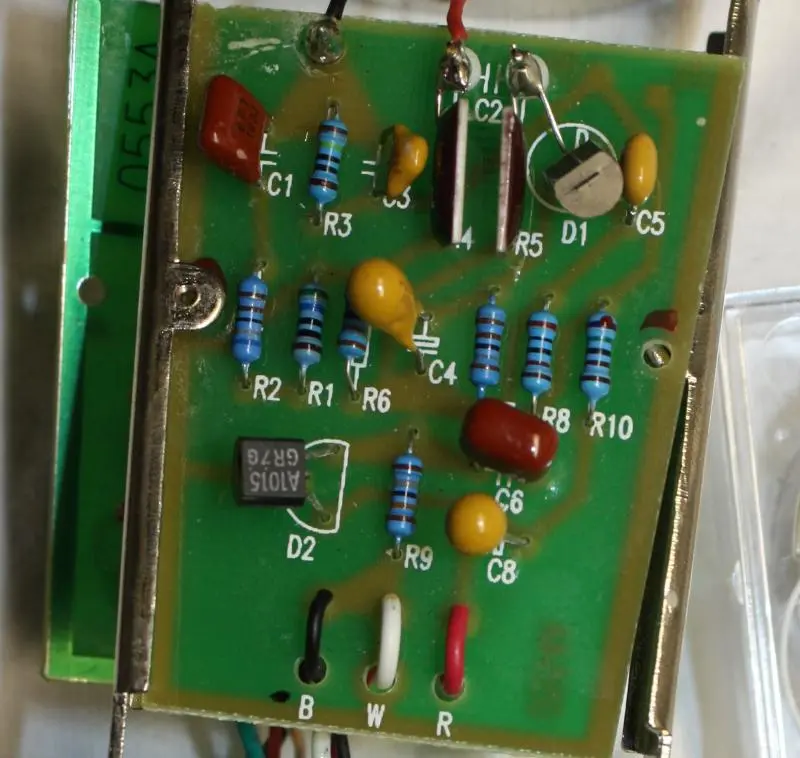

Here is the unmodified board. hte mod removes R10, R9, C6, Q2 (Labeled as D2) and moves C8. Also, I changed C2 (aka C4 on the mod schem) from 1000pf to 470pf, which is on the orig U87. If you compare the two schematics, they look a lot alike;

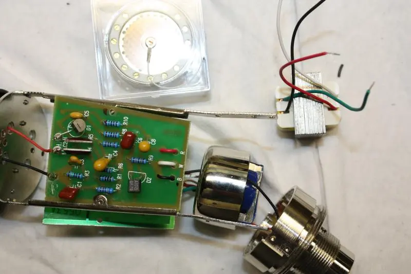

Here is a shot unmodified and apart, modified, and a close up of the board. (I think) Again, the uploader is say it with me a piece of crap...
