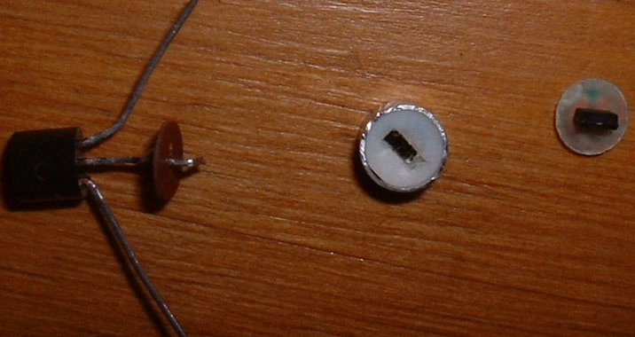

I just opened both WM60 and WM61 capsules. They have different back chambers, different backplates, and their FETs read respectively 1X:P and 1X:H. It is impossible to do something with WM60 without busting it, however I was able to connect 2SK170 to the WM61. The output was muuuuch lower, what makes me think that the internal FET has much higher transconductance--I did not measure it yet. I connected the capsules to the mic and the WM61 has noticably higher output and lower noise. I did not check the SPL hanling yet. To summarize progress and what we know for today:

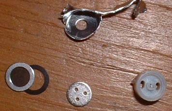

The WM60 busted. From left to right: diaphragm, glued to ring. The ring also works as a spacer between body and diaphragm, and creates a resonator. Next, spacer (black ring) between diaphragm and backplate. Backplate (WM61 has four holes). Backchamber.

WM61 opened. On the left 2SK170 prepared for installation, on the right original FET on PCB.
WM61 assembled with 2SK170:
Marik said:
Some pics.
You mean the backplate (WM61 has three holes) right?
<You mean the backplate (WM61 has three holes) right?>
Sorry for being unclear. The picture shows the WM60 back plate, which has 3 holes. The WM61's backplate has 4 holes.
