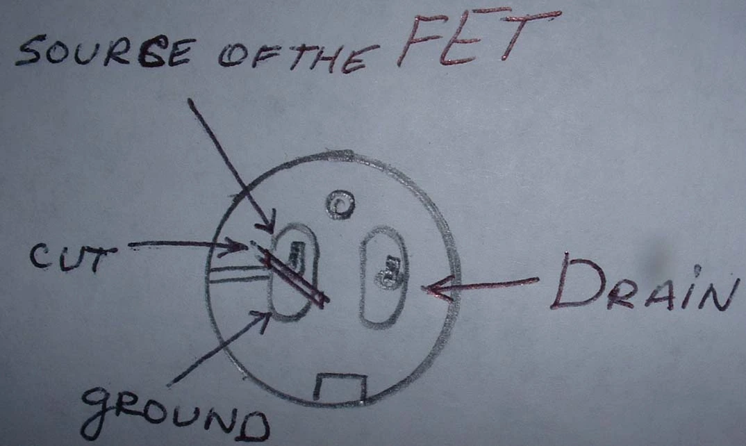

Now, how to make a ground connection...
First, take a braided solder remover and remove solder (this one sounds great, isn't it? :) ) from the contacts on the capsule. You will see a tiny hole and a FET's leg, bent over to the top side. The picture will tell you the rest. Don't forget in the end to seal the hole with silicon, otherwise you'll get LF loss.

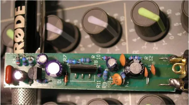

OK, you shamed me into taking time to open up my ECM's and take a couple of pics............to my non-techie eye there are differences, but whether or not it is the same circuit as earlier pics here that has been layed out differently I won't attempt to guess.
:cool:

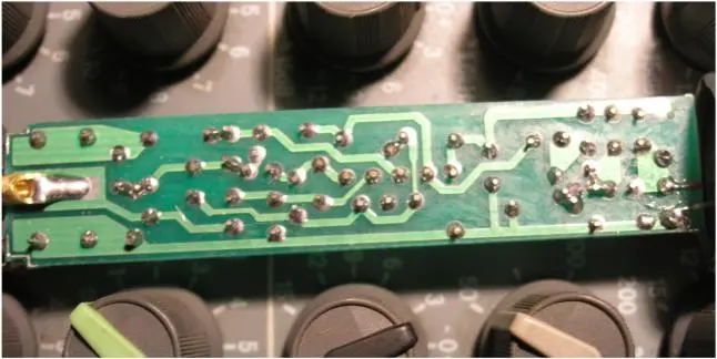

And here's the underside of the PCB.
BTW, before anyone asks WTF it is that has RODE on it in the previous pic, it is a set of jewellers screwdrivers compliments of RODE:)

That looks like a "standard" type circuit. It looks alot like the circuit in sampsoms C01s and C02s.
The single transistor should be a fet marked 105 or 305 the IC is a dual PNP pair I believe. Could you post the numbers and values of the caps I can't see. The two small ceramics "should" be marked 102 1000pf RF reduction caps. If I have time I will trace the schematic from the pics.
Ausrock,
It seems to be the same circuit I posted earlier. The surface mount caps changed to electrolitics, though. Thank you for taking these pics! :)
