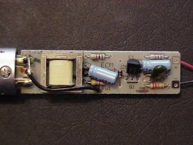

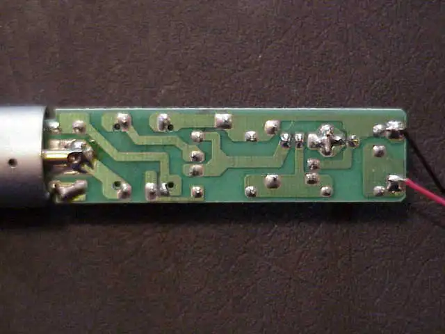

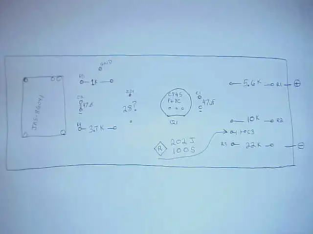

I pulled apart my mic and here is what was inside.

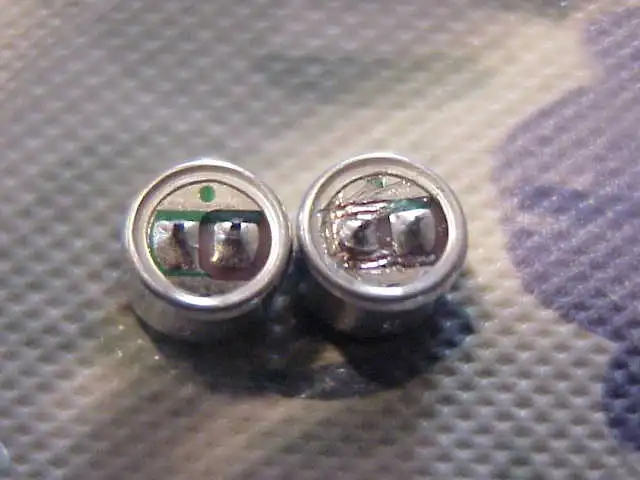

I did the Linkwitz mod on a WM61b which seems to have lowered it's sensitivity about 12db. Here is a pic of a side by side. It was easy to cut the ground connection with the tip of a razor blade scratching around the post.

I need to redo the linkwitz mod, I have .8 oms resistance from the post to the case. I am not sure but that might explain the drastic db loss.
<I pulled apart my mic and here is what was inside.>
Huh baby! Swapmaster is the first person has it with transformer!
OK, I will draw schematics and post latter tonight. Pay attention at different construction of the ring around XLR connector. Mine version doesn't have this ring --it is integral part of the body. Interesting. Thank you Swapmaster.
<I did the Linkwitz mod on a WM61b which seems to have lowered it's sensitivity about 12db. Here is a pic of a side by side. It was easy to cut the ground connection with the tip of a razor blade scratching around the post.>
Yes, it should lower the gain, but probably only by ~5-6db. The source should be well isolated from the body of the capsule.

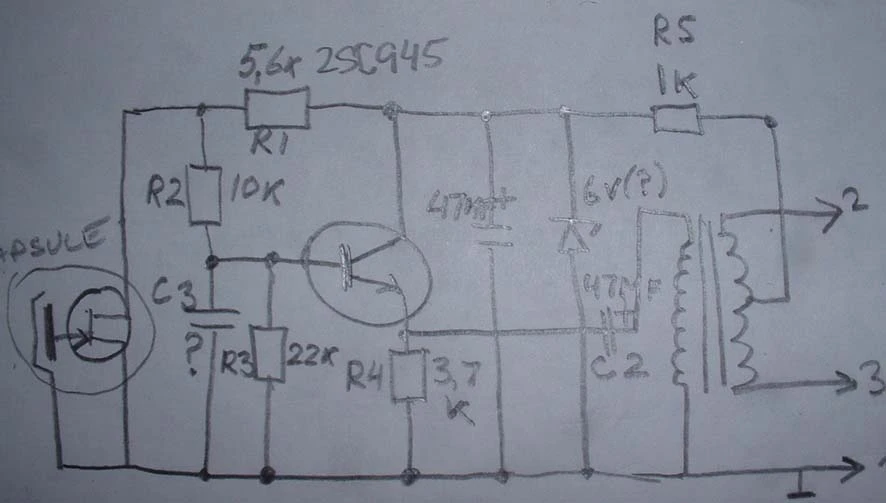

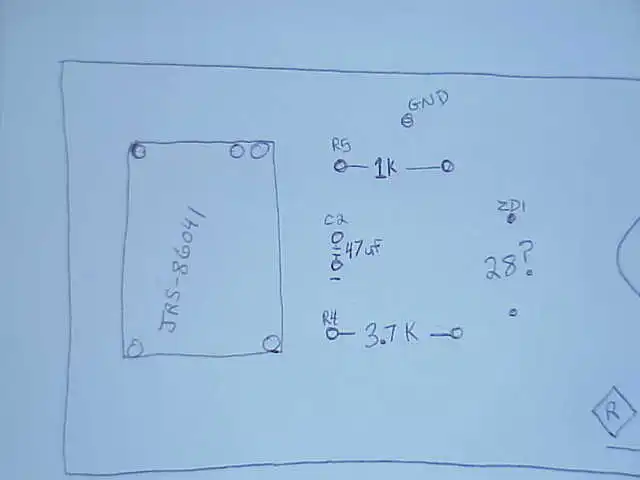

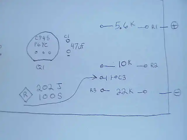

What is a tyope of transistor Q1 on the PCB?

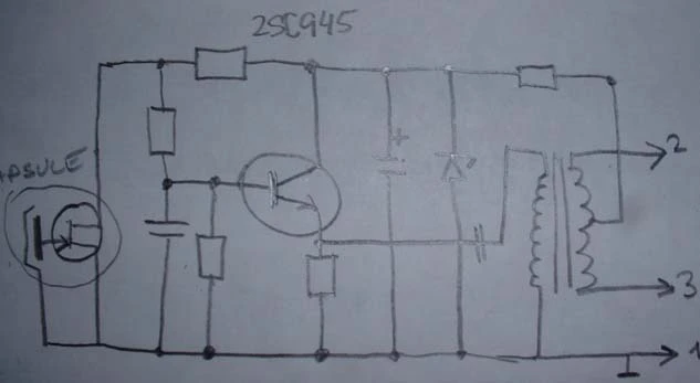

Here is the reverse engineered schematics. It is hard to see component values, so if you can, please add it to the picture.

To do the Linkwitz mod on a WM61b. Scratch around the grounded post with the tip of a razor blade to cut the ground. I have done a few of them now and it only takes 2 or 3 minutes. The other post easily solders to the silver area with the green dot in it (see picture in earlier post). That's it, you are done, less than 5 minutes.
Here is the schematics with values.
Yes Swapmaster, it seems that it is easier to cut and make connection with the WM61B vs. WM61A. Thanks for the tip.

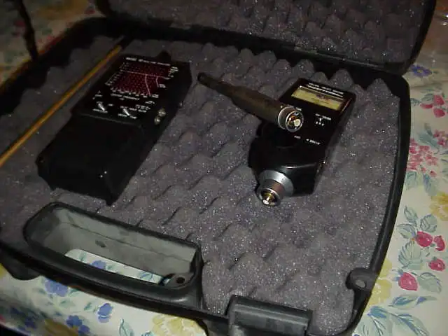

The .8 ohm resistance dropped db's by12 over an unmodified one. Got a good connection now and it is about 5 db down from the stock mic and I am very happy with it. I don't have a mic preamp yet so I removed the preamp from the mic and made a steel adapter to mount an RCA jack in the bottom of the Behringer. I feed it into a modified Radioshack SPL meter which has a reasonably clean and very flat preamp then from the line out of the meter to the laptop.

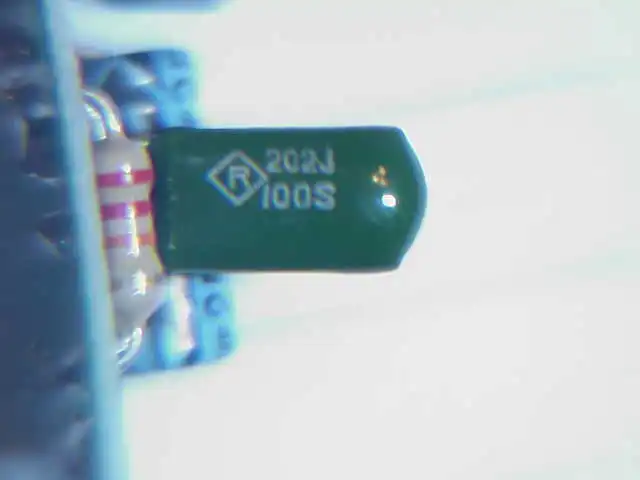

Marik, here is a closeup of the unknown cap. How can you take closeups of these things easily? I am using a digital camera looking through the little high mag bubble on a magnifying glass.
