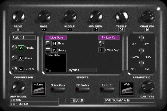

Yeah man, very nice tone there. Give some details on that bass chain if'n you would. I know its the ped. providing the strings, whats the rest of the chain? ...especially compressor you are using and the settings. Very nice here man.
g
Fretted Pedulla (Ernie Ball Slinky) > Bass Pod (using SWR SM-400 amp, see settings in pic below) > Behringer UB802 (used as router, no eq or pre-amping used) > Soundblaster Audigy > recorded at 48Khz in Cakewalk Homostudio2004 > converted to mp3 at 192kpbs with Fraunhofer codec.
The Behringer is an essential part of my delicate sound, of course LOL :D

..very infomative post ped, thanks for that. ive never used a bass pod before. Ive messed w/ running bass through a j-station and didnt like the results... I guess i just figured the pod would sound similiar. Im gonna have to take my guit downta guit. center and try the pod out. This is definitely nice.
Oh yea, I forgot to mention 30% chorus effect on the bass too! Probably kind of important. :rolleyes: Sorry!

O, and btw...the settings are Pod settings. Not sure whether 83 means 83ms or 83 horsepower....
