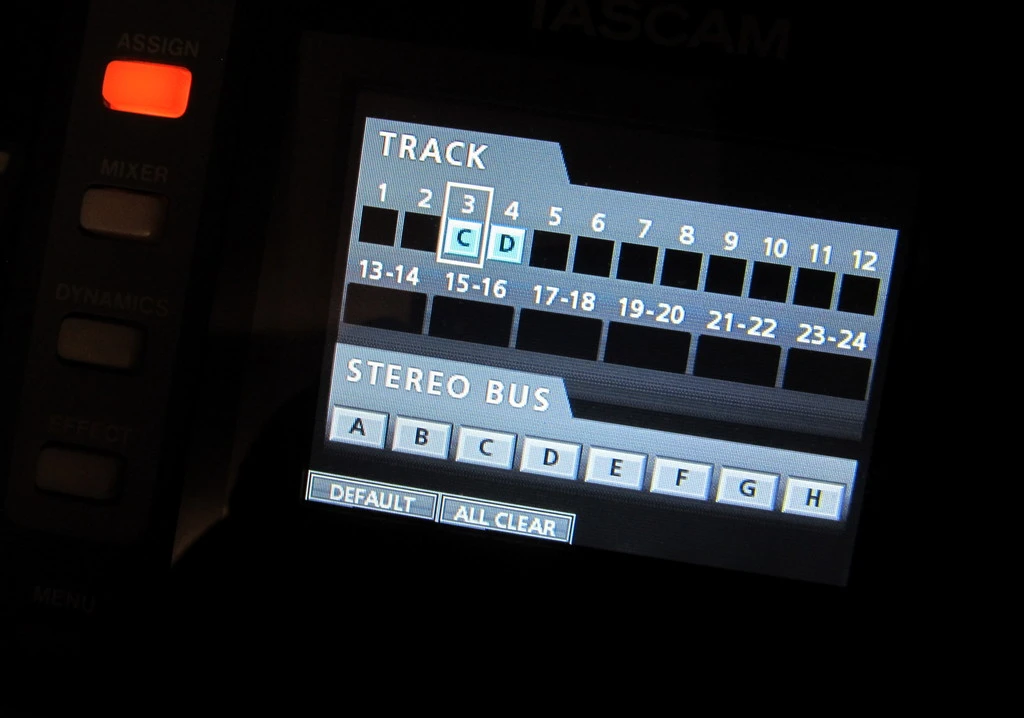

Below I've got the SR16 going into selected input channels 'C' and 'D' and assigned to tracks '3' and '4'. Inputs can be assigned to any of the tracks. Arm the tracks with the 'REC' buttons for the tracks and then set the input gains to the recording levels you want. Adjust track and Main faders for comfortable levels for monitoring. By default each track is panned 'center'. Use the Mixer to pan each track left or right.
