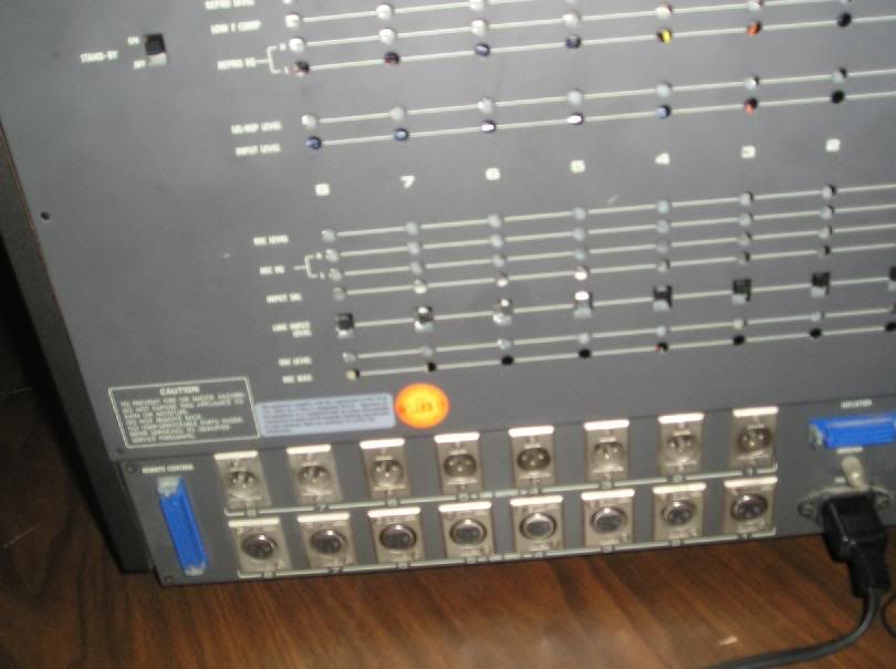

A Reel Person said:because it's only a 12x2 live mixer, with no adequate facility for separate 8x2 cue monitor, a feature which differentiates a "live" mixer from a "recording" mixer. However, cue monitor may be handled by an external 8x2 line mixer such as the Tascam M-1B. The M-1B has unbalanced RCA connectors, so would require some adapters to hook to the Otari.
Going from 1/4" unbalanced mixer outputs to XLR balanced recorder inputs is only one of your issues!
A Reel Person said:Y'know,... I thought about it twice, and although a 16x2 channel mixer is better than 12x2 for an 8-in/8-out/8-track recorder, it still doesn't solve your need for an isolated cue monitor.
For instance, you'd never want to have the Send and Recieve (mixer) channels turned up for any single (tape) track simultaneously, because when you enabled Record on the track, you'd create a terminal feedback loop in the stereo-buss section!
If you're ALWAYS ULTRA CAREFUL to never have a send and return channel on when you enable a track,... it can be done, I'm not gonna say it's impossible, but you're barely squeaking by, as such.
Also, in the studio environment there's no such thing as "never", because if you configure that way, I'LL GUARANTEE you'll create feedback at one time or another. Mark my words, it's almost unavoidable the way you'd be configured. You'd be better off with two separate 8 channel mixers, than with a 16x2, for an 8in/8out recorder that records 8-simultaneously.
Just my thoughts.
Good luck!
antispatula said:oh yeah! Yes it does. That solves my problem then? It'd still be good if you could explain a little more, since I'm naive to lots of this, and I have another recorder with no headphones jack. What is it that my mixer lacks that is needed to record properly?
A Reel Person said:the headphone monitor should serve as cue monitor on the Otari, and you should be okay with that.
The Fostex R8 does not have an internal cue monitor, and so would depend on the mixing board to provide that function.
I should reserve all comments on the Peavey 16x2 mixer, because I'm not familiar with it. If it has a monitor send section, that helps a lot, but I cannot say for sure how well this mixer would adapt to 8-track recording. You just have to try it.![]()
