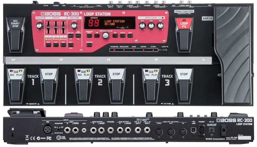

This is the RC300..
There's a PHONES jack in the back of that thing. Is the hum present there, as well, whether connected to the amp or not? Amp on or not? Etc...
