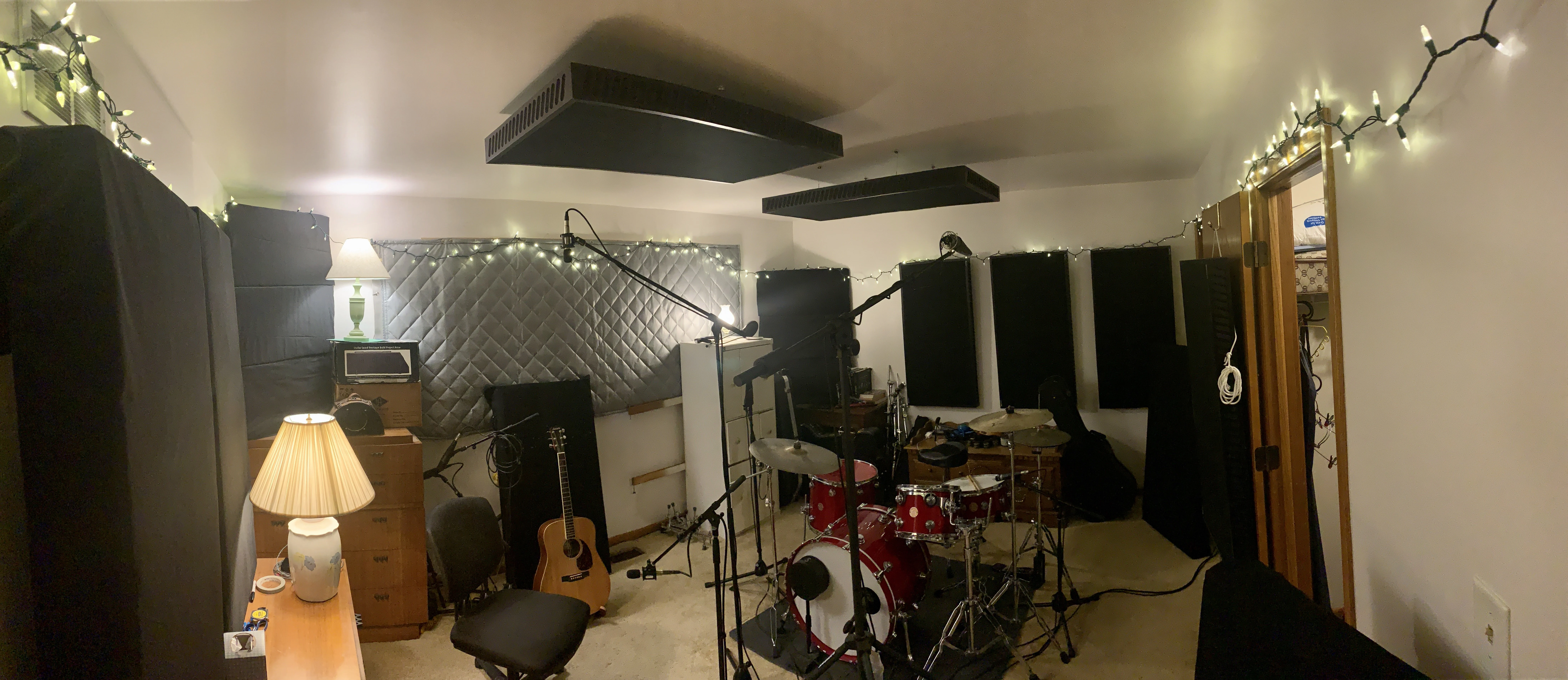

In addition to the panels that were already in the room at the time (RealTraps MiniTraps plus homemade 4" thick Rockwool panels), I have subsequently hung a couple cloud panels up since I put the bass traps in last year. It all adds up, and stuff is sounding pretty tasty in there :)
I guess you gotta make compromises in a home studio, non-purpose built room!

Definitely spend more time than I did making your bass traps look good :). I did not prioritize looks on my triangles. The fabric probably could stand to be hit with the clothes steamer, because more than a year later there's still wrinkles from how it was originally folded up, ha. I have doors in two of the corners of that room, so I can only put stacks of those triangles in the two corners as seen in the picture. When it comes time to track something, I just place a couple rectangular panels in the two door'ed corners and seal myself in the room a bit. It's a little bit of a pain to place/move it each time I go in and out of the room but it's not the end of the world.
I was shocked that the triangle traps made that much of a difference! I totally thought I was going to eat the money I spent on making them, but the A/B test resolved me to making more. I want to see what they can do in the closet with the guitar/bass cabinets. Since I put all those traps in there I record as much as I can in that room now, even though it's easier to sit at the computer in the other bedroom (which does have panels in it, just not like the drum/recording room). Everything sounds SO good. You can use more distance on the microphones and not have things sound smeared or muddy. The punchiness of the drums an how much better they come through in mixes is just huge to me. It's like hearing an out of focus vs. in focus camera if that makes sense.
I also love that close mic and direct overhead setup for acoustic guitar in that room. The guitar is also punchier. Everything recorded in that room just sounds like the instrument instead of instrument smeared with room.
