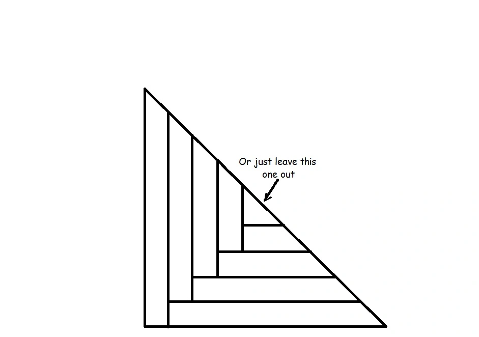

You could cut the Rockwool into sections using poultry or fabric shears (cuts easily) and layer them into a corner of a cardboard box (removing excess box sections), then set in corner. Repeat and stack to ceiling. Wrap in acceptable fabric to make pretty.
Here's just one example of how to :

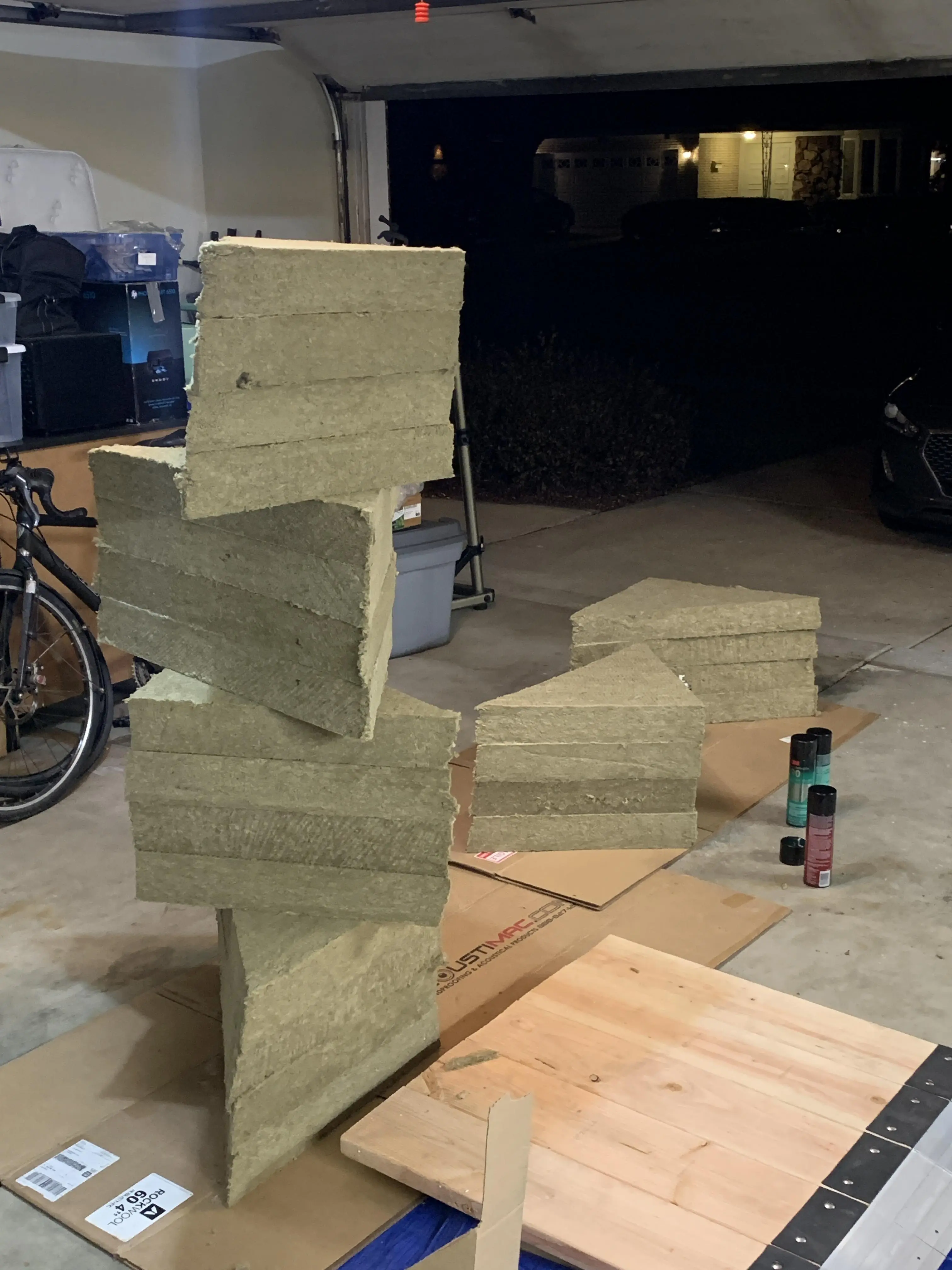

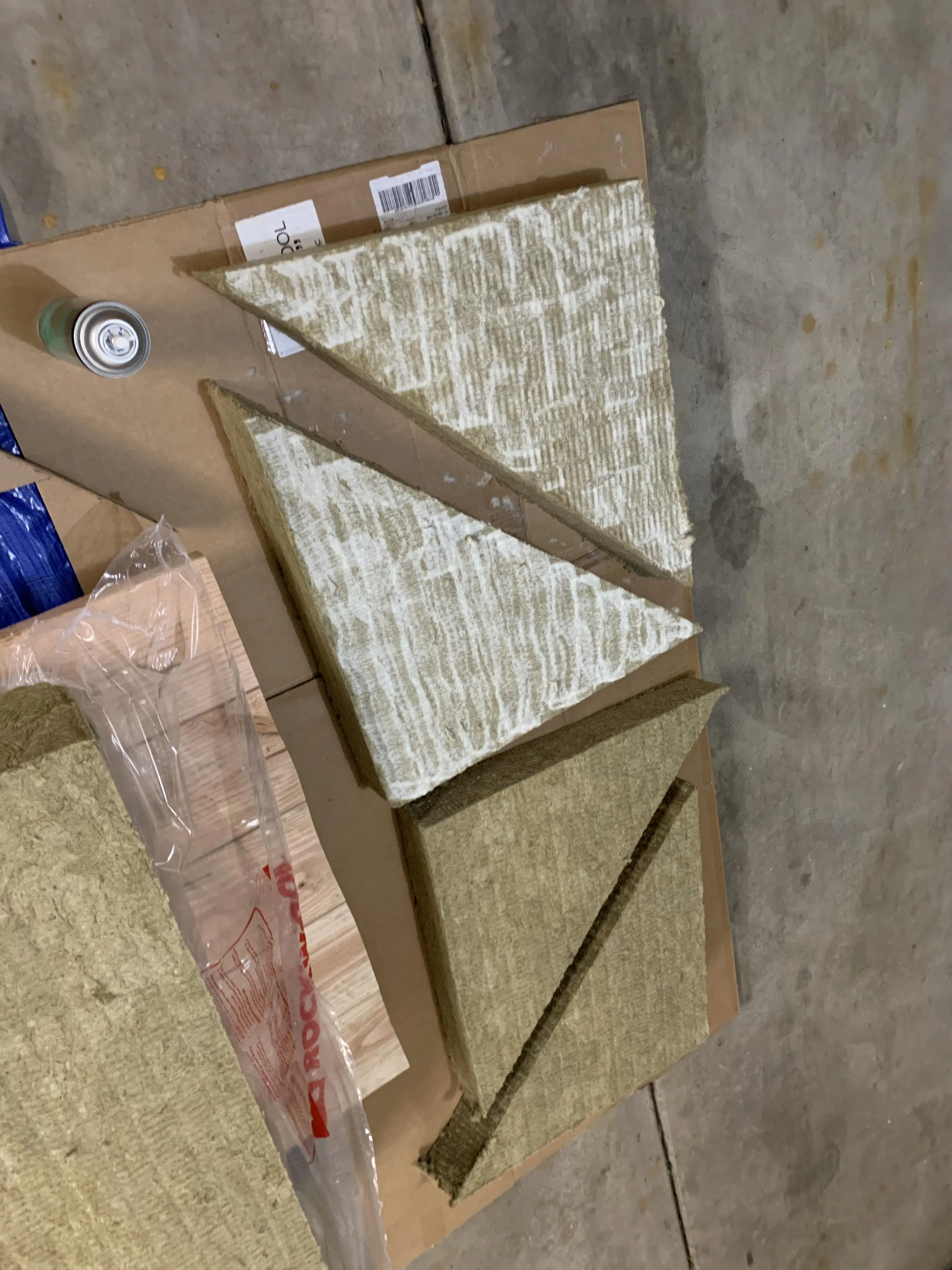

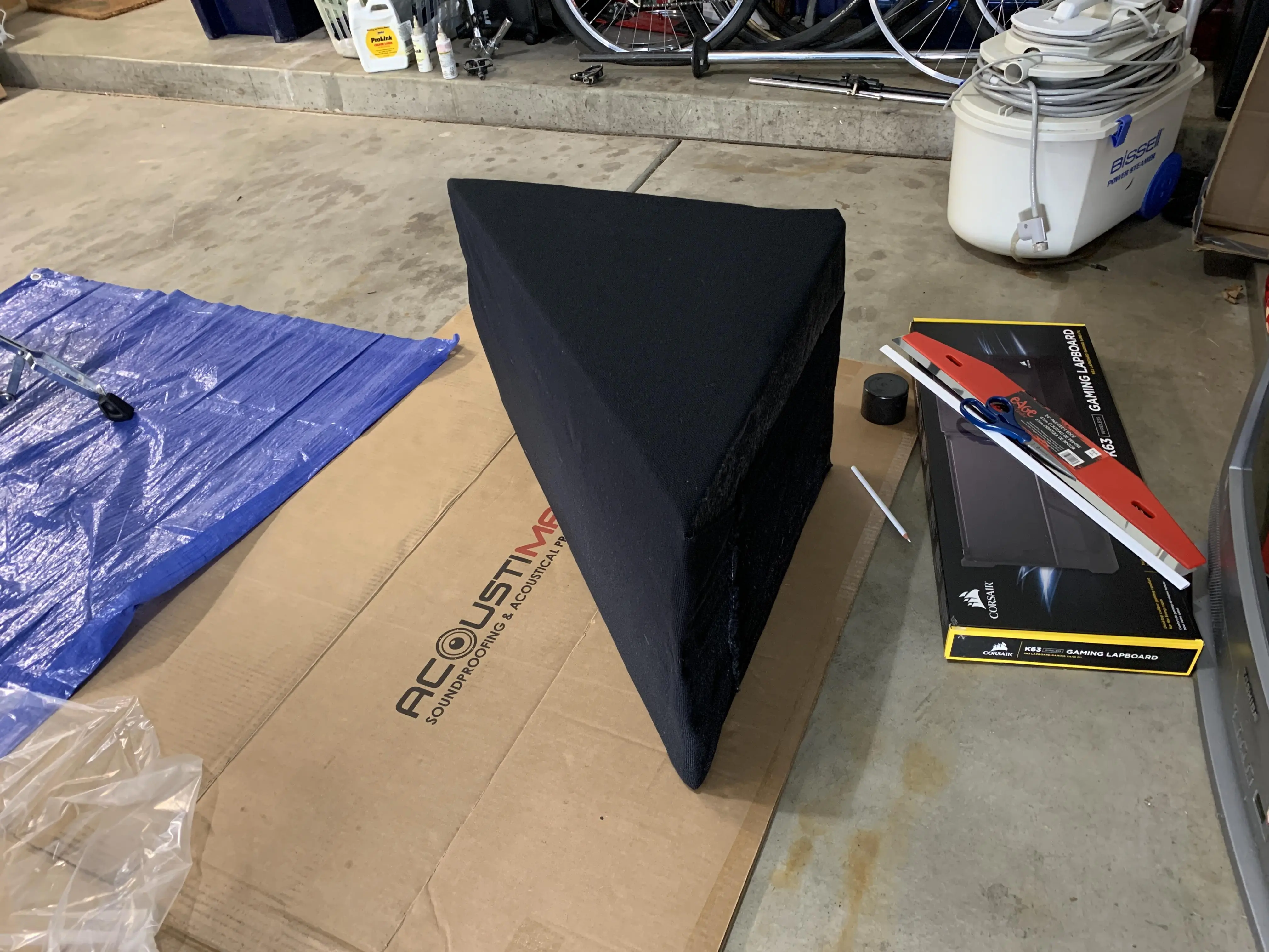

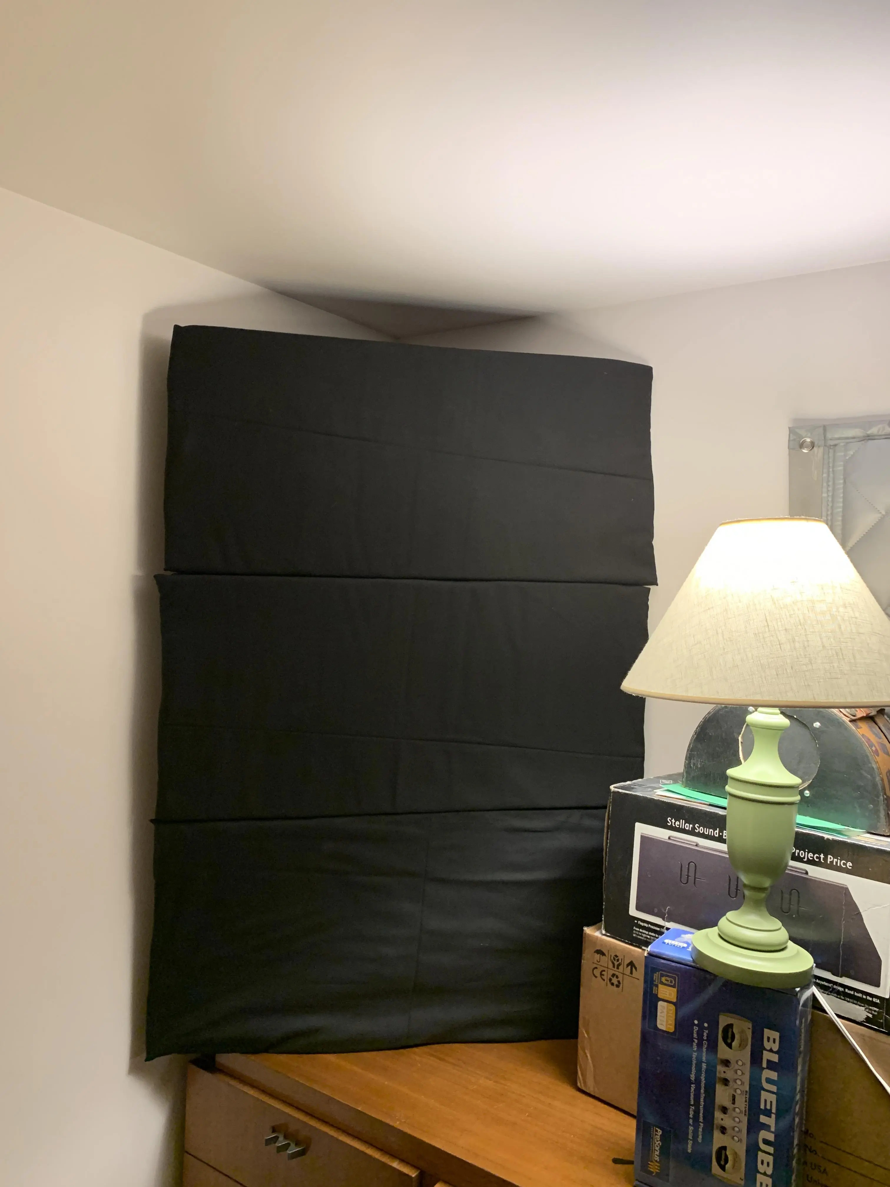

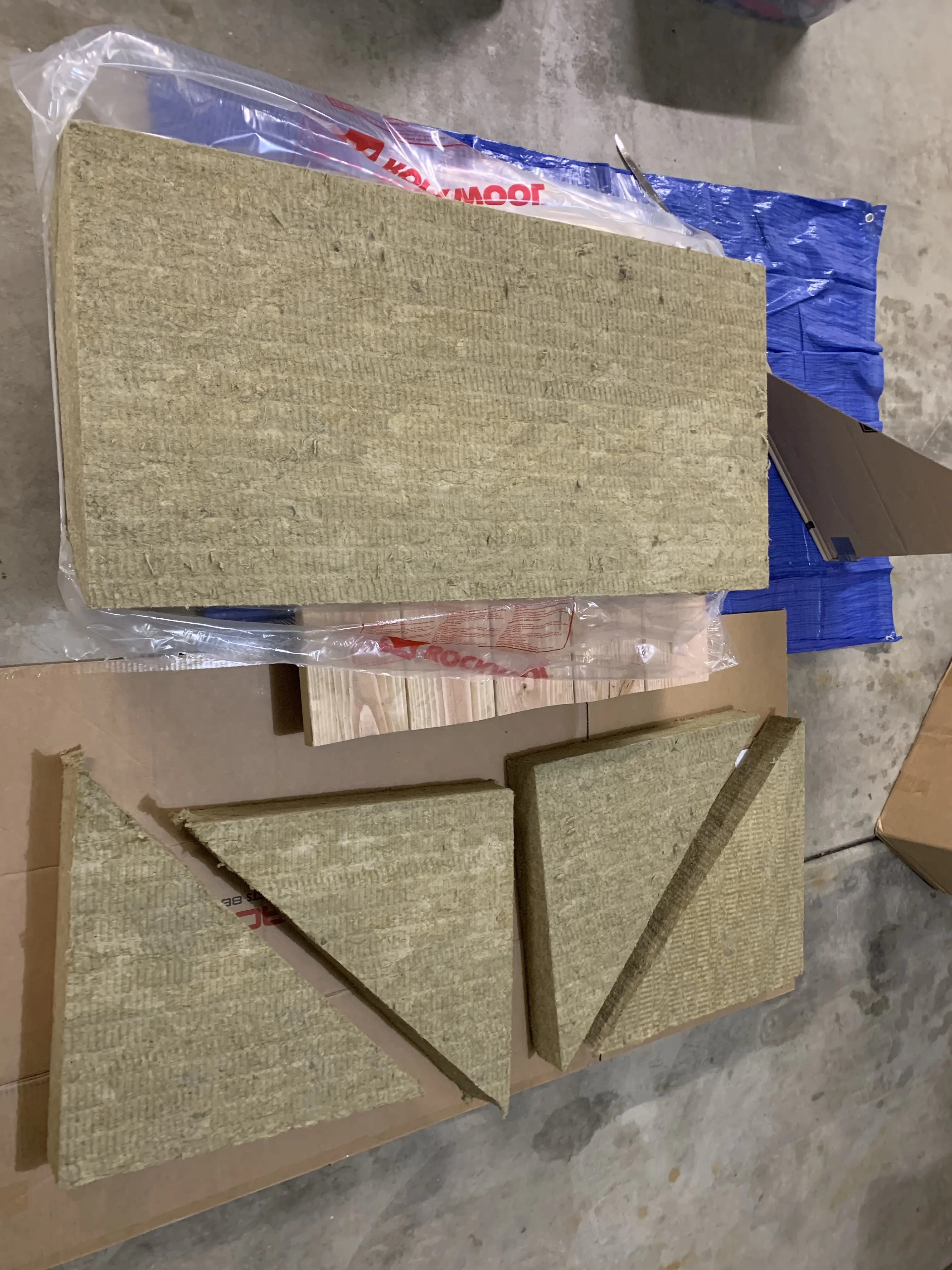

James, here's how I cut my 2' x 4' x 4" (~1.2m x ~0.6m x 10.16cm) rockwool panels and turned them into bass traps: I ordered two packs of three panels each, cut each panel with a bread knife. Used 3M 70 (the 90 in the green can works too but the 70 in the red can is strong enough) spray glue to glue the equal triangle-cut panel pieces. I got one 4-stack cake slice triangle out of each panel. I went to a fabric store and found cheap black fabric that was breathable, and glued that to each triangle, then just stacked three in one corner and three in another corner, both on top of a dresser or table.
There's a big difference! You need mass to absorb. Leave a couple inches/a few centimeters space to let air and sound around the back of them. My drums are a lot punchier and the things I record in the room sound more like just the instrument instead of the instrument and a smeary room. The biggest sort-of-unnecessary expense was shipping costs, if I can find a place that I can just pick up more panels from I will do that. I'd like to build 3-6 more triangles to have more in that room but also the little closet I record amps in that is off that room
