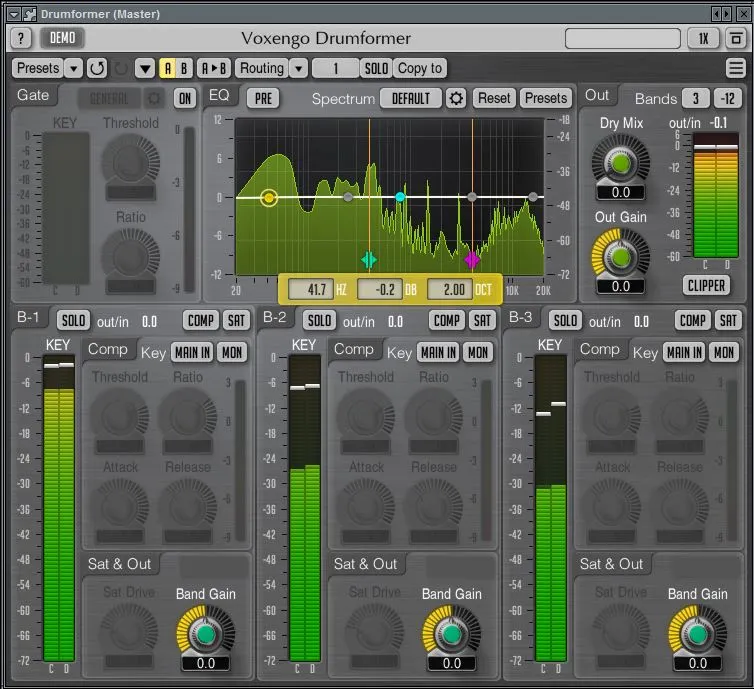

Looks like from the Drumformer pic that there is quite a bit below 100. Can't tell with that popup thing in the way tho. Looks like and sounds like there is a bunch going on in the sub region.

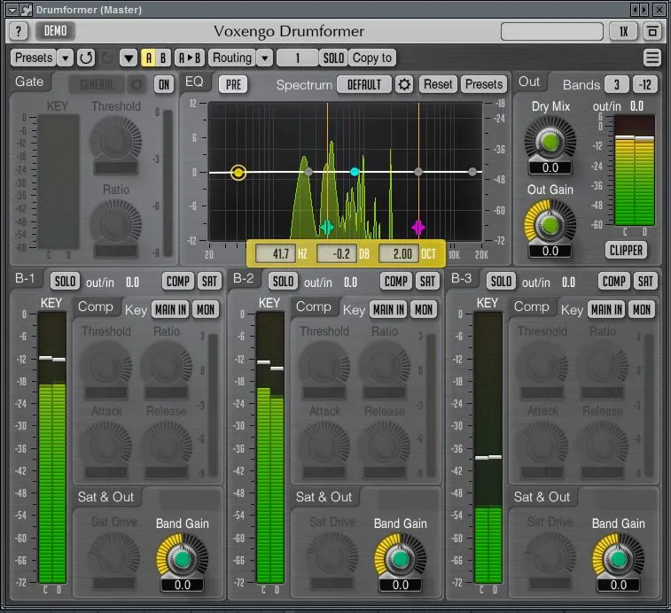

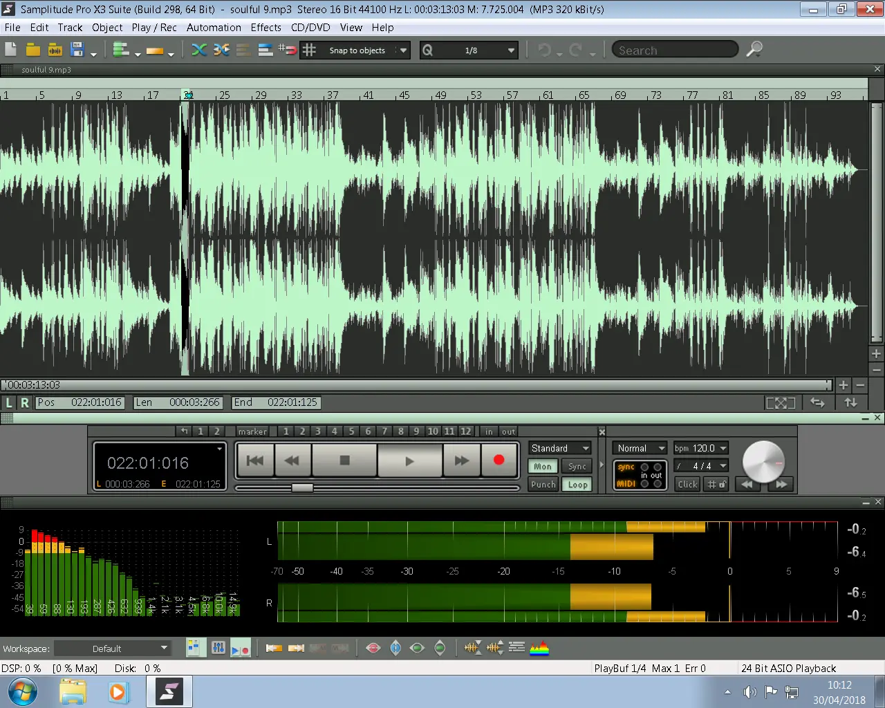

There are too loud low frequencies, down to 15Hz! You have to look not only to the waveform in one cycle, but also the envelope! Listening by various systems is useful because you can know if your recording will sound good everywhere or, like in this case, someone will hear a not good sound.
You have to cut the low end and lower its level, because it is covering everything else. You could cut at 40Hz and lower about 8dB under 200Hz.
You can see that the LF end is dominating everything.

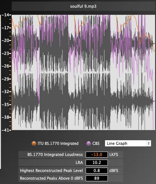

My Tannoys were fine at 90dBC SPL + measured at my seat approx. 1mtr from each speaker. 'Twern't nice mind.
I actually didn't catch the absolute peak which hit 0dBFS!
