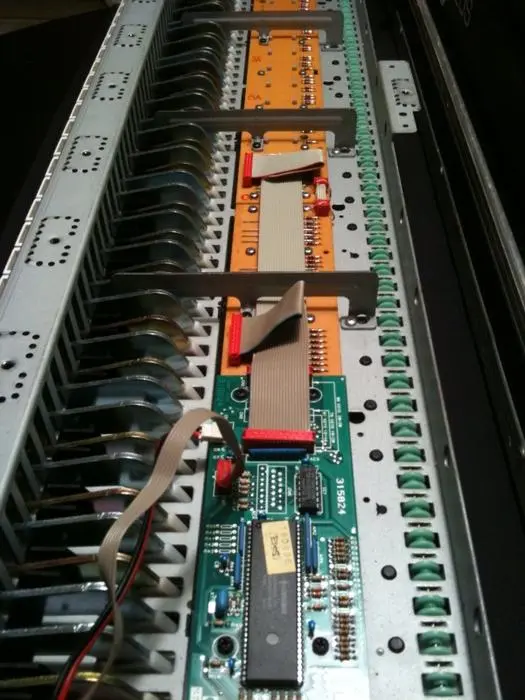

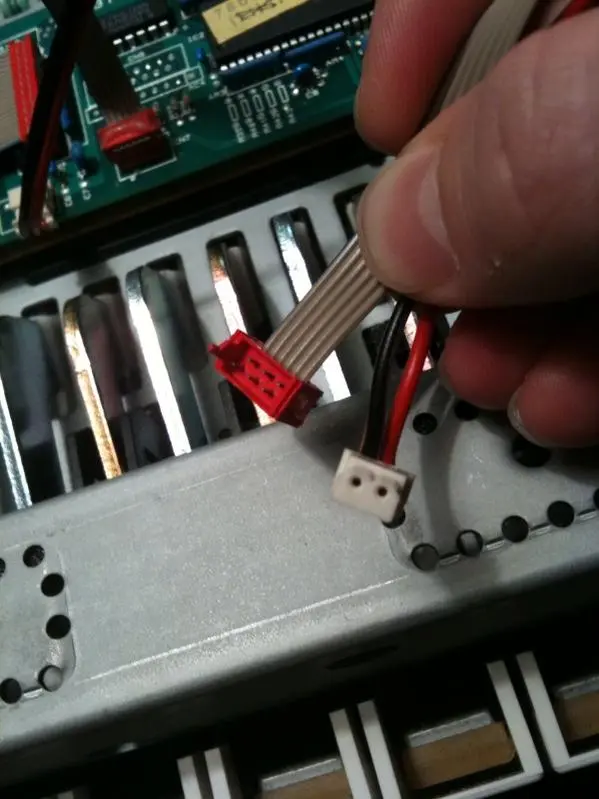

I recently bought a used Fatar Studio 90 Plus Midi Keyboard. (88 weight keys, built into a road case.)
I was really working on a super thin budget, and was able to buy this cheap, under a $100! I was really excited about the fact that it was built into it's own road case.
The keybed it currently has installed is a model: Fatar tp/10, and I've definitely experienced the broken/cracked plastic hammers as well as worn out felt causing squeaking sounds when notes/keys are played (for me it's every single key!)
After buying it I completely disassembled it, cleaned it to the best of my ability, and removed some cracked plastic pieces that must of broke when UPS shipped it to me, and then put it all back together. And everything worked like it should.
At the time, I didn't realize I could do the petroleum Jelly trick to help the squeaking, but even that wouldn't fix the overall feel. Now, I'm not saying it's horrible. But I would like something a little better.
Recently I came across a used bare keybed (Fatar TP/40), also for under $100 on ebay. The seller said it was pulled from some other digital piano.
Like the Fatar TP/10, also has 88 weighted keys, but with much better action/feel due to the improved hammer system.
So I bought it. And I was hoping that some way, some how, I could switch out the TP/40 for the old TP/10.
Worst Case scenario:
I cant replace the keybed, I do the jelly trick and deal with the TP/10 bed and then try to get my money back for the Tp/40 on ebay or craigslist.
That I can live with. But I thought, with the two beds being from the same company, the dimensions and builds being similiar, I thought it was worth a shot at trying this project.
Unfortunately though, I cannot just simply unplug the old keybed (Fatar TP/10) and replace it with the new one (Fatar TP/40), due to two different types of connections. I believe this Tp/40 came with some electronics still on it that were made for the digital piano it came out of.
I bought it with hopes that there might be a very small chance that it would work out that way.
So can any you help me? And If not, do you know of any tech/company/forum, etc who could? PLEASE! I would be truly grateful!!

and I've also attached a couple of pictures of the TP/40 bed showing the types of connections and electronics it has on the bottom of it.

Clarify
So let me see if I understand you correctly. You're looking for help on how to electronically connect the 2nd keybed into the road case of the first, right?
And the connector plugs are not the same on these 2 keyboards.
If I am reading you correctly, you need to locate a musician's electronics repair store in your city (where do you live?), so ask all the right questions on the phone to make sure they work on keyboards and can do the job you require.
If one of the keyboards also has MIDI pressure or release velocity in it, and the other does not, that could account for the different plug, though theoretically you should still be able to do what you want.
Let's say the 2nd keyboard did in fact send Pressure info., and or release velocity info., then that keyboard's wiring harness might have additional wires on it for that reason. Nevertheless, theoretically, you should still be able to make it work, i.e. those wires would just not get utilized in the 1st keyboard (the Fatar 90).
Then again, maybe the additional parameters of Pressure and Release Velocity, all run on the same basic MIDI wire and additional wires would have nothing to do with those parameters. ??? I don't know.
Next, whether or not you could splice the Fatar 90's plugs onto this other keyboard's wires, is something you need to speak to a keyboard electronics expert on. Theoretically, it would seem as though something like that could be done, since both keyboards are made by Fatar, and you're dealing with the standard protocol of MIDI.
Lining up the correct color and numbered wires into the plug of the Fatar 90, is not really something that is difficult to do, but the question is is this something that can actually be done?
Ask "dementedchord" on here, as I believe he is a retired keyboard technician. He should be able to give you a knowledgeable answer.
gthis is doable several ways maybe... but before i say for sure ya gotta get me somemore pix of the wiring harnesses for both boards... that is to say the bottoms of both key decks... i suspect that you could simply plug it in with some lite work for the wirring... worst case?? take the keybed pcbs and switch them to the new keydeck using which ever key contacts that appear to be best condition... if you're not up to that then move the trashed keys on the original to the extreme ends and play the middle... @75% of piano repertoir can be done on 61 keys... 90% on 76... thats why those were picked as the typical keybeds... the electronics your showing btw is the key scanner... later bob
PC Board modifications too...
Another problem you may run into if you try to swap the new PC board for the old, its NOT just a simple question of rearranging the wires on the plug headers. Keyboards, like any other set of multiple keys input devices (like computer keyboards) are usually arranged in an XY "matrix" such that when you press a particular key, it connects 2 or more points together. Here's a very very simplistic explanation: There are several of these points, as many as there are keys in fact. Then those points are routed to the conenctor and ribbon cable that goes to the main board. An example: you strike the key of C4. This connects the 1-st and 8-th wires of the ribbon cable together. You strike an A#2 key, this connects the 3-rd and 9-th wires together, and so forth.
You may have to do some rewiring of the pc board itself to get the same combination of the key matrix as the old board. In fact, the rewiring may be so extensive that its not worth it. here's an ASCII illustration of what I mean by key matrixes:
