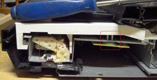

In Review: One key, C5, of all keys, on my Ensoniq ZR-76 (circa 1998) with Fatar weighted keys was sticky when initially pressed. It did not feel sticky all the way down, just at the onset of touch. Also it did not feel too bad in the minutes after the initial touch; however 10 minutes after sitting idle it would again be sticky.
I took off the side panel of the board--see the picture below. In the area circled in red on the left you'll see the weight and the rubber strip on which the weight rests when not being played. Apparently the liquid that spilled into the board caused the sticky feeling. The liquid also fouled up two octaves of the contact strips--see the circled area on the right. I previously described the successful replacement of the strips.
I cut a long thin piece of hardwood approximately 1/2" wide--fortunately my pop is a cabinet maker. I glued a piece of an old washcloth onto the end of it. I moistened the cloth with water and later with Fantastic cleaner and cleaned the rubber strip below the problematic C5 key.
Frankly this probably only made the problem worse. One of the adjacent keys started to become sticky as well.
As a last resort before having to take the keys apart I put a small amount of plain body powder on the strip of cloth--it was completely dry--and used my stick to deliver the powder to the affected area of the sticky rubber strip. Immediately I felt an improvement. I repeated this several times over several hours. The keys feel great!
The next morning they continued to feel great. Of course I don't know for how long this will continue to work but I suspect it will never be as sticky as it was before I applied the powder. No, my hardwood stick is not for sale ;)

Cool, and pretty interesting story. It looks like powder residue there on the keyboard. heheh
You seem to be one tenacious individual to go through all that. You must really love your Ensoniq.
Thanks for posting the pic!
You can see a bit of powder on the far left side of the pic; however the stains to the right of the weight are probably from the dried up liquid that spilled into the keyboard.
I only used a small amount of powder and rubbed it onto the rubber strip. That is why I had to do it several times to resolve the problem. Also my strip of wood was only slightly wider than the rubber strip. I was trying to avoid leaving significant amounts of powder residue.
