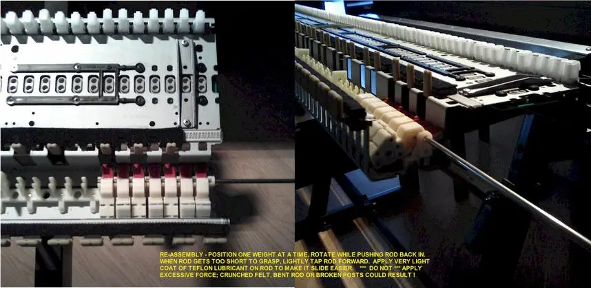

Now that the weights are fixed its time to put it all back together again. Wait ! before doing that, take this opportunity to look around and do any other maintenance work that needs to be done. Its not often that the keybed is completely apart so check the felts, the key posts, the towers, aftertouch ribbons etc... You might also want to take the contacts PC board apart and clean those out also - go back to page 1 of this thread, Toddskins has it all laid out for you !
Putting back the rod that holds the keyweights in place can be a bit tricky, you need to work slowly and very carefully. Also, you may need to file or grind (to a slightly conical shape) the inserting end a bit; the rods I had were blunt and had a burr so it would have been very difficult to put them back in smoothly.
Position one weight at a time, rotate while pushing rod back in. When rod gets too short to grasp, lightly tap rod forward. Apply a very light coat of teflon lubricant on the rod to make it slide more easily. *** DO NOT *** apply excessive force - crunched felt, bent rod or broken tower posts could result ! Take your time.

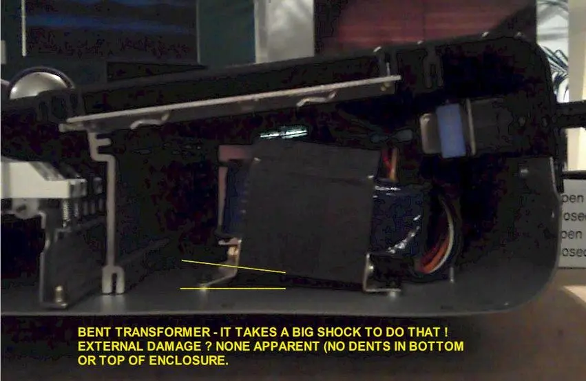

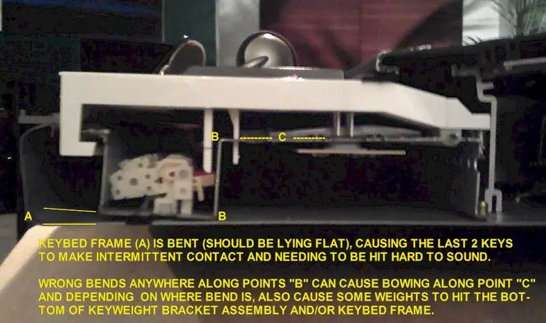

Upon initial testing everything went well, almost. I originally had the highest B and C (B7, C8) that were intermittent. When I took the PC Board apart, everything looked fine and the board was a 2001 issue, it had already been replaced once because the other board is the original 1997 issue.

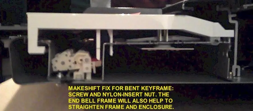

On testing, those two notes were still intermittent and had to be hit real hard to work. Since the side bell / panel was off, I started looking at the way the key was plunging on the rubber contact. Everything was fine ! It was then that I noticed that the front of the keybed wasn't laying completely flat ! So it seemed that it was bent or slightly twisted after all. Now how could that have happened ? The exterior enclosure is in pristine condition, not a single scratch or dent, anywhere ! Then I noticed something else: the power transformer brackets were very crooked on one side. So the only thing I can come up with is that this K2500 was shaken or hit very hard somewhere, at some point in its lifetime and thus, the keybed got twisted. And that my friends, was the most likely source of 80 % of the keyweights being too low and hitting the assembly and frame. That also solves an initial question I had in post # 93: "why is the weightline sloping toward the right ?" - because the frame is bent on the right side, that's why! The worn felt accounted for only a small porrtion of the problem.
To test that the frame was indeed causing a problem with the B7 C8 keys, I vise-gripped the keybed to the bottom of the enclosure and then tried out the keys. Eureka, they work ! The only way I could think of fixing this quickly was to drill a hole toward the front of the keybed frame and bolt the two parts together. It works ! There already is a screw that holds the keyframe to the enclosure but it seems it is just too far away from the edge & the end to straighten the keyframe properly. If you do notice a bent frame in your Kurz, whatever you do, don't try to straighten the frame by hand and don't just drive screws anywhere. It may look like a simple stamped metal beam but it is a precision part not to be fiddled with. Trying to unbend it will likely cause all sorts of other alignment problems afterwards.
So there you have it.

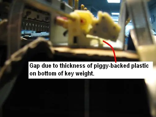

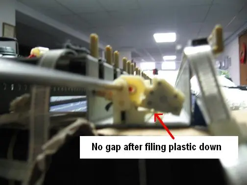

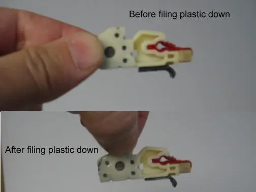

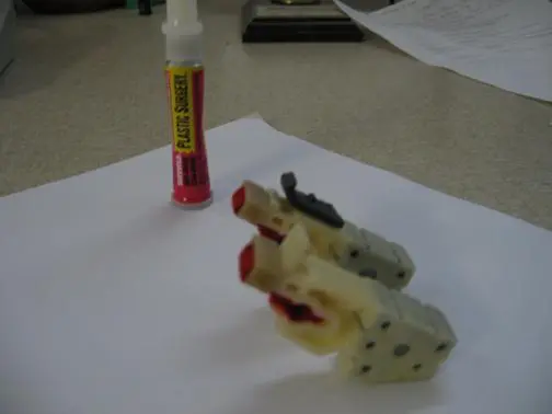

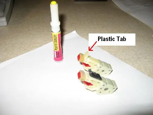

Ok, so I took it all apart again to fix 3 key weights that I knew for certain were giving me issue, and to do maintenance on all the weights, based on JaydeeMtl's (John) recommendations.
The good news was that I did not have any broken weights. Instead I had 3 of those plastic casings holding the weights, with broken tabs [see picture].
I found the tabs for 2 of the casings, but not for the 3rd. These missing tabs from the casing caused my notes to feel like there was an echo in the key when playing. I would strike the note (C4, G4, or D5) and there would be an after effect. Now I see that the weights sitting on the pole are able to pivot, and when notes are struck hard, the tab acts like both a shock absorber and a brake. Without it, the weight will bounce a little more. This is what I was feeling.
The glue called Plastic Surgery is pretty amazing. I spent a couple hours trying to think up a solution to glue a piece of plastic from around the house as a pseudo tab. What I found was an old belt clip for a device (not unlike a cell phone clip for you belt). The plastic is very hard and durable. I contemplated junk like plastic cassette tape holders, etc., but they are too weak, and shatter too easily. The piece of plastic I used came from a bend, thus providing me extra strength - essentially, a 90 degree, right angle turn, so that when I glued the one layer against the casing, it had a lot of support [see photos].
Turns out that the plastic I added, piggy-backed onto the casing, was too thick and caused a gap inside the key bed, so I had to file it down using a metal file, which did the trick.
I added glue all over the 88 key weights, as John had shown. Small fractures, and areas that looked like adding glue might add strength, and especially all around the Tabs. I play hard, and those tabs must take a lot of abuse. Adding more glue around them, should strengthen the joints, on all sides.
Regarding Plastic Surgery glue: I filed that added piece of plastic down after it had been glued down and it would not budge. I pushed the file against it as hard as I could, back and forth for 20 minutes, and it remained solid. Likewise, the 2 tabs that I had found, glued on tight against the casing, and are very strong.
You were right John, about filing down the ends of the poles into conical shapes. Threading the weights with the poles seems like the most difficult part of this whole thing, as the red felt inside the weights do get stuck and pushed. It's not until the end, when you seemed to have figured out the trick of it all to make it go easier, but by then you're already done.
One last point regarding Plastic Surgery Glue: There is very little glue in that container. I used 3 of them. Don't let the size of the glue container fool you, as there is only about a teaspoon of glue in the whole thing. But the glue is freaking amazing. It's kind of like liquid plastic, and it begins to harden in a few seconds, then a few minutes, and very hard after an hour. BE CAREFUL NOT TO GET THIS GLUE ON YOUR SKIN! It got on my fingers, and it's not fun at all trying to get it off.
I'll post once more tomorrow, after I put everything back together, and see how it plays. This is a 3-day process, and the more you look over the weights, you see more areas of possible fractures that should get more glue.
