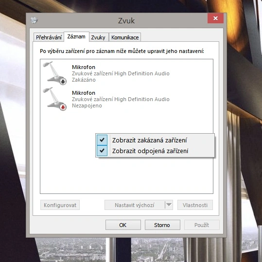

I need to record news sessions and reports from on-line radios and stations but my sound card does not support direct sound recording. I use Samplitude on HP notebook with Windows 8.1 and integrated Realtek card. I know I could use better things but last notebook with Realtek card worked well for this purpose so I was not expecting such problems.

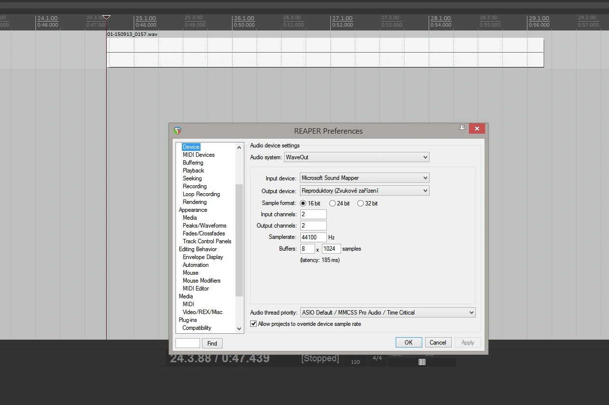

I was not able to fix it trying Adobe Audition, Reaper, installing Asio4All and some software utilities creating another input or plenty of other hopeless things as other drivers... I though that maybe someone would know a better way? I would truly appreciate all advices.
If the software solution would not be possible maybe there could be some other hardware workaround? I could invest up to circa 100$ to an external sound card if it would be able to record without such noise as coming from these integrated Realtek cards. I am using HP Pavilion 15-p008ng. I am in Europe-Czech republic so my choice might not be so great as in US.

Reaper just record silence - I can only record using pc microphone, which makes the spoken word quite unrecognizable... I cannot go to windows 7, because of multiple driver conflicts with this HP notebook. Anyway thank you very much for your effort! Clipboard02.webp

That is the problem actually. There is no stereo mix. I tried to fix it with some programs as VB Cable but not successfully.
This notebook does not have even classical 3.5mm mic jack so I cannot link output and input which might be a solution as well. It is no problem, I can wait a few days of course. I think there is a solution, so thank you very much for your help so far! I will to turn off the pc for now, it is 3am there ;-)

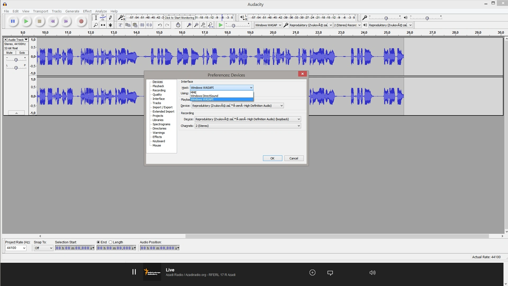

After some searching: Recording is possible through Audacity changing recording option in settings to Windows Wasapi recording. Also some external sound cards allow Stereo mix...

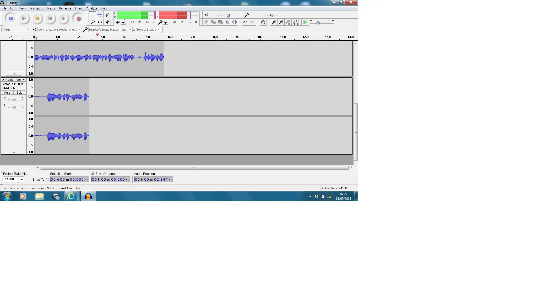

Meantime, see the attachments/. I rarely use Audacity now so it took me some time to realize that the meters only work in actual record mode? Cannot find a record "arm".
In case the shot is unreadable* the driver is MME, the output Communication Headphones and the input Msoft Sound Mapper. Of course you may not have these!

I think the problem is solved for me. I will use Audacity instead of Samplitude. I just need to select the Windows WASAPI.
