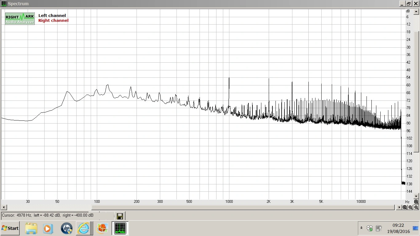

Yes that is the classic USB mixer 1kHz and all the harmonics whine!
You cannot prevent it but you should be able to push it down into the noise floor.
Windows Sounds menu will allow you to set the recording level, my bet it is at 100%. Set for 5% or even less.
You have probably already have been told that a decent $100 audio interface will be better and free of this crap?
BTW. I cannot now attach .png files. I am certain HR allowed this up to a few days ago? Right Mark analyser defaults to save as .png and I have posted shedloads of spectra in the past.
I had to ScrnPrnt this one then save it in Paint as .jpg!
If your mixer has a 'USB volume' control (my Mackie does), you can turn that down and at a certain level the whine will disappear. NO USB control, then all you can do is turn your Windows input down as Dave suggests.
