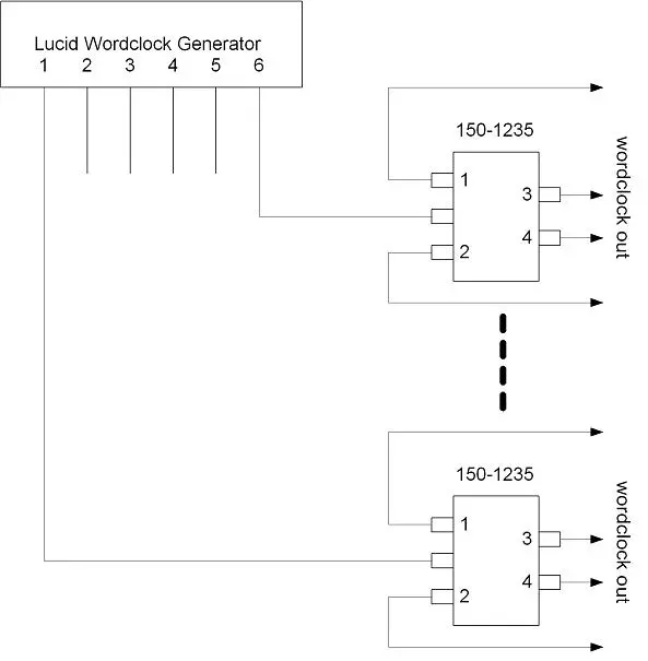

For those into digital mixers, synths, recorders etc, you've probably discovered there really isn't an obvious way to hook everything together easily, without spending a bundle on something like an Lucid Wordclock Generator followed by a 1-in, 6-out Lucid splitter.
Of course, what do you do if you have more than six devices that require wordclock in? Like me, I have 7 tascam mixers, 6 akai recorders, and four synths that want wordclock. That's 17 - ack!
Well, here is a neat trick I just tested out. Wordclock is 75 ohm, cable TV is 75 ohm.
Hmmmm.
So, I buy myself a Radio Shack "Gold Series" 150-1235 Coax Splitter/Combiner, 1 in and 4 out, and attach the input to one of the six outputs of the Lucid that I have. I took a piece of Coax TV cable and cut off one of the F connectors, and crimped on a BNC. You can also buy adapters if you like spending money. Then, I ran four RCA-RCA cables from the splitter to four tascam mixers which have RCA wordclock in and out. Fired them up - wow, they all saw wordclock.
Neato!
Then I added another coax TV splitter to the second wordclock out on the Lucid, and attached the splitter (same method) to the two remaining small tascam mixers, the TMD-4000, and one of my akai recorders. They too saw wordclock.
Neato!
I then attached the remaining splitters I have to the other Lucid outputs, giving me a total of 24 wordclock outs out of the Lucid.
If you don't have a six output Lucid wordclock, you could just as easily use an aardvark wordclock generator, or one of your digital mixers, recorders, whatever, as long as the wordclock output is stable. Use cable TV splitters and have at it - its fairly cheap and one less wall-wart to stick in your power strip.
Off to rat-shack for some more coax :) Catch ya in a bit...

Well, forget theory, I have everything wired for wordclock minus the Triton and everything seems happy. The local rat-shack didn't have enough of the splitters I bought, so I ended up with four of first style, and one labeled "Satelite Dish Splitter", which doesn't work at all. Obviously, has high/mid pass filter, leaving lower frequencies out. The cheapo ones I bought initially, don't seem to have that "feature".

Hmmm. The 4 ways have about 7.5 to 8 dB of loss per leg but if you have at least 1 V p-p, it should work. Have you thought about using BNC Ts and daisey chaining maybe 4 devices per output of the GenX?

Yes, I have. This works for the TMD4000 and the Akai recorders, as they have switches to disable the built-in terminators. The other equipment, alas, does not, so daisy chaining (which I tried) results in the signal going only so far... then dying. I tried :)

Scoped it out using a 2 channel scope comparing the original signal to the output, and the output signal is a little more rounded than what goes in, but not by much. 1.5V going in square wave from the lucid, and about a volt coming out with a little bit of noise on it. Not sure if that's my scope, or the splitter. I'll get the real scope up here tomororow.
