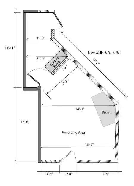

OK everybody, we have a better idea of what is going to happen. We are going to build a room in a prexisting classroom. We have made some preliminary plans. Now I have lots of questions. This room needs to be really soundproofed because there are classrooms bordering the studio. We need to make it very soundproof so we can try to record during school hours. If this is not possible without spending tons of money then I guess we will just record after school. We don't really have a budget yet. I am supposed to get some estimates and then make a preposal. I guess we will also need some sound dampining stuff too. Maybe you guys should tell me what I need to worry about because I don't know too much about this stuff. Thanks a lot!!!
I am going to try to upload a picture in a few minutes
I am going to try to post a picture of our plans so far.

The recording room is fine. The control room is a bit of a disaster--too small, not symmetrical, mix position in a corner. Lemme see if I can draw something else--I think you'll have to borrow some live room space.
OK, if you need two rooms (and it's probably helpful in an educational setting), here's a start. Replace the hinged door between the rooms with a sliding glass door (for more isolation, double that wall & use two doors). Mount the monitors inside the walls. You're limited to a small desk in the control room, and you'll have to have all the rack gear built into the desk (which is nice to have anyway). You'll need lots of absorption in the control room.
Thanks a lot for drawing that out. I will bring that up with the people we are working on the building. Any links to places where I can find prices for this stuff. What should the walls be made out of? I have lots of questions!! :) Around how much is this all going to cost. (just the room itself, not th recording gear.)

You bring up some good points Rick. We want to make intial plans to present to the school board though. Also it is a lot cheaper (so I am told) to come with some initial plans and show them to architect than have one design it for us. We are also going to see if we can find any parents from the school that are architects that would like to help us out. I really do appreciate you pointing out possible problems though, so we can try to deal with them now instead of later. OK here is a new drawing. We had to bring the wall back a little because it goes straigt up to a hallway and has glass walls. Tell me what you think of it. Also the room has a very tall ceiling and we don't really want to build all the way up. We were talking about going 8 feet up. Any suggestions with this?
Still not working? I am not sure what is going on. Do you think it is because it is a bmp file? It was working last time I posted a picture. hmmm.... Let me host it on the internet and see if I can get it to work later. Ok here is the link: http://tinypic.com/2akmpz
Anybody have opinions on the newest picture? Sorry I can't get it to load in the post. I am not sure what the problem is.
