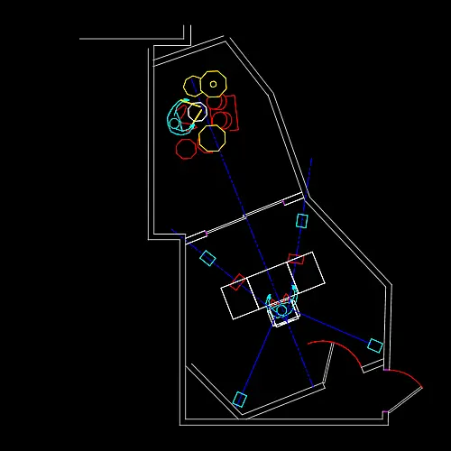

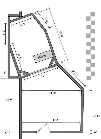

OK we changed it once again just a little. Hopefully this time it will actually get posted in the thread.
The last one definitely is an improvement in the room size/shape. If you do mix at the location indicated, though, your stereo image will be off balance since it is not centered in that part of the width of the room. It looks to me like you are planning on sliding glass doors between the 2 rooms, correct? If so, it might be better to put the mixing location at the opposite end of the room. This will allow you to be centered without impeding traffic flow in/out of the room.
Looks like a fun project.
Darryl.....
yes we are planning on putting a sliding glass door in there. I will consider moving the mixing desk. Thank you for your reply. Anybody else have some suggestions?
Just been looking at the pics and feel that the width of the control room will be a little tight but ok as long as you don't intend to have a lot of student in there all at the same time.
The other thing I can see is that access to the live area could be a problem.
Will you be using the bottom door for access or the sliding door?
If you have to bring amps and drum kits in and out of the control room to get to the live room it could a problem.

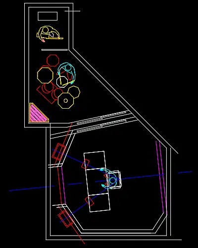

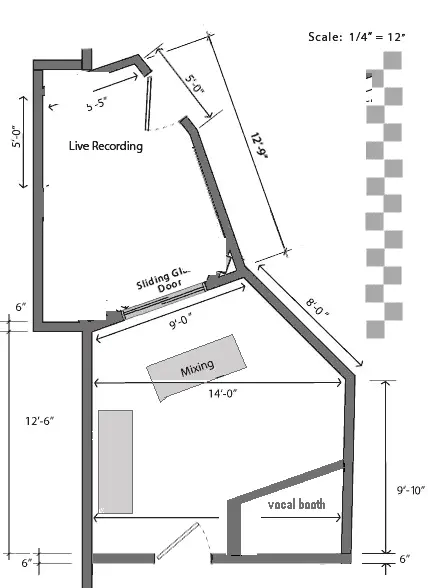

Well, now your getting somewhere. I was going to suggest this 2 days ago, but got tied up on other HR things. :D But here is what I drew. 2 different layouts, but both using the big room as the control room. You DO need more room there.
Here is the first.....just like yours!! :eek:
fitZ
Here is the second one.

Two things real quick. These are by NO MEANS a set of plans. Just a general idea of what I think should be done with the space. Many things could alter this in a heartbeat. One thing I left out was a set of double doors to the booths. You need this to load equipment in and out, plus it is a safety factor.
Second, think flexibility. In this small of space, it is the MOST important issue of all.
Well, for the moment thats all I can offer you till you decide exactly what CAN be done, via official approval of a PRELIMINARY plan. Then it should be taken to a design professional for articulation and code analysis. Hope this helps a little. You have a LONG way to go on this, so don't rush it. You need every square inch of space, and you have many things that will eat it up. Have you decided on any equipment yet. This will determine fixturing too. Anyway, good luck with the preliminarys and keep us up to date. We'll be here. :)
fitZ
In the debate of control room vs. live room I think your program needs to address some important issues regarding the focus of the coursework. Simply put, there isn't enough room for both, so you will have to favor one over the other. If the classroom focus is on mixing, then I've choose a larger control room. If it's tracking, then a larger live room. If the live room has to be multipurpose, such as band rehearsal space, that also means a larger live room. On the other hand, if you have to cram 10 kids into the control room to demonstrate to a class the effects of mic selection and positioning, then you'd just need a small recording booth and a giant control room.
Lots to think about.
