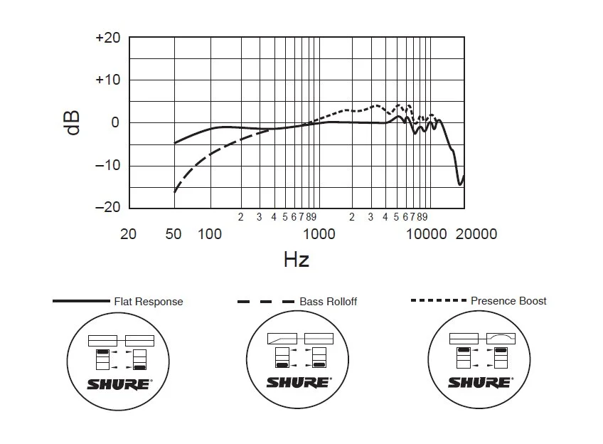

If you haven't already, try the switch positions on the back side of the SM7b also. They may give you a bit different sound that is more to your liking.
