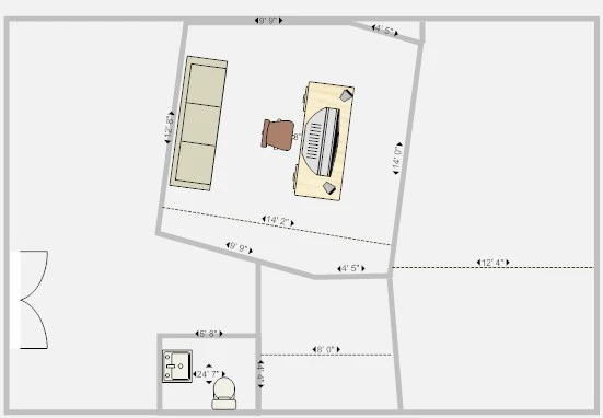

I have had my entire back yard "re-did"....actually had a dozer come in and grade my yard to accomodate a 24 X 36 Concrete block building....I poured the footing 16 inches wide and 10 inches deep and have run one course of blocks. This course will act as the framing for the concrete floor. I hope to have the floor poured tomorrow if the rain isnt too bad tonight. Im planning on at least an 8 ft ceiling...I know the higher the better....Ill just see how many more courses I can afford after we hit 8 ft...even one more will make a big differance. Im planning on one enterance....a 6ft double door. I will have a 1/2 bath, a control room, live room and booth....I will attach my floor plans and if you guys have any recommendations, please have at it... The dotted lines are not walls...just added to show deminsions....also, the area at on the left is just storage area....this was not originally the plan but had to save some room for storage to apease the spousal unit....

Do yourself a favor and design the CR long ways. Or make the back wall very dead. The clients on that couch are going to be feeling a lot of bass and boom standing waves if you've got it right up against the back wall.
Atleast you've got the desk near the middle of the room...Thats a good start. Try to get that couch off the back wall and equivalent to the distance the desk is from the wall (you'll have to put the desk closer to the wall)...but take my word for it that will be an ugly place to hear things from on the couch.
Take room modes and the golden ratio into consideration, although angled walls do spread out modes. Make your ceilings as dead as possible all around. Lots of absorption in the corners. You'll be fine

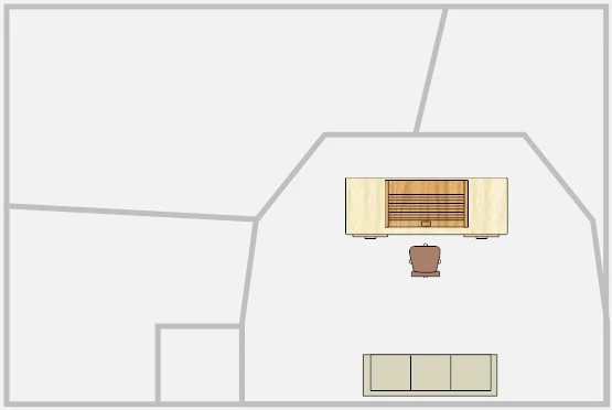

the pad is poured now and im considering several other sets of floor plans....the bathroom will have to stay put since the plumming is all in but everything else is fair game...between the 2....what ya'll thinkin???

That one looks great

well...My first picture was my original plan....and at this point, it still is the plan....Im just having the building dried in....walls and roof....and Im going to work on the insides as I can.....Im sure there are plenty of ways to set up the inside with the bathroom set where it is.....what are your Ideas Rick???

You mention bathroom, control room, live room and iso-booth...but what are the other smaller spaces for?
If it was me...I would focus on two main rooms (basically)....and then and then add the iso-booth in the live room where it feels right, depending on how big you want it (and how much live room space you want to chew up).
Here's a rough idea...you can adjust the dimensions according to whatever works best acoustically...but man, since you are building this from the ground up, IMO...an 8' ceiling would totally SUCK! Go for at least a 12' ceiling height...you will be glad you did…maybe even some sort of vaulted ceiling rather than flat.
Not sure why you need 6’ double doors? I would just get single extra wide doors.
The foyer would double as a coat room and extra insulator from the outside and your control room so people don’t just walk right into the control room.
You can then treat the spaces as needed...like angling off the corners or whatever...but I’m not sure you need all those very “odd shaped angular rooms” like you had in your layouts.
I understand that acoustics are important...but so is working space, ergonomics and overall comfort and vibe. ;)
