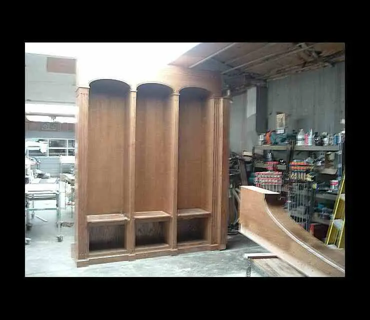

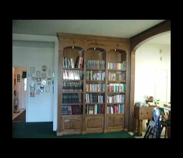

Hi technominds. Well, you can build things like this out of many types of materials. Its what you want it to look like and your skills to use them that determines that. Except for structural spans. But QUALITY is in the hands of the craftsman. I can build things out of MDF that you would swear is solid wood. Like this. :) 80% is MDF. ;)
