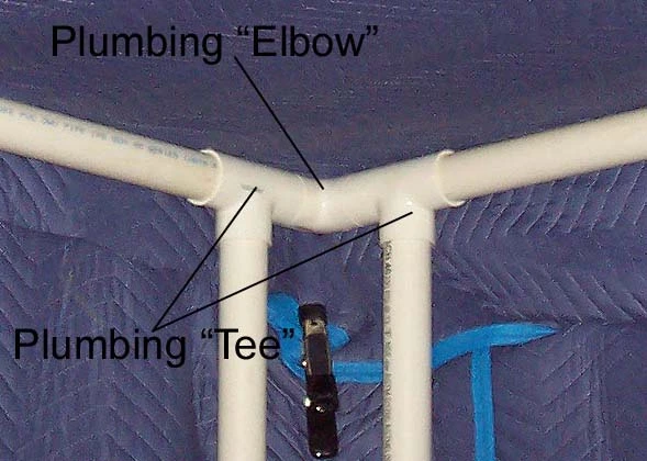

So, even though I have looked at the pictures above, my burning question is, did you use a corner fitting (that goes in 3 dimensions) for the corners of the vocal booth, or something else?

pretty much any PVC plumbing pipe will work, as long as it is tough and doesnt bend easily... I used a corner fitting, yes, but i had to use adapters to connect one side of it to the pipes... the corners were 1"x1"x1/2"... that really surprises me that you cant get them... if you like, I could try sending you some as I still have more than enough for another booth... I probably cant send you pipes, as they are too long, but I can send you connectors, PVC pipe glue and vicegrips to hang your blankets if thats how you intend on doing it... just PM me if you like..

I think you have all the parts you'll need... The "corner connector" is a difficult item to find here in the US... BUT you can make one that will work just fine using 2 "flat T-connectors" you spoke about and a simple "90 degree elbow connector"... I'd think you could find these very easily in the UK... I'm attaching a picture of how you can do it, I know it works, this is a picture of the one I built! :)
This picture is taken from the inside of my booth...
Thanks Zetajazz44, why didn't I think of that design! I went to the store again today, and found the metal pipes and connectors that Zaphod B mentioned. They are about the same price as the pvc ones! :)

Yes, I used a 4-way for the roof...
About the structure being wobbly: Mine is pretty sturdy...I have a bad habit of over-engineering stuff I build... Mine is built out of 2 1/2" PVC... Have you ever tried to break a piece of PVC? It's not easy... Don't be stingy with the amount of PVC you use and it won't be non-sturdy... The weight of the moving blankets will be compressing the structure from top to bottom, there is very little strain side-to-side... If you look at the pictures I posted really closely, you can see how I did the sides... Not only does it tie corner upright pieces of the structure together, it makes a dandy place to had headphones..etc... I didn't glue any of the joints, they fit really snug anyways... As a matter of fact, I sanded the ends of the pipe where they go into the fitting so they'd be easier to assemble/disassemble... You'll see what I'm talking about when you get into building one...
I also had planned on drilling through both pieces of the pipe at their joints and putting a pin through it to hold it together, but once it was assembled, there was not much need for it... The weight of the blankets pretty much hold the thing together...
PVC will be much easier to cut and fit like you want it... I think I'd go that route over the metal piping...
