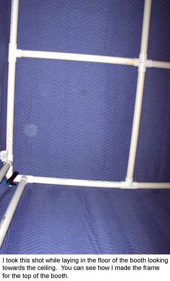

I did exactly what you're talking about... Build a frame from PVC... I used the heaviest moving blankets I could find, I bought them at a moving blanket factory close Atlanta, GA...can't remember the name of it right now... The moving blankets I bought look very similar to the ones on the Markertek site. The place I bought mine at required me to buy a 'bundle' of the blankets as a minimum order... I believe there were 20 blankets in a bundle and I got them for around $100 USD.

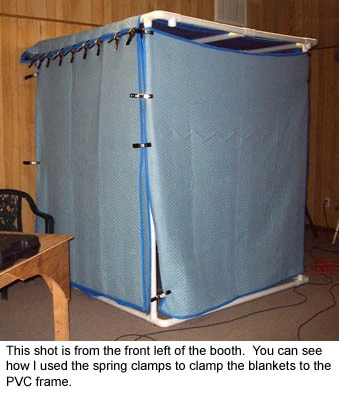

I use spring clamps that I bought at The Home-Depot to hold the blankets to the PVC. I configured my PVC so that the weight of the blankets (they're not light) would hold the PVC structure tightly together. Since I had so many blankets, I doubled up on all of the sides of the PVC frame...

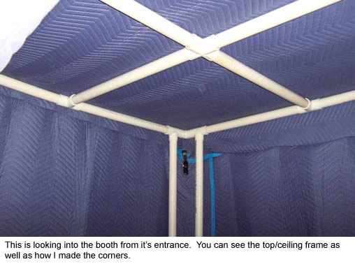

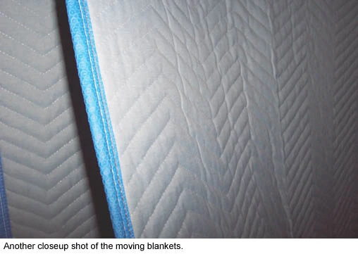

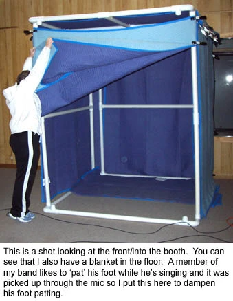

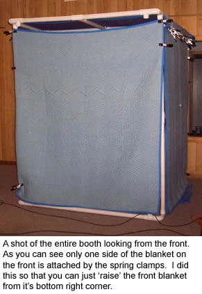

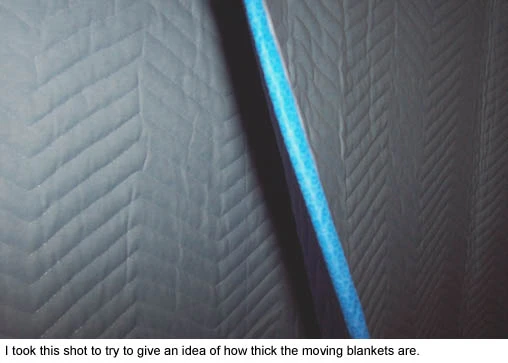

As promised, I went to the studio (currently being dismantled) and took these pics. I tried to put captions on them to better explain.
The booth may be a bit over-engineered, as I've been acused of, but I hate things that are flimsy so I made it very sturdy... I believe I ended up with about $160.00 total in it with the spring clamps and PVC... Took me about 2-3 hours to build.

I can't remember the dimensions of my booth... I should have measured it... I have to take it apart in a few days and I plan on measuring it and putting together a set of plans and upload them here or on my site for people to download if they'd like.
The reason I made mine as wide as I did, was that I record acoustic guitar it it as well... When a person sits in a chair, with guitar and a mic stand or two, it gets crowded really quickly. I wanted to give the acoustic guitar player a little more room... I think mine came out being about 7' 4" tall and about 6' 4" square... I think my thoughts were to have it 6' X 6' X 7', but I didn't take into consideration the 2" PVC and that added the extra 4" to it's dimensions...

well, i finally finished the booth.. and i just wanted to thank zettajazz for his help with this... i think i have finally found the most cost efficient way to build a vocal booth... my booth is 4'x4'x7', and i did mine exactly the same way as zetta... built a frame using pvc pipes and hung 7lb each moving blankets all around the booth... they are held in place using strong clamps... the blankets work great for killing reflections on vocals, and they are even heavy enough to provide a little isolation (not much, but they do reduce the volume a lot)... my advice to anyone wanting a booth is to build this, however, i would try to figure a better way to hang the blankets.. also, make sure you get strong pipes, as the weight of the blankets tend to make the frame lean to one side and bend a VERY little.. also, make sure you find a way to let light into the booth, like a lamp for example, as i found it difficult to read my lyrics in the dark :)
overall, this booth cost me just over $100, and was worth every penny... ;)
