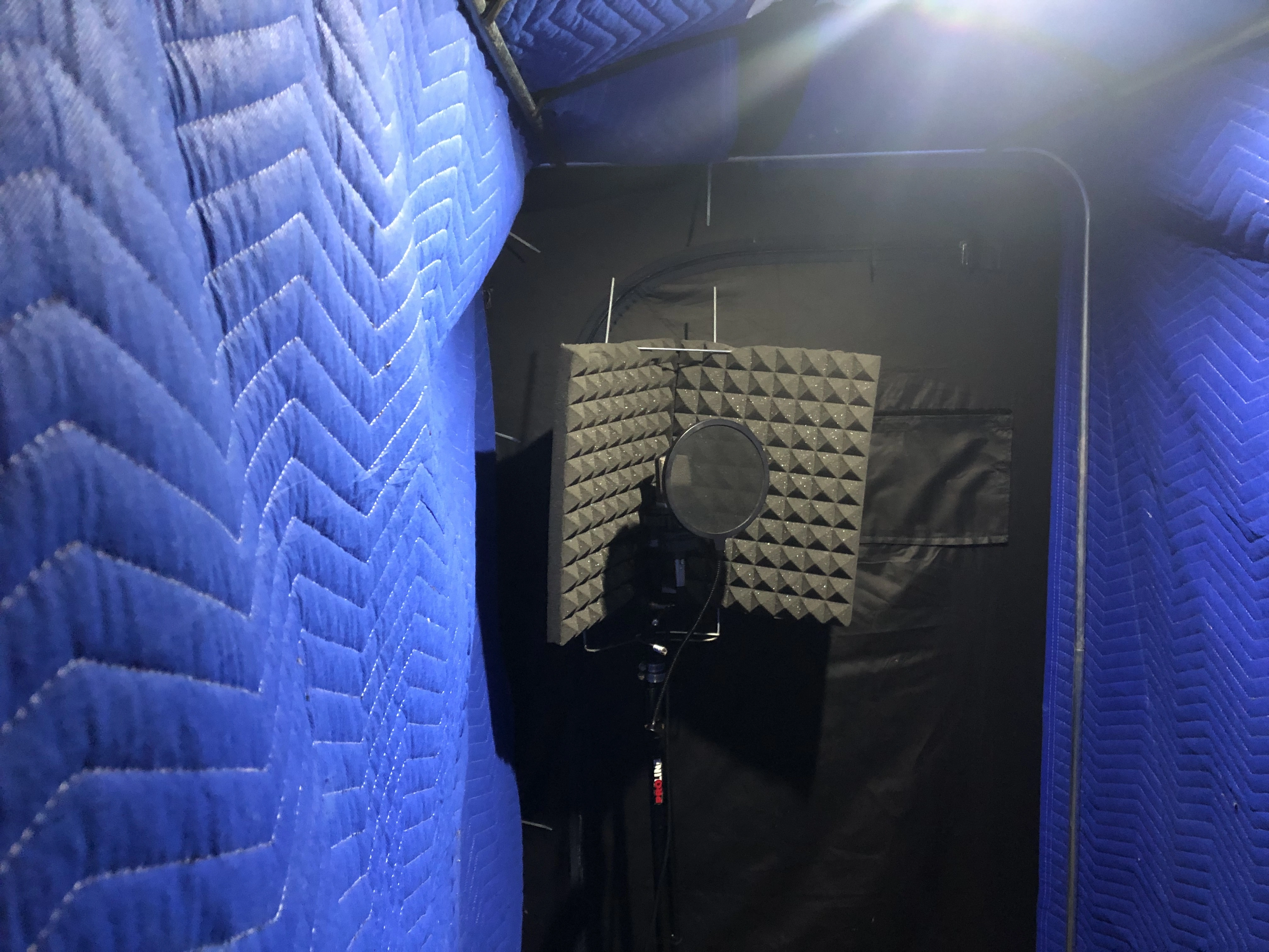

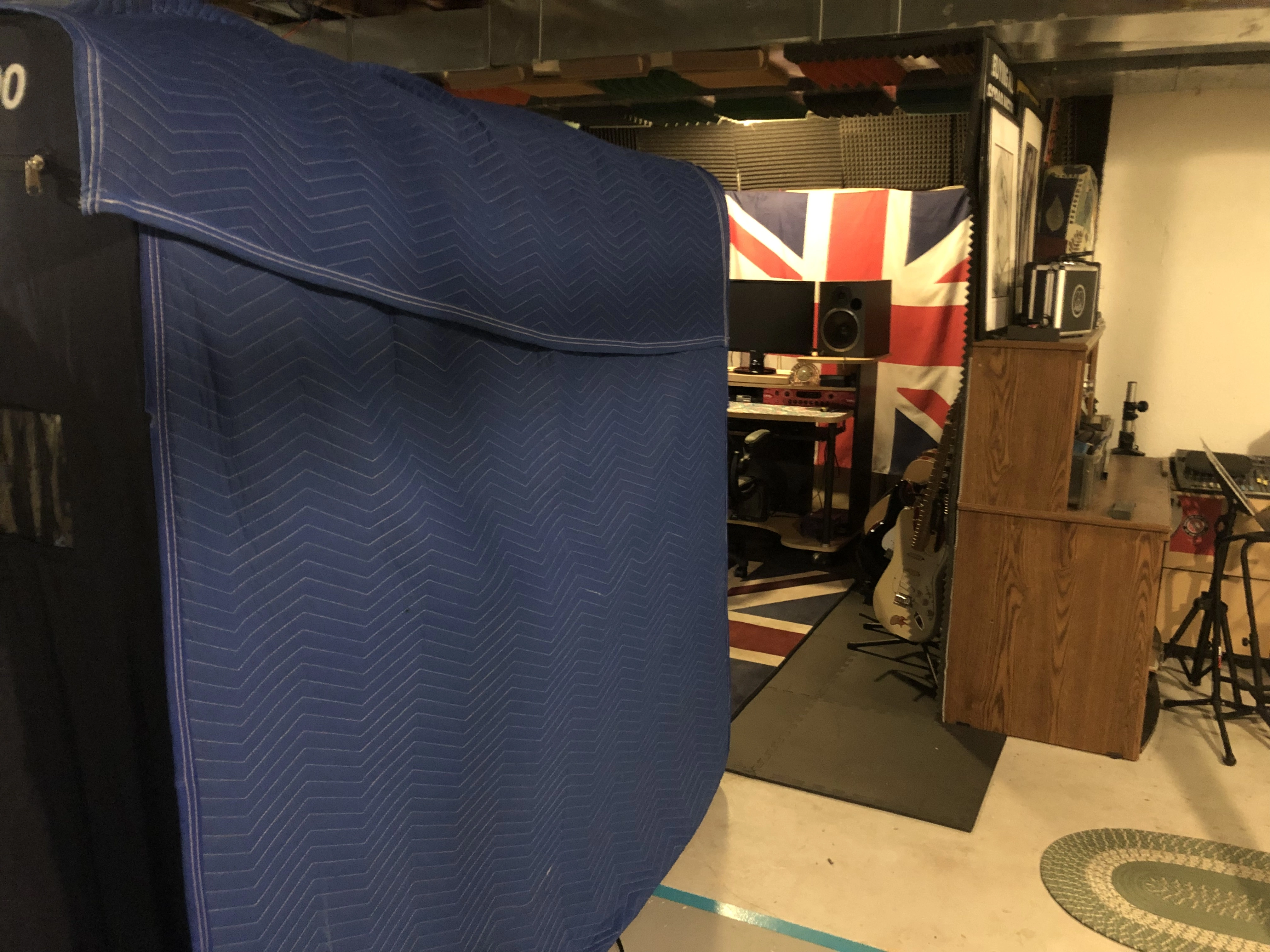

I completely changed the quality of my vocals by taking out the room, ready for it.................... get a used large as you can find portable fold up ice fishing shanty, got mine on craigslist for $80.00. drape the exterior with cheap shipping blankets, hang same type of blankets from the rods on the interior, place an old rug on the floor and boom! A completely storeable vocal booth anyone can use and then just fold up and store. All in I was at $130.00. I have completely changed how my vocals sound without a new mic, or any new outboard gear.

Taking bad room reflections out of recordings is always a good thing. When I tried various 'moving blanket' (only) solutions, my vocals always got very 'boxy', requiring lots of EQ.
Whatever works for you.
I have also found that taking a room to a smaller box only helps the ego of someone who doesn't want others to hear. It is usually not a good thing for the recording quality...
Open space is way better in my experience.

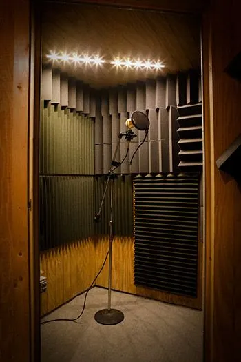

Hmmmm... Tom Petty, Linda Ronstadt, Stevie Nicks, Dave Grohl, Diana Ross, all recorded platinum selling albums in this Booth at Sound City...with the door closed. Guess all those albums sounded "boxy"....

I haven't seen the Sound City movie, so not sure where that image came from, but anyway that's not a 'vocal booth' made from hanging moving blankets. No doubt the walls have rockwool or dense fibreglass in them, besides all the various foams in the inside. The real sound that made Sound City what it was, was the main room, and the Neve console.

Any chance we could get a picture of the specific portable ice fishing shanty w/blankets?
Small isolation vocal booths can be useful ...especially in places where you are dealing with exterior noise. Your's is tidy , cheap and effective. I made a similar booth when I tracked my daughter several years ago. The vocal was clean and solid but it required work to make it sound right...IMO more than usual but the magnifying glass was out..

Yes, love those guys!. I didn't say it was necessary, I said it took my crappy room out of the equation. I'm sure there are many here that get great vox sitting at they're desk, I don't in my concrete basement. I posted this with the hope of helping others in my situation. It's a cheap project., and in my case helped tremendously.

One of the issues that I have found with sound treatment like this is that it removes the high frequencies but not the low so the end result is very boomy. I'm glad the your setup solved the sonic issues that you were having and you were able to do it on the cheap. I record in a large room with no treatment and I found that I can get good results just by changing the direction of the mic.
Yea, I had to experiment with mic placement a bit. I found that moving back further than normal helped with proximity. I use a C414 and it has a very effective bass roll off switch that helps as well. So far so good, I can use reverb plugins way easier than before.

Mine is far from airtight, I can be in it for hours with no ill effects.

Then it isolates you from basically nothing. All outside noises will be picked up by your mic to a greater or lesser degree and may need to be processed out depending on what you record. Air gaps however small will let the outside noise get to your mic.
The main purpose of a sound booth is to isolate you from sound which you do not want to record. Treating sound when recording is entirely different and does not have to be done in a tiny box.
