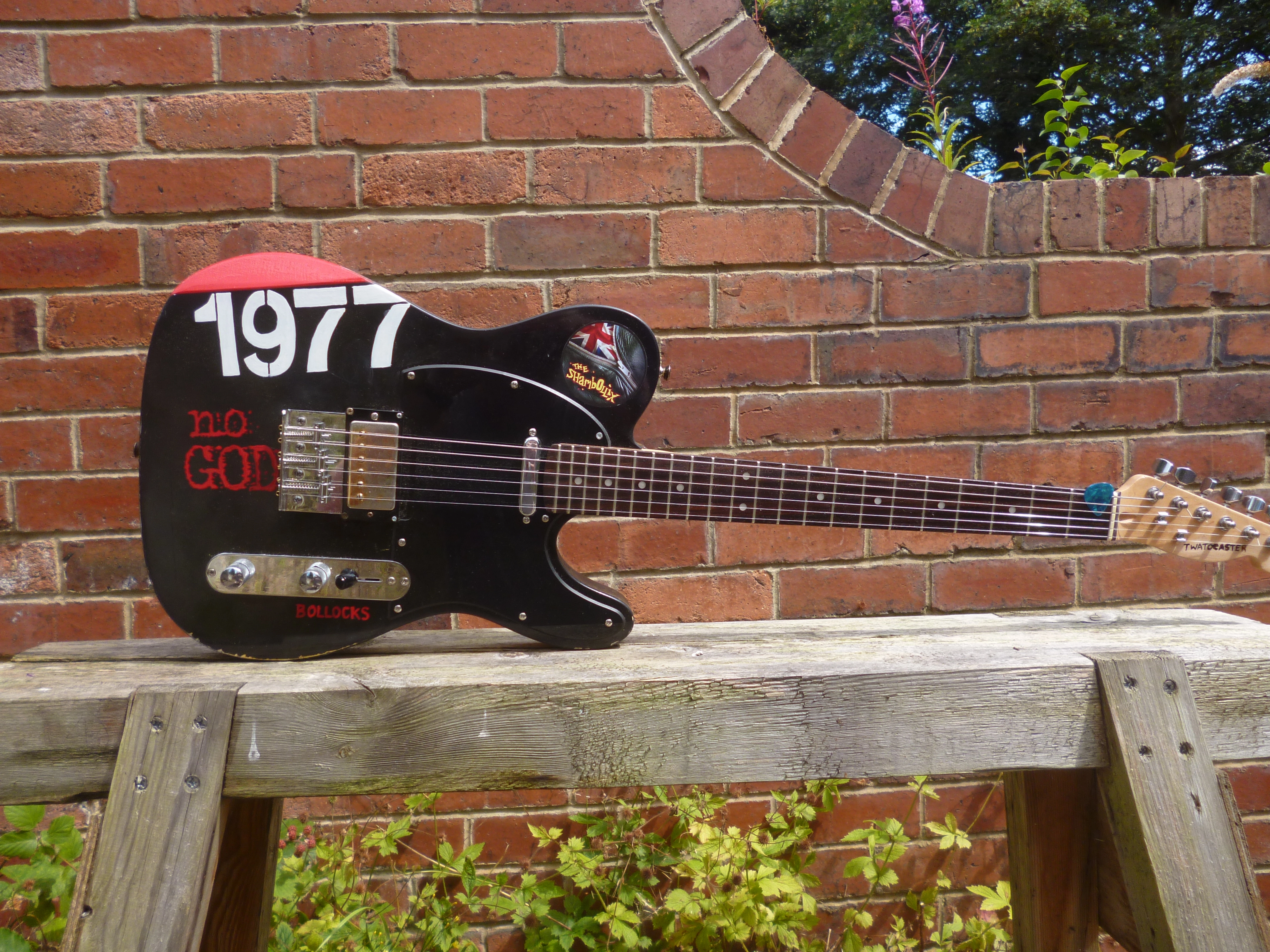

Ace. It's great fun modding something that you basically feel it's impossible to ruin. My No.2 is a Chord Telecaster, worth every penny of £40. I've put a great-sounding Japanese humbucker in the bridge, cut a chunk off the bridge plate with my grinder to make room, recently fitted a big, clunky kill switch, sprayed it black with a cheap rattle can of cellulose, carved a big chamfer on the upper rear bout with a belt sander as a forearm rest and attacked it with graffiti.:D

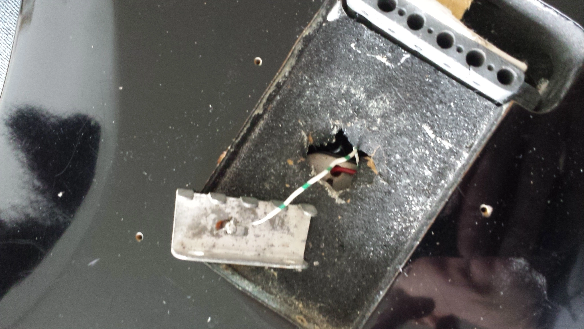

Here you can see where the wire comes through the back of the cavity to earth it where the trem springs are attached... appears to just be a hole smashed through the back of the body. The body is only a millimetre or so thick here.

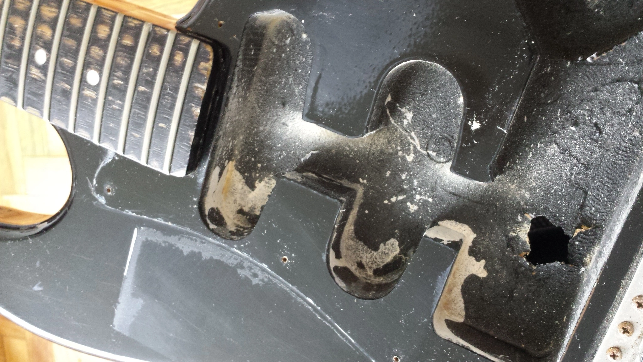

Weird - the interior of the body is just minging - no idea why it appears to have loads of white paint all over it? Shit job with the primer?

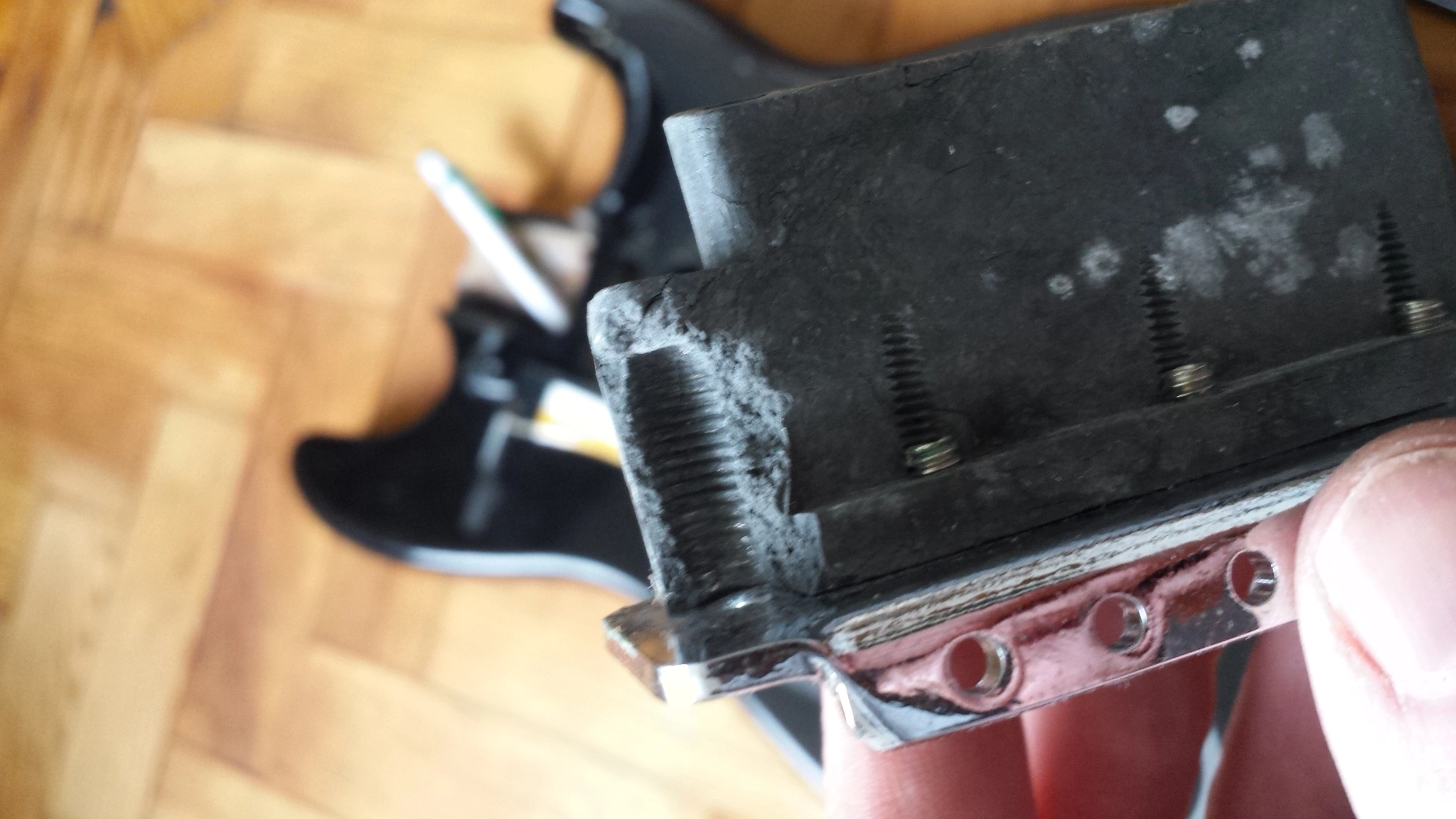

The trem block is cracked - can't be arsed to spend money on a new one, guess I'll just hammer a piece of wood in behind it again - the saddles actually aren't that bad.

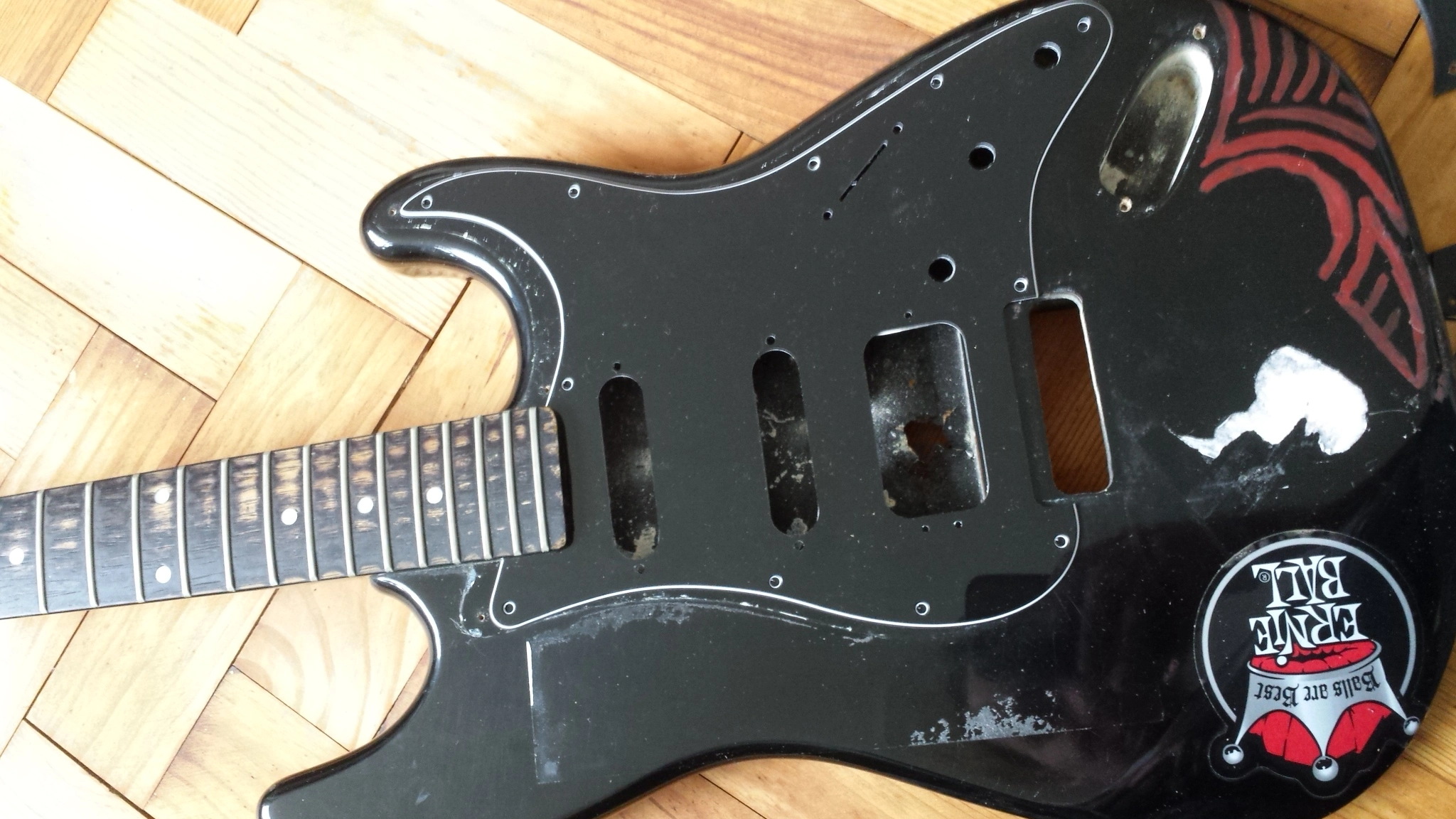

This is the problem with the pick-guard. When its in the right place it partially covers up the neck pocket (by about 6mm). The shape difference between it and the original pick guard is actually quite a lot. So much so that this one barely covers all of the holes in the body.
I'm assuming the new pick guard is for a standard strat shaped instrument - the way it sits, partially obscuring the neck pocket would imply that this guitar had a slightly shorter scale length - more like a Gibson scale length. Which is interesting and odd... but I don't suppose it matters that much.
What's the deal with the scuffed fretboard? Did somebody stain it brown at some point? I have NO advice to give regarding the scratch plate. :D Some measurements need to be taken. It looks to me as if the plate needs to go about 10-12mm towards the headstock; it might match the curvature of the body fairly closely, then.

Its not as much as 10-12mm, its more like 7-8mm. However this will then obscure the neck pocket so I'm gonna have to cut into the scratch plate to make the area where it surrounds the neck pocket deeper.... ah, well. If it was simple I wouldn't learn anything.
