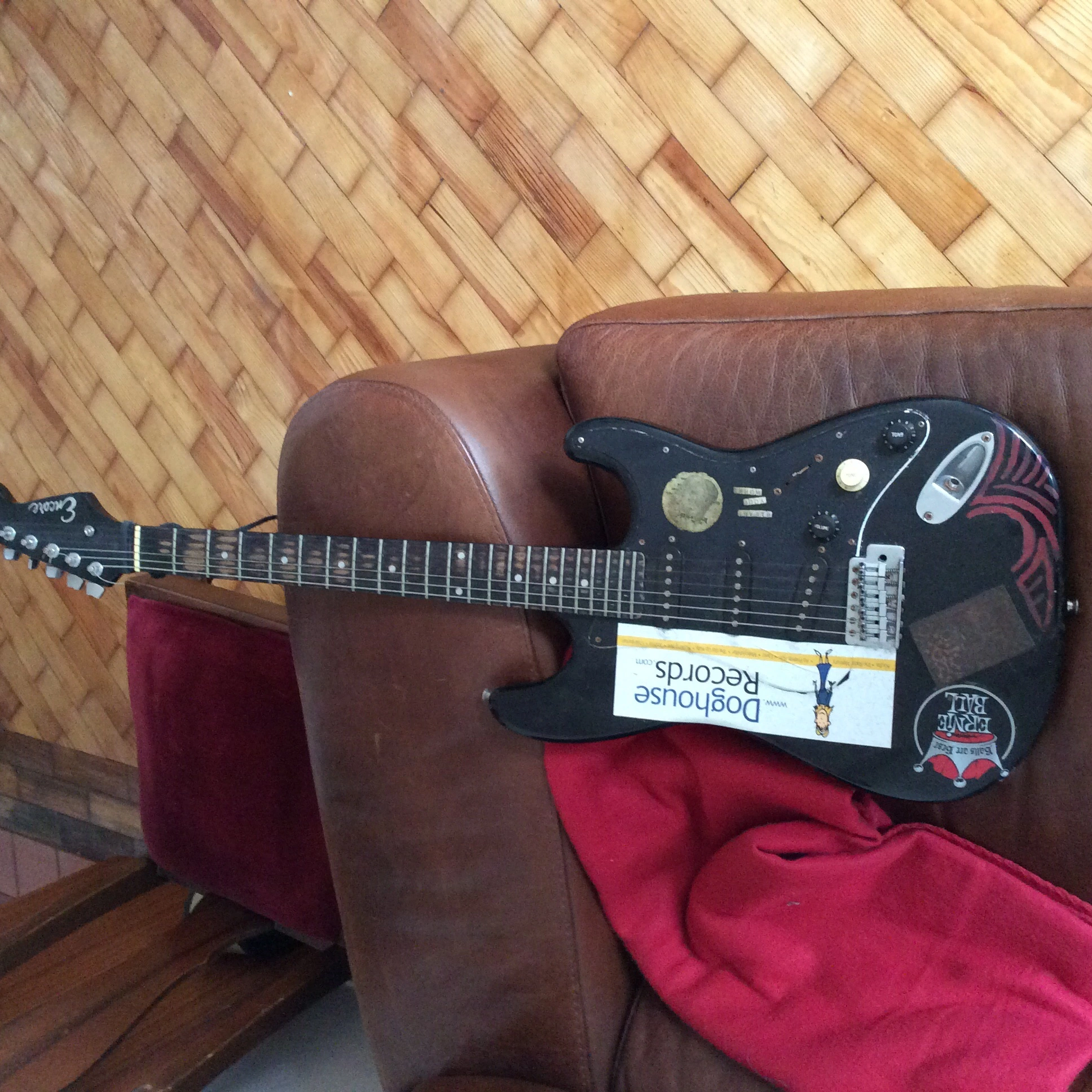

Finally got around to getting my old strat copy out of my parents attic.
Probably hasn't had new strings since the late 90s.
It's basically scrap. Needs a complete rebuild I don't think even the neck is usuable.
It doesn't have a truss rod and there are sharp fret ends everywhere. I remember I would occasionally get the top e string caught on the end of a fret and would have to pull it free.
The neck does appear to be straight though and not overly bowed.

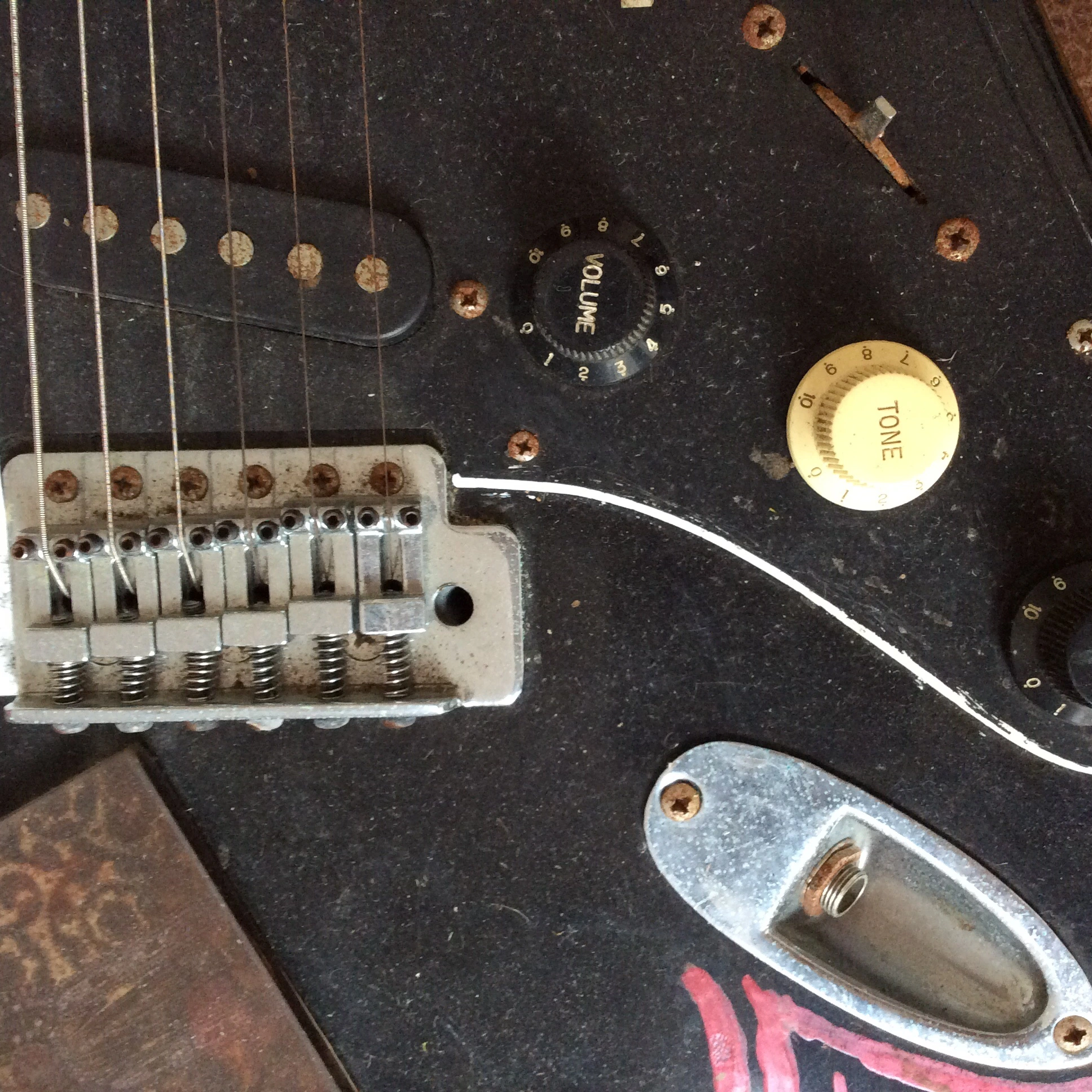

I haven't plugged it in yet. But all the hardware is pretty minging. Even the pole pieces and blade switch are showing signs of rust.
The whole thing seems to be covered in a layer of filth too.

Dear god. People pay a lot of money for the Fender custom shop to do that to a guitar. :

What am I looking for with regard's bridge/trem? The current on in there is a) crap and b) broken. I remember banging the whammy bar quite hard once, there was a crack and loads of metal fragments fell out of the back of the guitar so I hammered a lump of wood in behind the trem to stabilise it. I couldn't find anything that looked suitable on the Allparts UK website.
