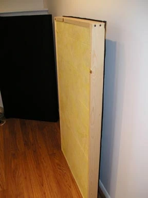

Here's a pic of one of my unfinished panels. (There's a larger finished panel in the background, but it's going to sit on the floor instead of hanging on the wall.)
I don't have a bathroom scale, so I'm going to venture a SWAG that this panel weighs about 30 lbs. I'm hoping that the weight won't crush my foam spacers since most of it will be pulling downward instead of inward toward the wall.

I've been wondering: With these home-made panels, does the wood used for the frame make any difference? I mean does it matter if it's a heavier denser wood, or a light-weight wood? Does it affect the acoustic properties of the panel as a whole?
MrBoogie
I don't think it has any affect on the acoustic properties at all. The wooden frame, as I understand it, simply makes the hanging process easier. Just hang it like a picture and you're set. I chose to go with no wooden frame, and just hung the panels using sticky velcro.

Any frame will slightly decrease the absorption of the panel as it blocks the sides of the insulation. But we're talking a very small effect.
I did used a hybrid method of hanging my panels.... a stip of wood stapled (½") across the top, with one staple coming straight out of the wood as a "hook". Then a nail in the wall to hang it on. Makes it about 29 pounds less than your panel HapiCmpur. Personal preferance. I chose the lazy route over your better, more proffessional-looking route. :p
As for haning the panels, at 30 pounds, I highly advise against hanging it with foam. No matter how well attatched your foam is to the wall, it would just rip under the weight of that panel. I didnt know you were using 2x4's as a frame!
The picture frame method would work well (with extra-heavy wire of course). I remember door stoppers being mentioned earlier in this thread... some of that lined around the wall-facing end of your panel would reduce any rattles and would prevent your wall from getting marked up.
I didn't. The one in the photo is a 2" thick piece of fiberglass in a frame made of 1x3s. The bigger one in the background is two 2" thick pieces of fiberglass in a frame made of 1x4s.
