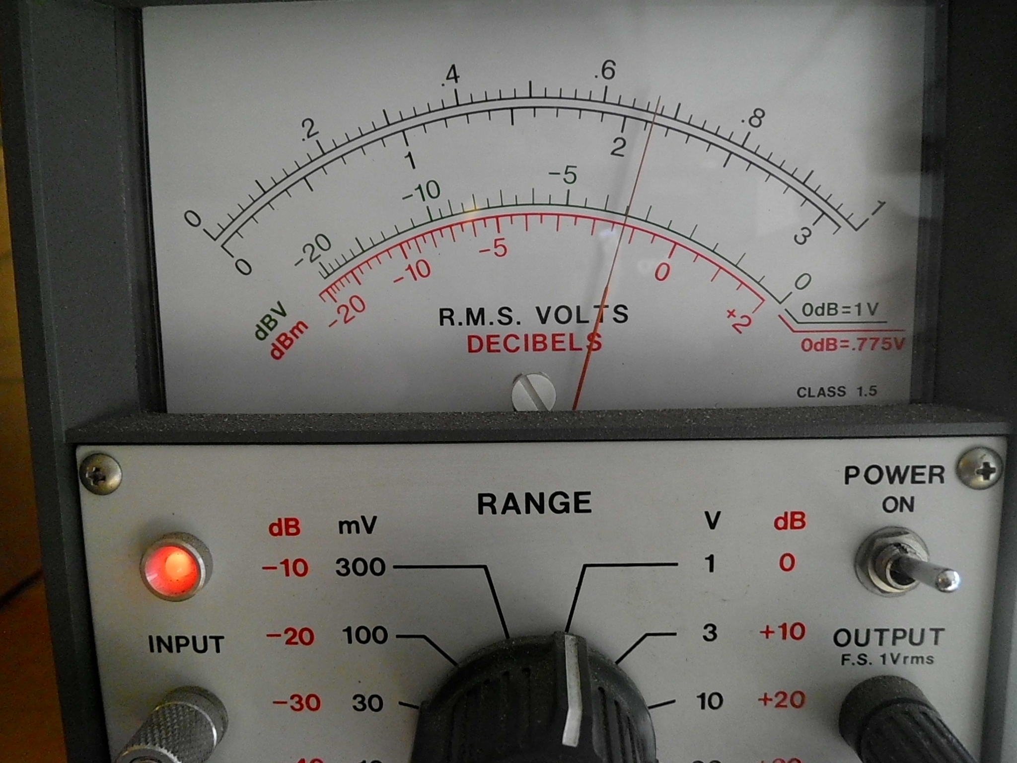

This thing is possessed!:cursing: Update to my update. Seems everything has settled down. Why I do not know. I went back after a little break and started again.
Everything was going great! I was moving along at Track 6. Then I noticed the consoles oscillator was still set to 1K from before!! So I reset it and went back to Track 1. Seems it don't like 10k but 1k it starts coming alive. The rest are so so. Just wondering is there a better way to input the 10k -6 signal? When I use the board, the meters are inconsistent as the signal input is varied by the consoles faders. It's maybe not a big deal. I know peak is peak and -7 db is pretty straight froward, But it would be nice to see exactly what each track is doing with a constant input level signal I think.

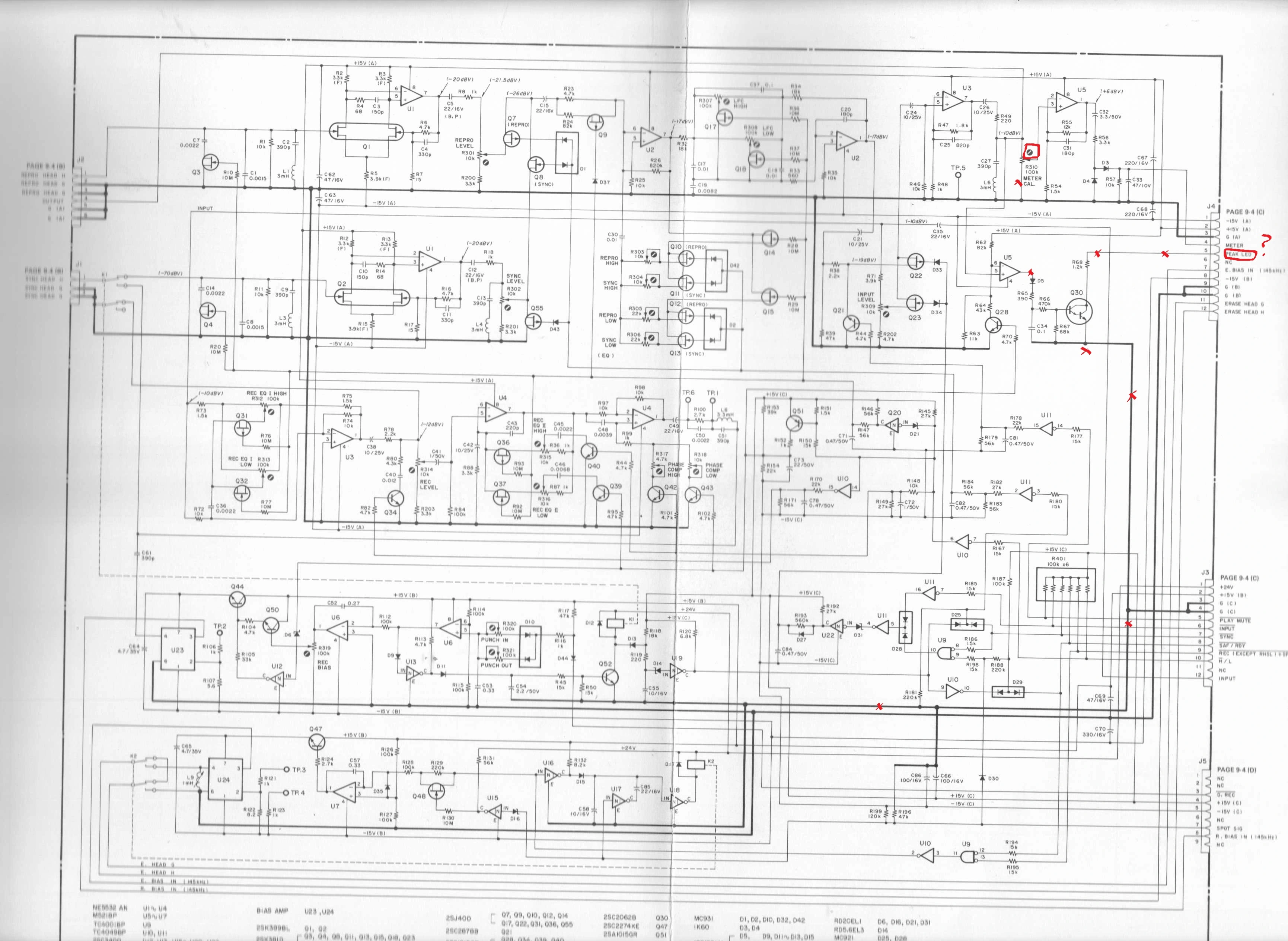

3) I do not know ANYTHING about this model machine. I do know that many tape machines use adjustable inductors to tune the erase signal to the erase head. Those inductors can spin all the way around ( no stop). It seems interesting that you lost erase after spinning a control all way around with that had no stops. Is it possible you turned an erase adjustment? Again I don't even know if your machine has this.( this is why I recommend people tape over controls they do not want to change.

But... I believe I said, I'm using Quantegy 456. So no worries. But thanks for the heads-up. But yea, might be worth mentioning. Any Ampex 456 prior to 1995 is probably no good! The Erase problem was effecting all tracks not just the two initial cards I had adj. the bias pots on. Turned out to be a connector inadvertently pulled at some point. (I think) :rolleyes:
