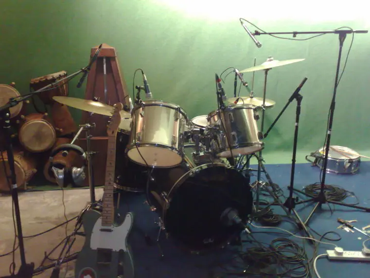

First Session

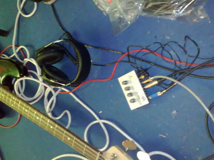

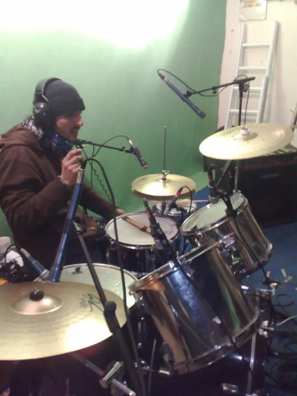

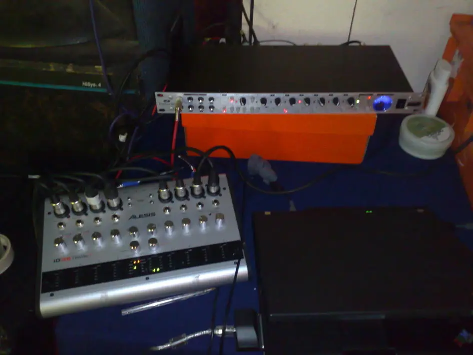

So this is my Octopre LE and Alesis IO26 in action.. Set up five headphones on three seperate mixes.. Drummer had no drums but lots of bass, guitar and vocal, then I had my own mix and the vocalist, bassist and guitarist shared a mix..

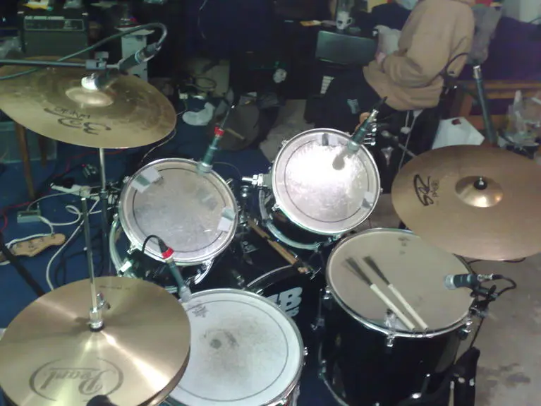

Used 9 mics on the drums! Two on the snare (over and under), two on the Kick (front and back) then one on each remaining sound (three toms, hi hat and cymbals)...
DI'd bass guitar into Focusrite Octopre LE so no spill there..
Moved Guitar into stairwell outside studio room so vocal mic and drum mics would not pick that up..
Vocal just had in same room as drums on SM58 facing away from drums as far a distance away as possible...
Surprised at how little the SM58 picked up drums and even the bit of guitar spilling into the room from stairwell!
Biggest problem with this recording is the pre sets the guitarist used, I found some of the to be harsh and way to much in mids and treble, but without having complete controll over his presets there is not much I can do, I did work with him on the a bit but you have to give people their creative space. Its also hard to hear exactly how things sound when listening through headphones.
Pretty happy with results.. Will upload soon...

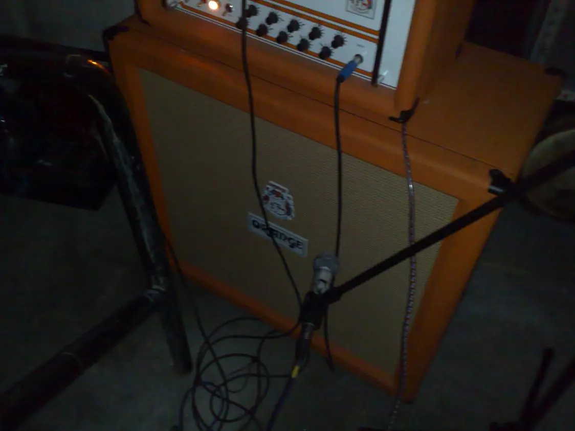

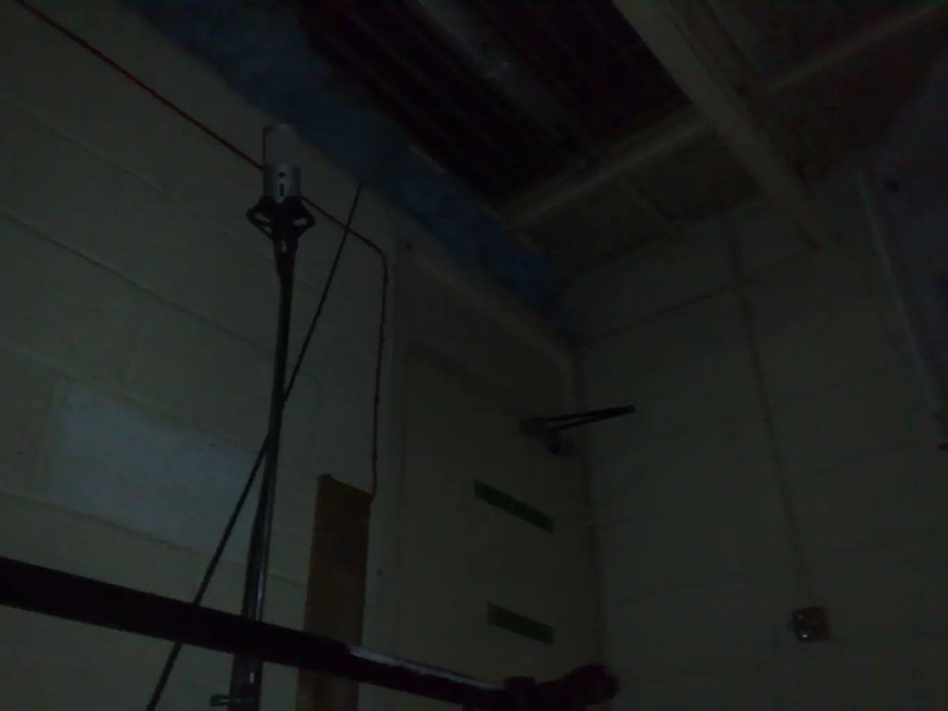

Put two mics on guitar amp.. One SM58 (with I used Behringer XM8500 the SM58 is little harsh not enough bass)...
And one Studio Projects B1 far away for some reverb. . .
Over all sound is good but some of it is to harsh which was mainly pre sets . ..

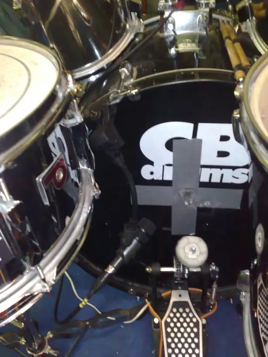

this is the other kick drum mic.. Really needed this to get the slap otherwise would have just been a boom...
