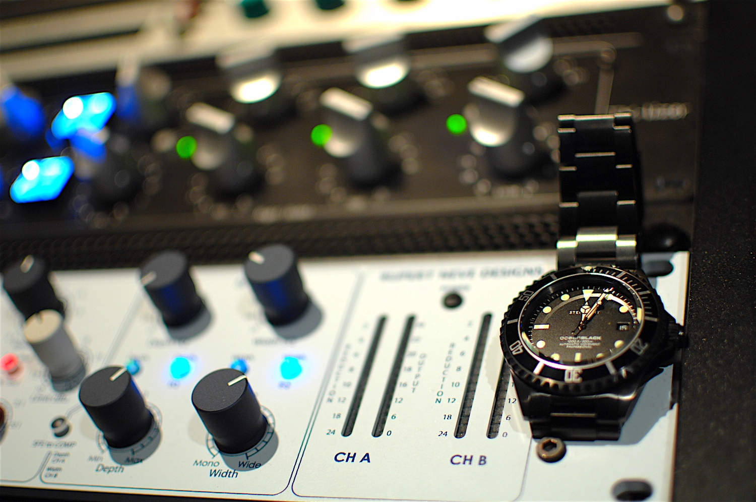

Might I suggest a nice watch...? A Steinhart 'Ocean Black DLC' with a Swiss ETA 2824-2 Elabore automatic movement is only around $400 shipped to the US. You want analog goodness? There's nothing like an auto-winding watch in the classic Submariner style.
Sorry - Mine came in a couple weeks ago and I'm absolutely smitten with it.
Back to the shopping list -- Monitors - Trapping - Interface - Mics - Cables and what not - $5k. Add that watch and you're still under $6k. Get the basics in there. *Then* start worrying about outboard. And don't get me wrong here -- I'm nuts about my outboard. But it's the speakers and the room that even allow me to hear it. Without that vital connection, everything else is pretty worthless.
'Cept the watch. I actually see people selling those for hundred over retail. Not selling mine - Just sayin'...
Heh... Watch forum shot below (yeah, I can be geeky).

As for the watch...the check is in the mail so to speak. Could I interest you in a stunning new car to support my cause?
