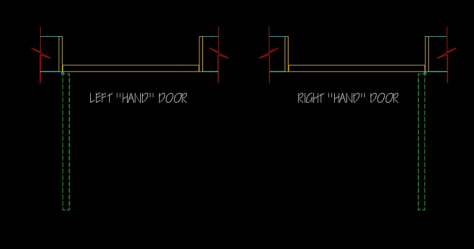

Hello Ibrow. As usual, not much time this morning but I did manage to write out a couple of paragraphs to start. But I ran into some questions. I sent you an HR email last night. Did you get it. Look at your inbox. Now I have one question to ask before I can continue. That is the "HAND" of your door. Take a look at the pic. "Hand is determined by standing on the "exterior(hinge knuckle exposed) side of the door facing it. Like the street side of an exterior door, although an interior door is the same, as far as the knuckle is concerned. Anyway let me know.
