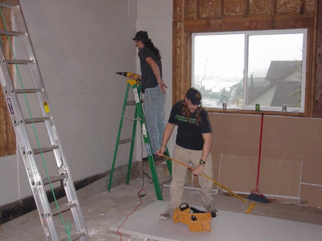

Here's the first live room picture:D A pile of wood & some drywall.
I am putting two layers of 1/2 sheetrock on the existing outside wall with a layer of green glue in the middle. False walls will be built inside of the outer walls with R21 insulation and another layer of dry wall.
Exciting picture I know. The real work is happening up stairs right now.
Two weeks of demo just got done and they are laying hard wood on the main level today.

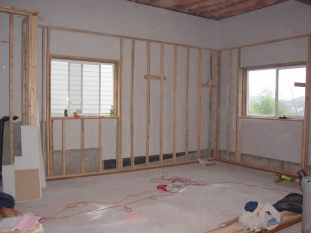

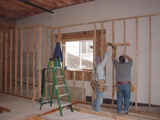

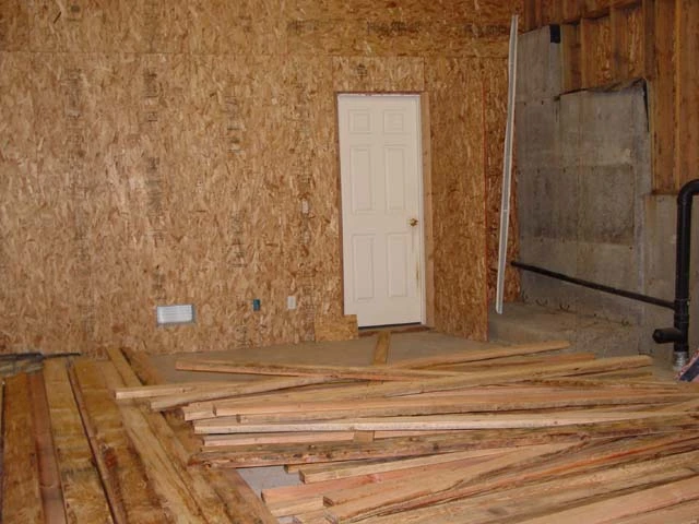

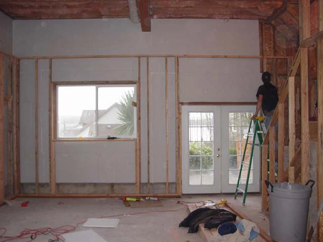

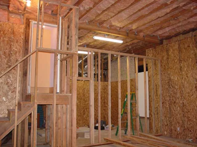

I hope:) Things are moving a bit slow right now, but that's ok. I need the break. Last half of December pretty much grinds to a halt.
I got the rest of the extirior wall sheet rock up and the framing is almost done. Trying to get the electrition out, but everyone is off for the hollidays.
Here are some shots as Things progress.

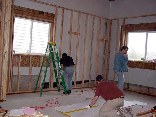

Some more shots. The last two are angles out of the control room window.
On the very last on the osb wall to the left there is a hidden door that goes to a finished room that is about 12 X 16 or so. It's big enough to make a very large drum room or to devide into a drum room and another ISO booth.
I think I will keep it a drum room and storage though. I've got other space that won't require the amountof sound proofing needed to put an ISO booth for vox or guitar right next to the drum room.
