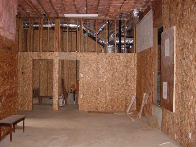

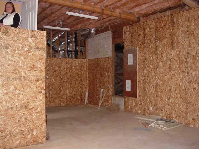

Here's what will be the control room / vocal booth area. Our agent to the left.
It's hard to get a shot of the main room. I am taking these pictures from the main room.
Not shure now big I am going to make the control room. Probably a bit larger than the beadroom I am using now so that I can have more seating.
F.S.

dude, that's like my dream. to have a house i can use a portion of it JUST for recording. i'm suck in my bonus room for now.... :(
Eight years in two small bedrooms;) Me and the guys hardly ever get together to just jam. four guys, drums, amps and speakers in a 12 x 12 room is not much fun for jamming:( The controll room here will be bigger than the space I am in now.
I'm pretty stressed now:D We have got to get our current house to sell soon!
Fun, Fun, Fun. but I guess no risk no reward.
F.S.
That looks Awesome !!!
I can't believe the height you have in there, thats great.
