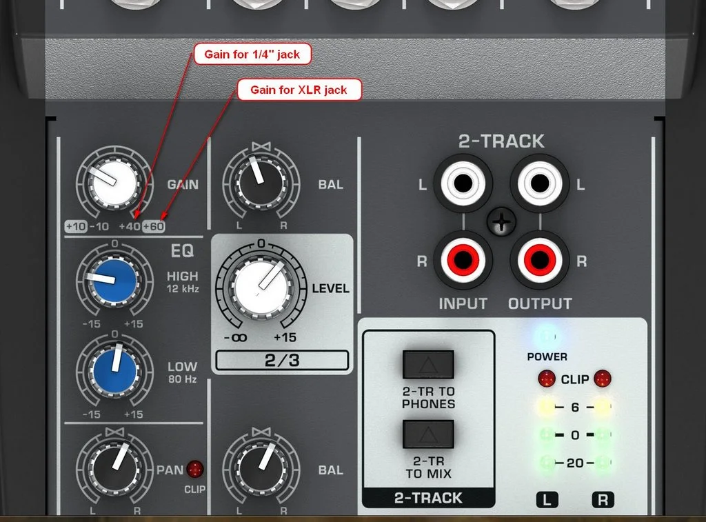

Using the XLR to 1/4" you'll have less gain. The 1/4" jack on the mixer is intended for line level inputs and per the spec has a maximum of +40db of gain (This may be less than +40db if using a TS(tip-sleeve) type plug rather than a TRS(tip-ring-sleeve)). The XLR mic input has a max gain of +60db. It's sort of noted near the gain knob on the mixer, but perhaps new to this you may not know that.

So just as a follow up to this story, I've ordered a XLR->XLR cable, plugged it in (still not expecting much of a difference at this point, but) oh. my. god.
It's a darn cable but the difference is night and day. I have to put the gain slider to 50% at best at this stage, but the noise at this level is... gone. At least for the stage line MPR1; the Xenyx quality has significantly increased as well, but it still has some sort of noise as well as some.... high pitched noise? Don't know, but at this point don't care either, because the stage line MPR 1 delivers everything I wanted it to, with exceptional results.
Anyways, as simple as the solution was in the end, I still thank you both very, very much for the help you've given me.
