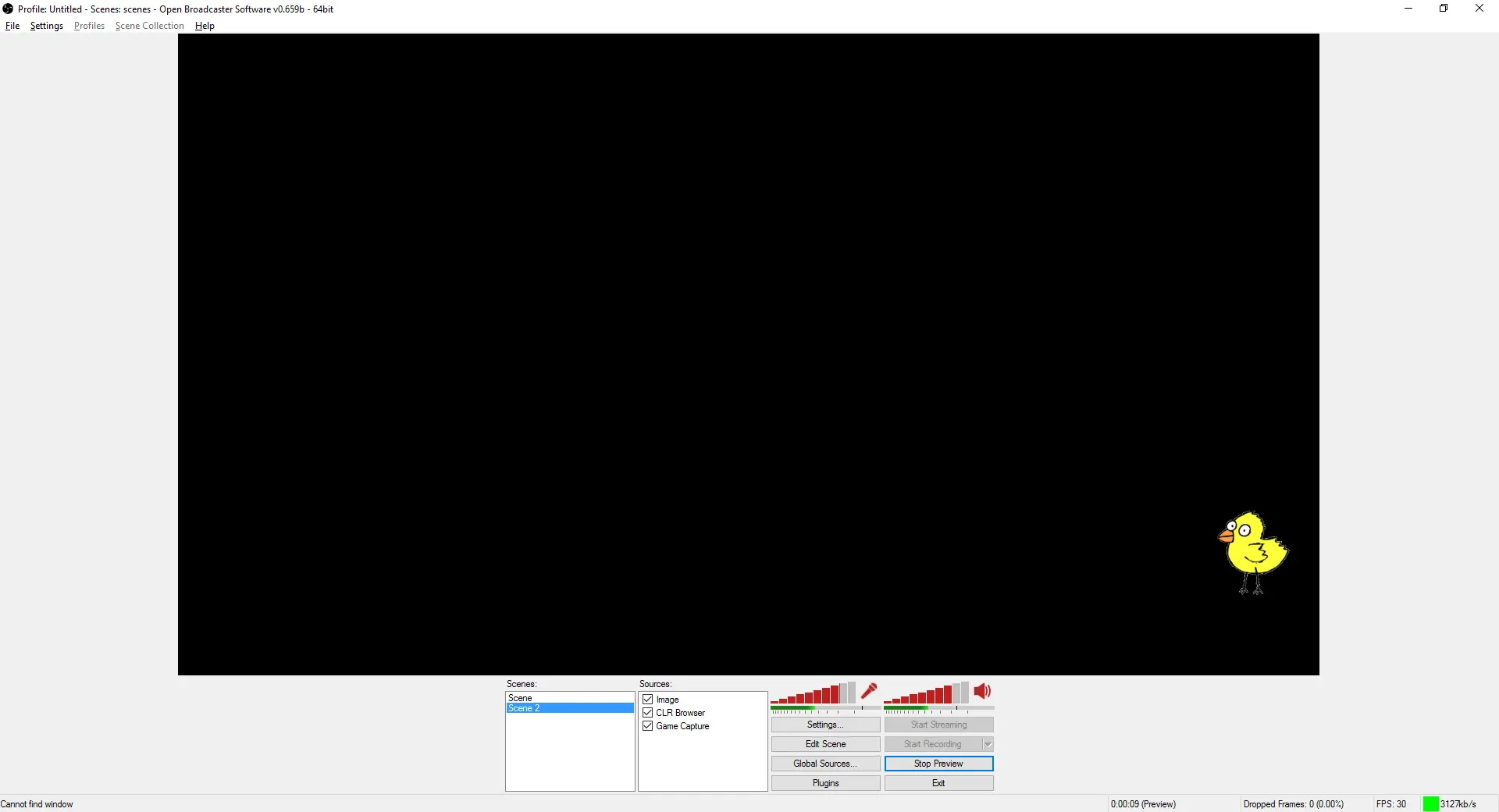

It's important to note that when i'm recording and not saying anything into the mic, you can see the mic logo which is next to the sound logo, going up and down when there is sound. Even though i'm not talking. I hope that made sense but you can see in the picture, the green on the Mic side matches the same as the green on the sound side.
**If i turn the knob all the way down on the Mic in Line 1, the overlapping sound is gone and it sounds fine.. But then i cannot use my mic...***

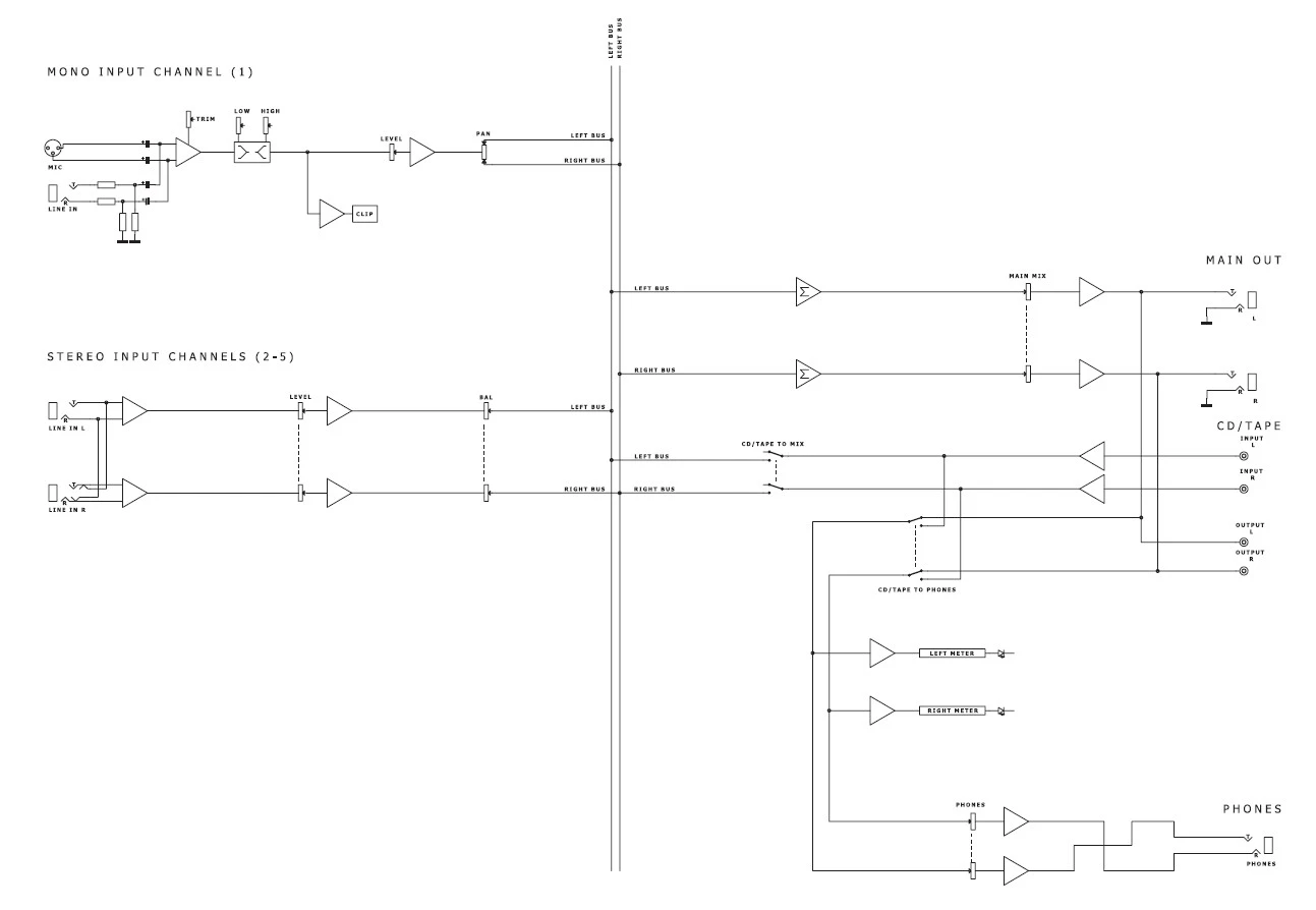

Xenyx 502 block diagram....

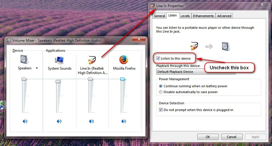

Don't know what OS or hardware you have, so this is a guess of what you may have. Below is for Win7 Pro with a RealTek soundcard.
- Look in the audio mixer panel and find the MIC or LINE (you actually should be using LINE in if your computer has it or can switch to it on the jack).
- Click on the icon of the 'cable' to open 'Line In Properties'.
- Uncheck the 'Listen to this Device' check box.
- Try the system out to see if you don't get the 'overlap' sound.
When the 'Listen to this Device' box is checked it passes what comes into the MIC/LINE jack through to the speaker/headphones out jack which would be sent back to the mixer. I'm not 100% sure this will fix it or not and your OBS software may have something similar that passes the audio through from input back out to the output.

Ya the listen to this device is unchecked so that wasn't the issue.

With that mixer, I can only see one way of avoiding the feedback loop. You have to prevent the audio you are getting from the PC from getting into the mix and back into the PC.
You can do this by not going into line 4/5, but instead going to 'tape in'. Then switching 'tape in' to headphones.
This may work, but looking at the diagram, switching 'tape in' to headphones my switch off the mixer inputs to the headphones, which would not be nice. You need both.
Tape in is more for what you are not mixing, or, for monitoring. You are mixing the MIC and the xbox? So, that's a MIC and Line channel. You don't really need anything in tape in, just use the main out and tape out. I got a 1985 era Tascam mixer once I found out about the tape in being live. Yours may be different.

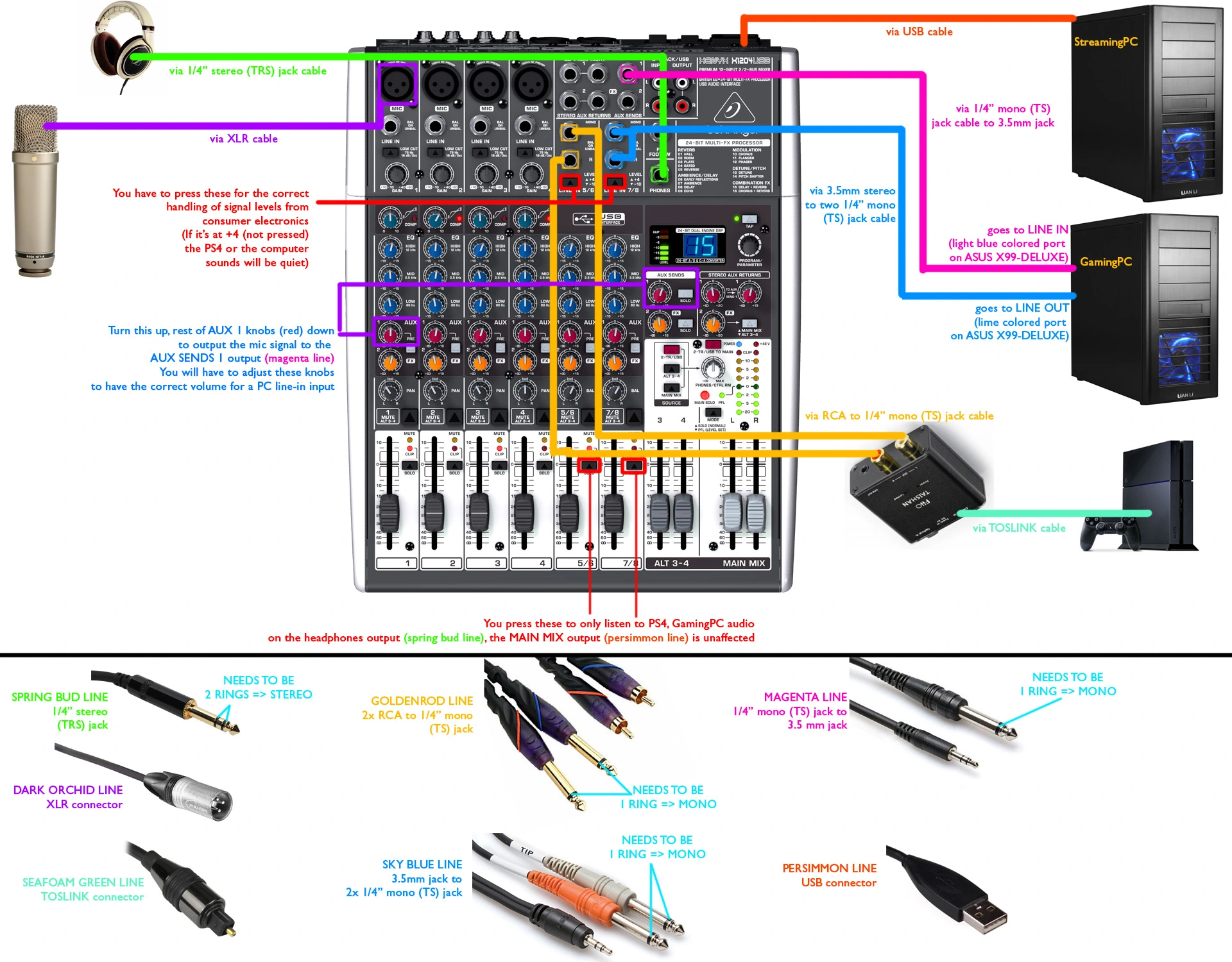

You have to feed the fx send to the computer and open the send only on the mic channel. You can double the output by a Y cable.
Could you indicate to the OP (Duckgoosed) where the FX send is on his Xenyx 502 mixer?
