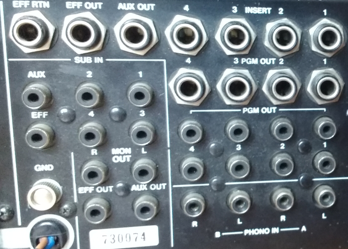

The old Tascam has sub in -1,2,3,4. In theory, I could plug the out of the Behringer 1002FX into 1 & 2, and plug the out of the Behringer qx2442USB into 3 & 4
