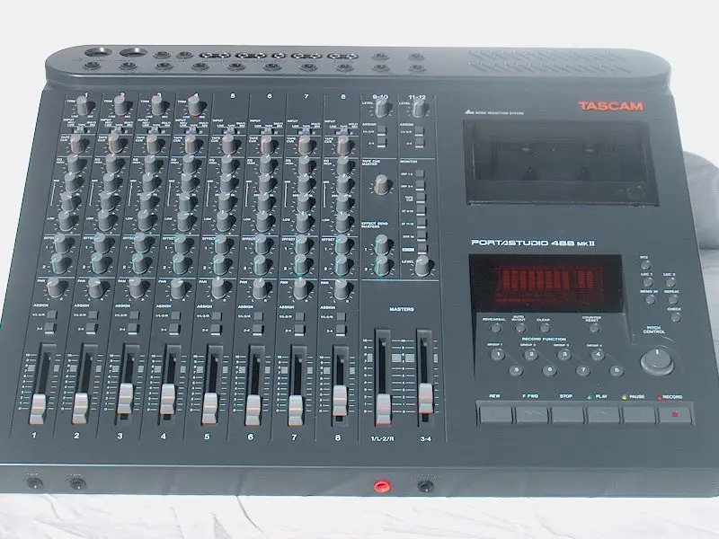

I think if you kick all $300 toward a Tascam 488mkII, you get a fuller production with less hassle. Then you can skip the rest of the components and mixdown step, and bring the 488mkII to the classroom, plug the outputs into a boombox, and just present the mix directly off the Portastudio to the class, as is. Say, "I have all the individual tracks recorded onto this tiny little tape, and I mix it down, creating all the balance and stereo image with these faders and knobs on this wondrous little analog beauty called a Portastudio".
That's what I'd do, anyway. Then you have a much nicer and full featured analog Portastudio to go forward with, and you can get effects and mixdown units at a later date. I think it's more illustrative of the "analog"-ness of the process, and why do you care to mix it down anyway? Are you going to present the teacher and each student with a cassette copy? That, IMO, would be missing the point and rather useless.
Take the Portastudio into the class and do the mixdown live in front of them, while giving a brief explanation to your purposes and methods. At the end you can wrap up and say something along the lines of "digital recording and production is meant to mimic the basic ideas and methods used in the analog world onto a computer driven device",... not to get high and mighty about it but something like that to simplify the expression and give a little mini-lesson or tutorial on the subject.
That's how my mind works, anyway. That's what I recommend. IOW, if you bring the production unit (Portastudio) in and do a full demonstration, it's way better than saying "here's my song on tape we did it on analog", which to most people means ... nothing. Just make sure the 488mkII is in full working order and you're golden.

You guys give such great information. I might just keep looking for a 488 and hold out on all the extras. I guess I really don't need to make copies of the cassettes since I'm just using them for demonstration, that can come later. The only bad part about this project is that I only do a speech in front of the panel of faculty. I leave my product in the room with them and they grade it while I'm out of the room. That being said, they'll probably need to know how to "press play" to hear what I did. Or I could video myself recording the song and take pictures and create a nice video about the process I used to create the song.
I've got a bunch of ideas in my head for the exact project, but I sincerely appreciate all the advice you guys have given me. If I need you guys to check something out or if I have another quick question, I'll be sure to post it here!
