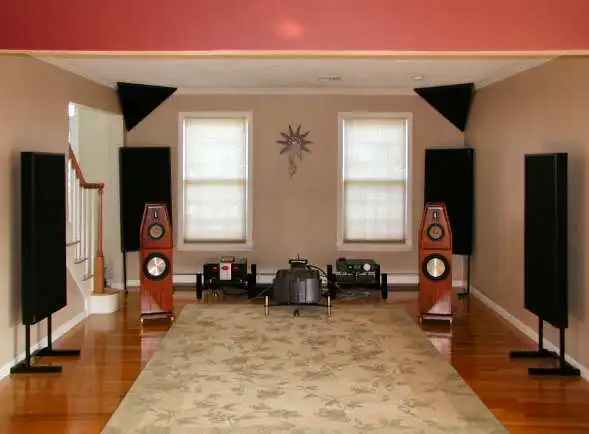

If you cant afford to treat the corners floor to ceiling right now, then later you can add on "triangle" bass traps, I'll post a pic in at the end of the post, and use those for the tri-corners at the ceiling and floor.

Tri-corner traps:
