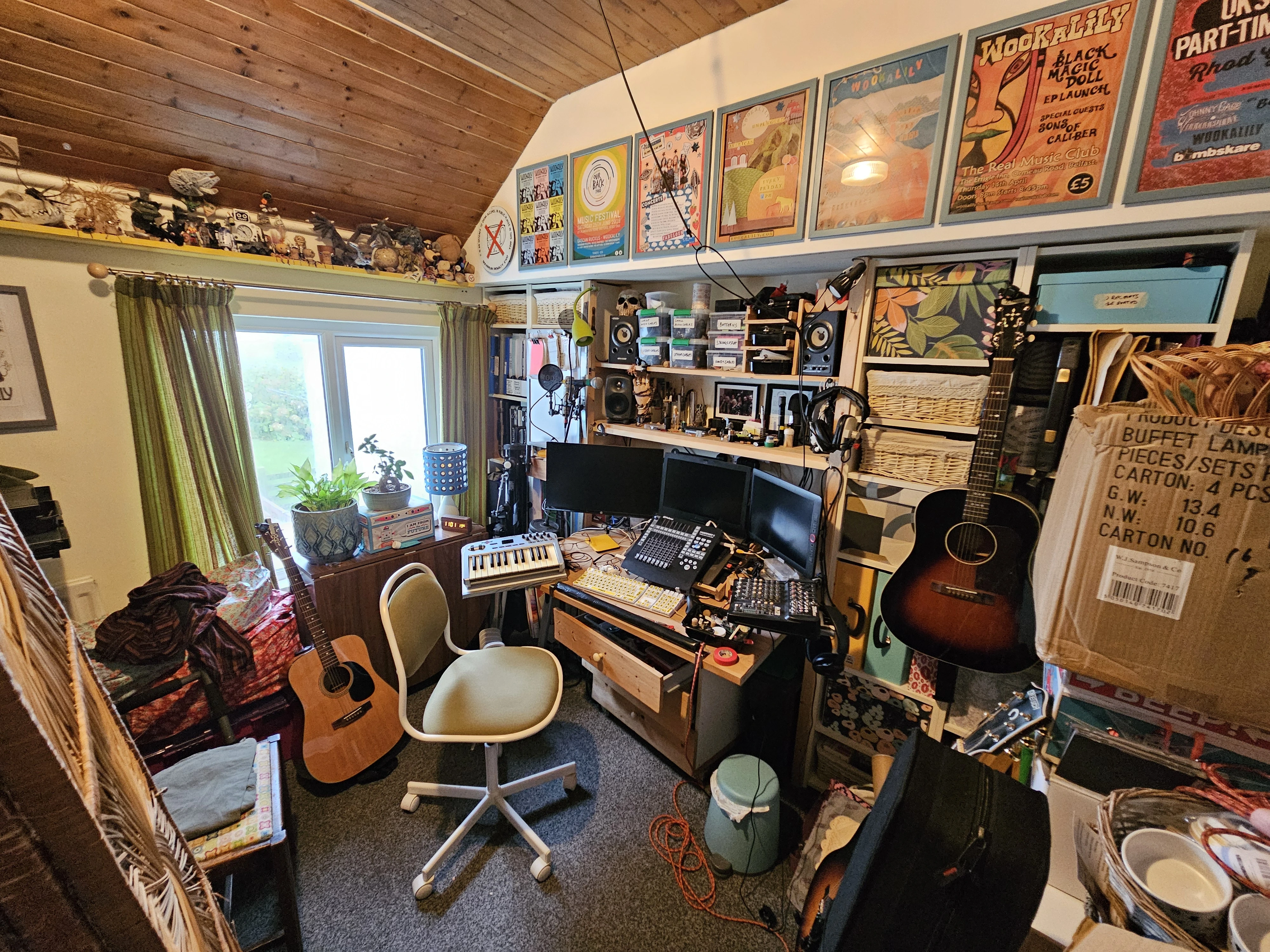

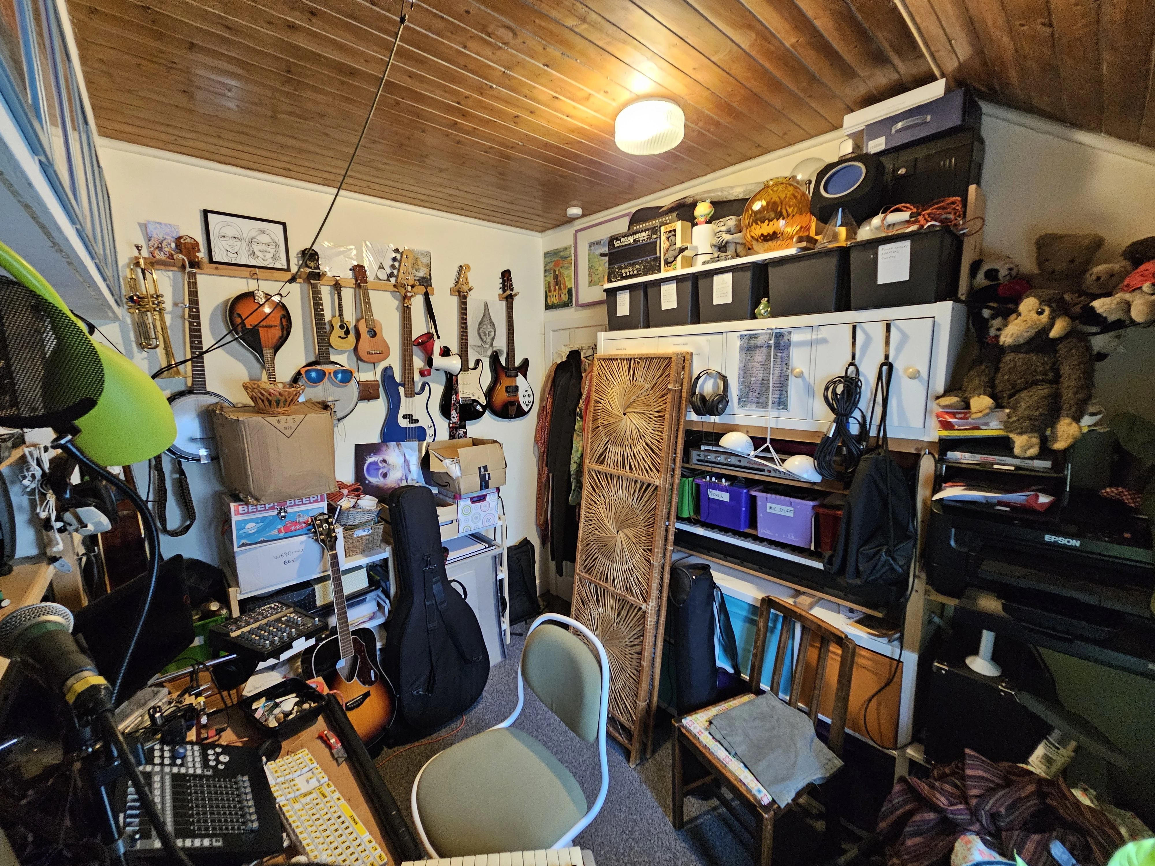

Thanks everyone for the advice, here's a little more info about my setup and some images. My room is about 3x4m with my desk in the centre of the 4m wall. Here's a picture and speakers are small genelecs see below.

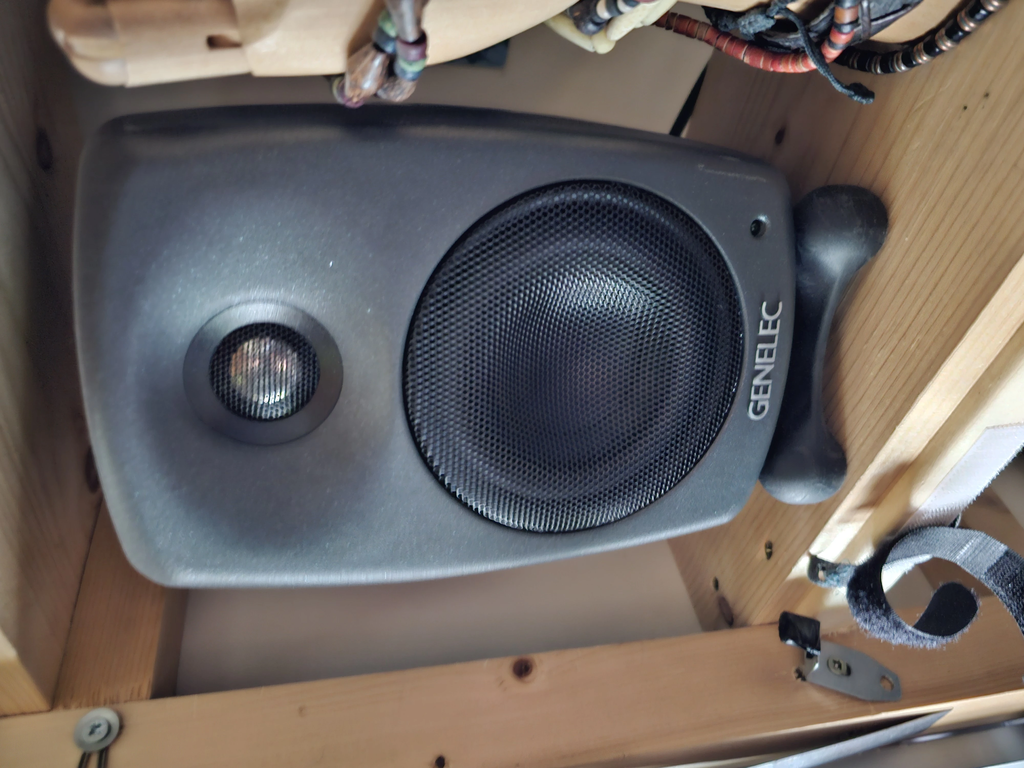

I like the busy nature of the room. Plenty of diffusion. Do the tweeters in the genelecs point at your ears? They tend to go dull off axis, and with the limited bottom end this might impact on your mix and EQ decisions?
Realistically - I suspect your room is what it appears to be. A useful space, but with compromised acoustics. If you can modify your ears to cope with what it does to the sound, you can make it work. It's just not really a treatable space. No corners spare for traps, no bare walls for HF treatment, real symmetry - so without clearing it all, it's just not going to be balanced and even. Often happens in multi-use spaces. My guess is you cannot remove everything and unclutter because it is all there for a reason.
My first thoughts are that the ceiling is probably the fist thing I would try to treat with either Clouds (dropped suspended panels) or fixed panels on the ceiling.
The suspended panels do absorb better in my opinion due to being able to catch direct soundwaves from the source but also reflected waves from the ceiling.
The diffusion and absorption from the items in the room may well be enough to handle a good amount of first reflections.

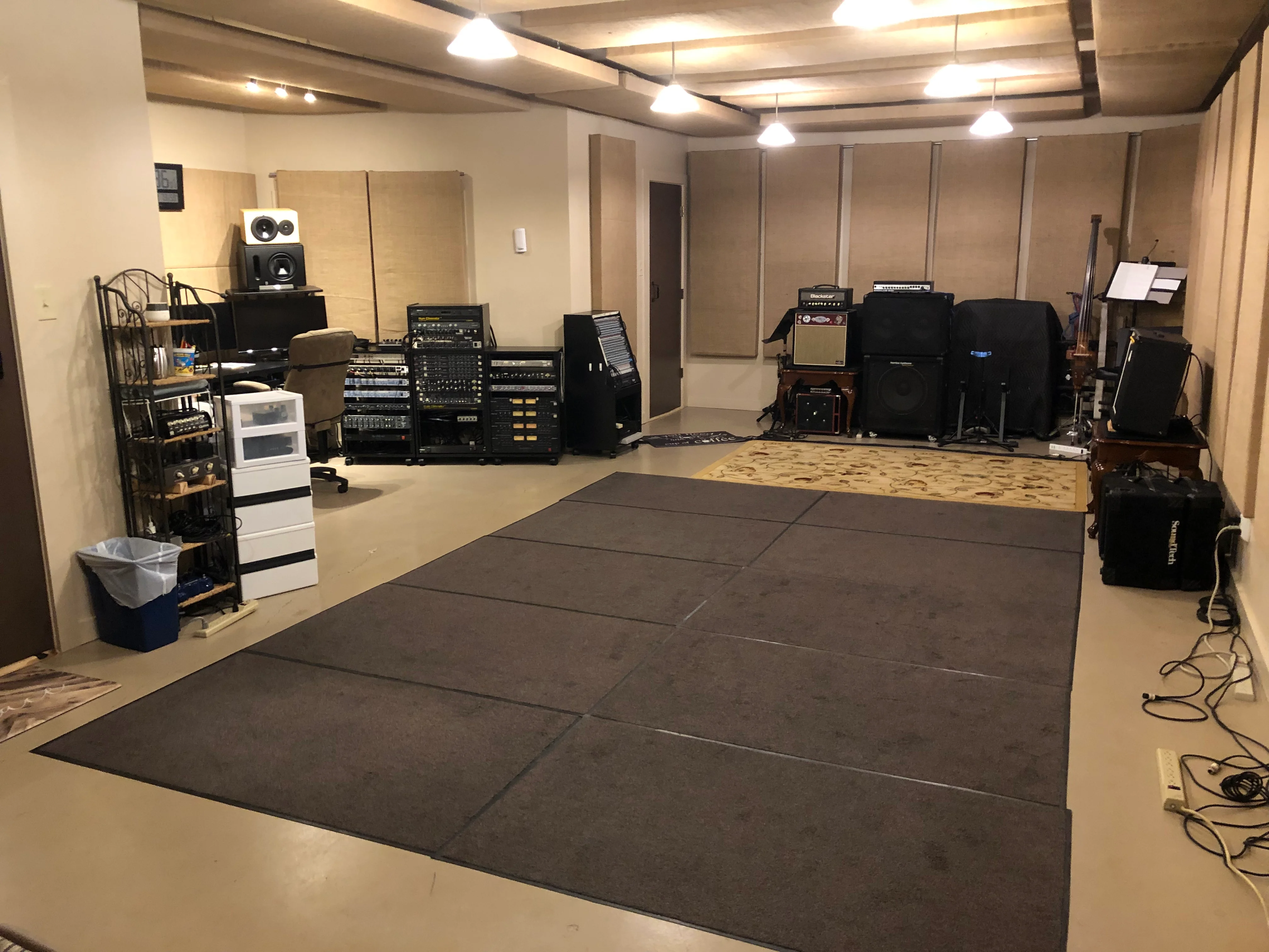

Here is a picture of my studio. My Son and Wife helped me build and hang these and they work great!

That window with view, must be preserved,
the rest is fixable as indicated on the previous post by "tmix" .
Your speakers are too high IMO - if you adjust them to lower I think you will hear the room better and know what needs fixing.
Yes they are a bit. Genelecs have a 'tilt foot' so if they cannot be lowered maybe you could tilt them forward? Were they the usual square boxes I would say invert them to get the tweeters nearer your ears.
Now, chuck, I know you say you cannot de clutter but is it possible to clear the 'crap' BETWEEN the speakers? The random reflections of all that stuff is spoiling the stereo imaging big time.
Clear the space and insert a wodge of Rockwool. Even a layer of pyramid foam would help.
That's a lot of stuff in the room, which is indeed good for diffusion. Maybe if you really want to you can hang some ceiling panels or find a spot for some bass traps. But as others said you should start with putting the monitors and where you sit in the optimal spot. That will go a long way for the speakers and stereo field sounding as good as possible. Find a room node calculator and put yourself and the speakers in the spots where the nodes aren't
"Diffusion" is all very fine and dandy throughout a room (not sure it is ALWAYS needed?) but having 'hard' objects between the speakers causes the destruction of the proper radiation pattern necessary for sharp stereo imaging.
But! Perhaps in the modern, low quality MP3 buds world studio peeps no longer care about creating |(or re creating) a believable stereo "picture"? So long as some ***t is "panned about a bit!? #Here a bit of panned ***t. There a bit of ***t # !!
The key to getting a good stereo image is first good speakers and Genelecs are reckoned to be excellent. Next they need to have very similar acoustic material close to them, i.e. NOT a solid wall one side and a window the other. If you cannot make the sides the same at least put up absorbent material. And, as mentioned, a clear space (or at least a symmetrical one, e.g. computer screen) between them and more absorbent.
