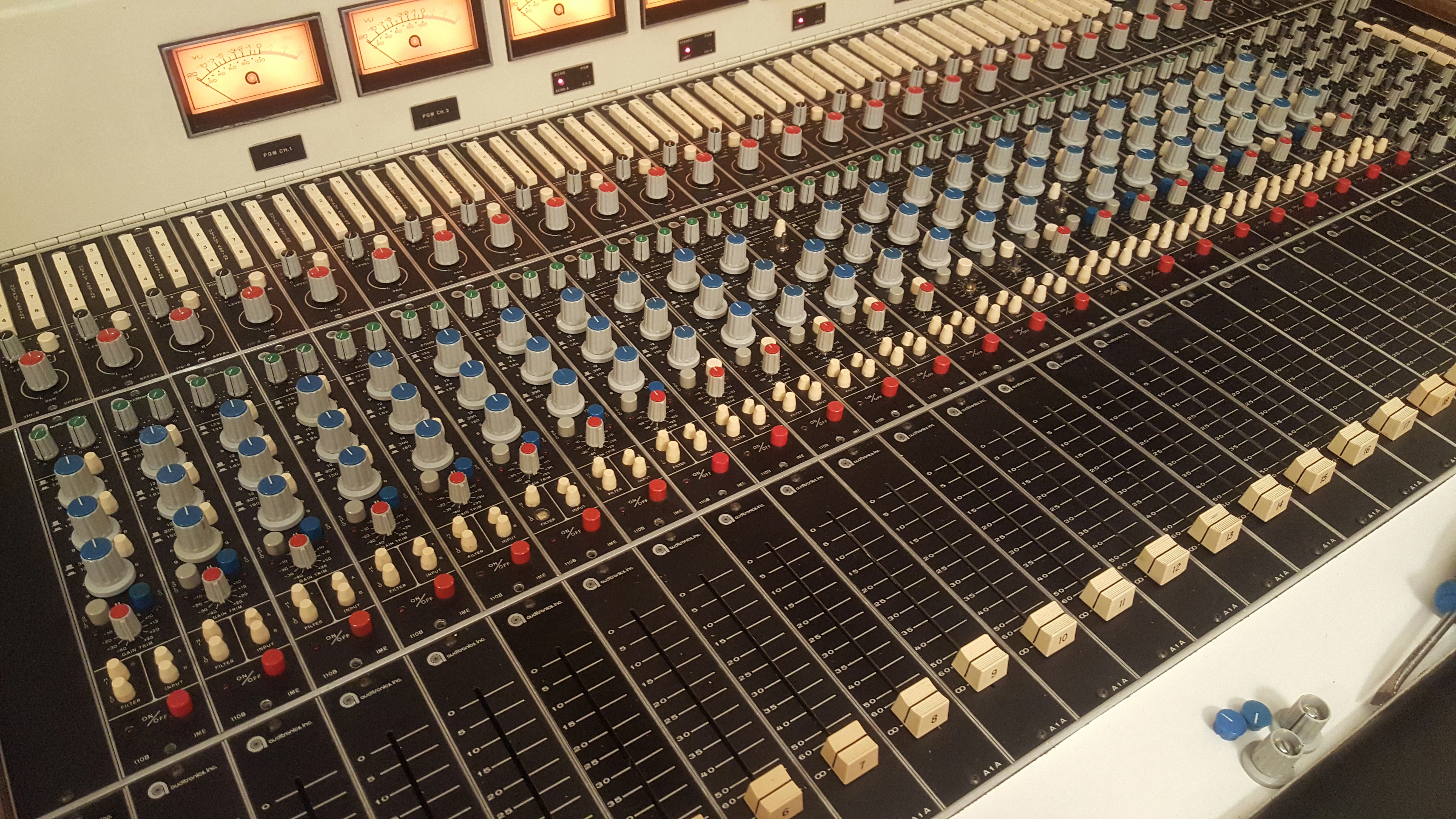

Spent much of the last day getting all of the knobs reattached, and replacing a few broken switches. I've got a couple pots that definitely need replaced (stops are broken), and a few knobs that were missing when I got it.
Getting really close to wiring up the patchbay, and really running things through their paces. I'll get the computer hooked up, and that will let me do some detailed measurements on noise, distortion, frequency response, etc... I use some software called ARTA for that stuff.

What a gorgeous console, Bob... :thumbs up::guitar::listeningmusic:
Are those EQ controls on push-pull pots??
No, they're just large knobs for the level. Each band has 2 selectable center frequencies via toggling a pushbutton. Plus a LPF and HPF. They're an inductor based design, and are supposed to be one of the cool parts of this console's sound.
Thanks again for the kind words. Enjoying reading through several of your threads here as well!
Oh now I see the frequency shift switches...! I was going to say I think push-pull pots are cool, but would be harder to identify the state of each band on each channel by sight or touch.
Inductor EQ is hard to do right and more costly to manufacture. I'm sure it was done well on your desk.

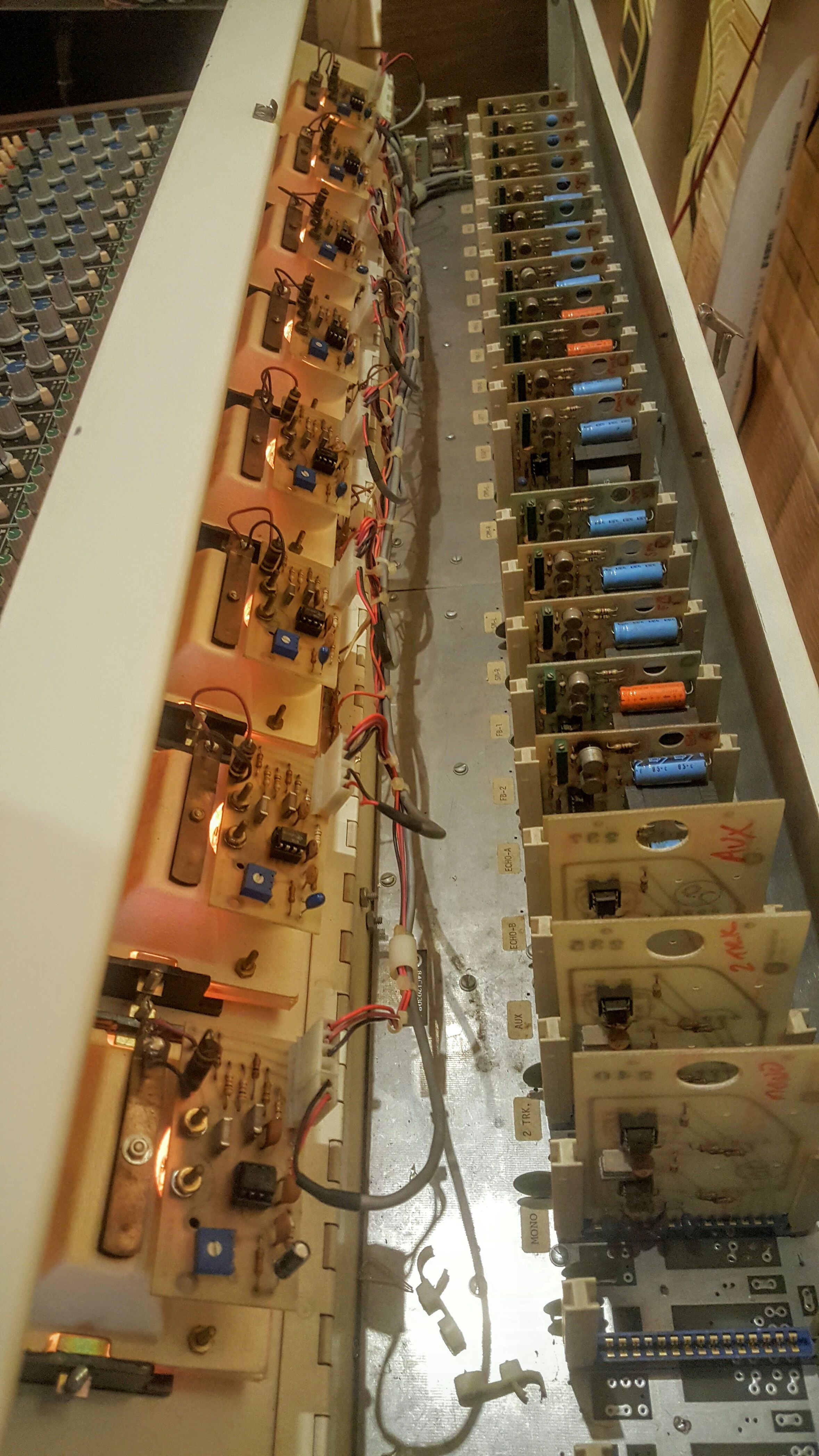

More work on the meters tonight. Turns out the molex solder joints were only part of the story. The meter buffer boards mount onto the meters' input terminals with a series of brass washers and nuts. It appears over the years oxidation has made electrical contact through these pieces intermittent at best. So... I removed all the nuts and washers, and took a small dremel wire wheel to them, the bolt post on the meter, and the pads on the buffer board. *Way* more reliable now. It's tedious. I'm through 4 of the 8 meters, but making progress, and calibrating the meters as I go.

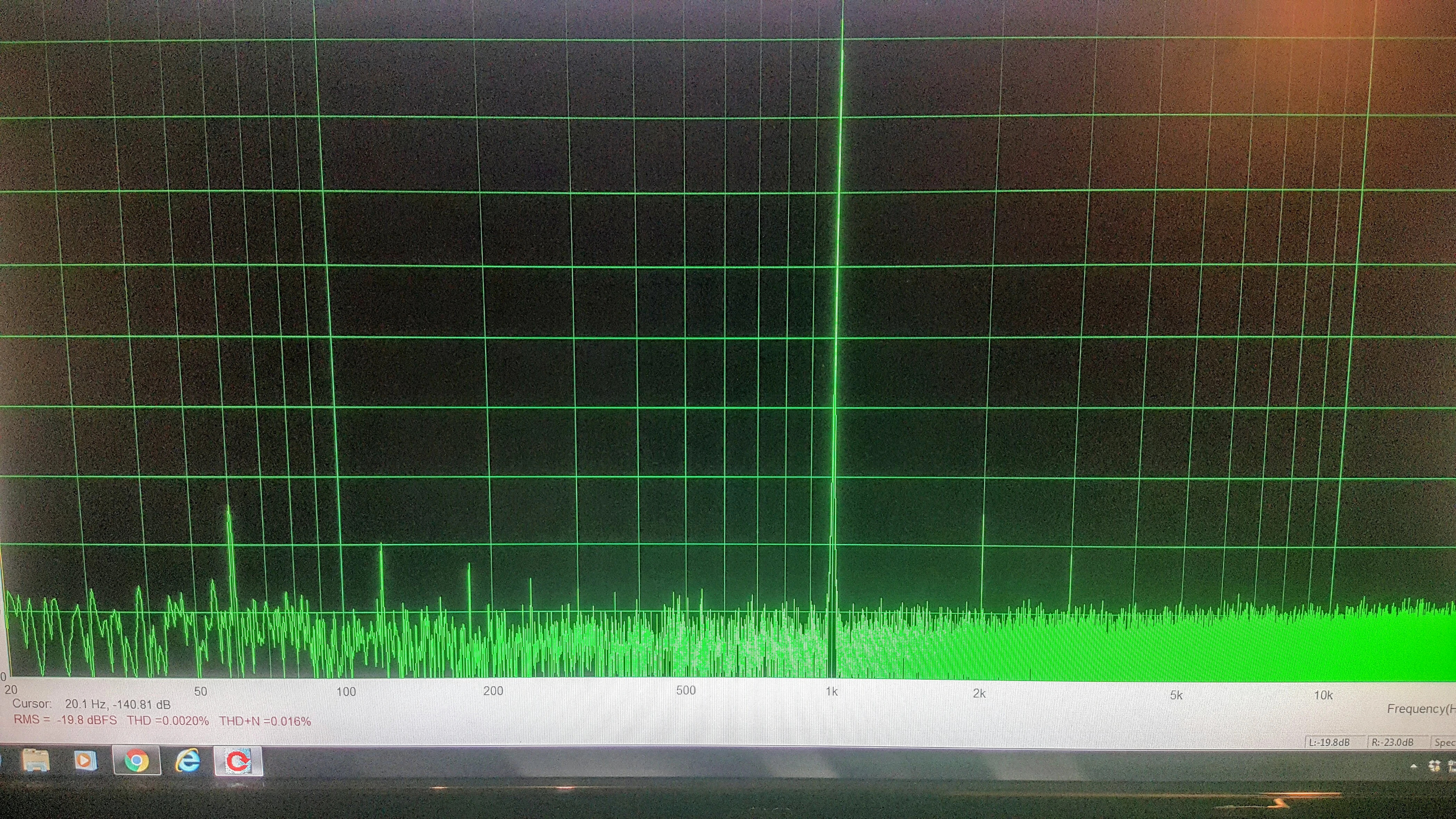

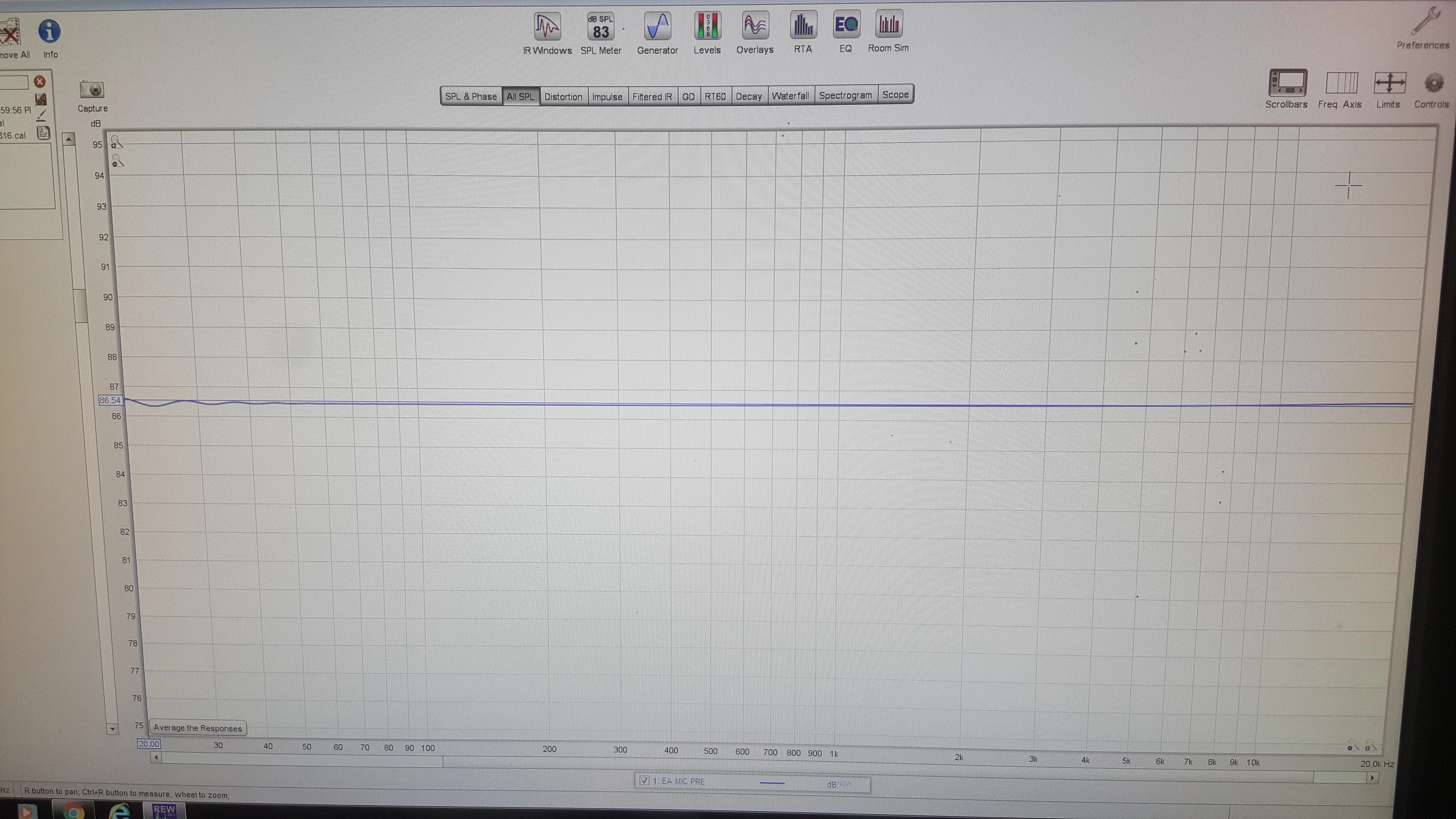

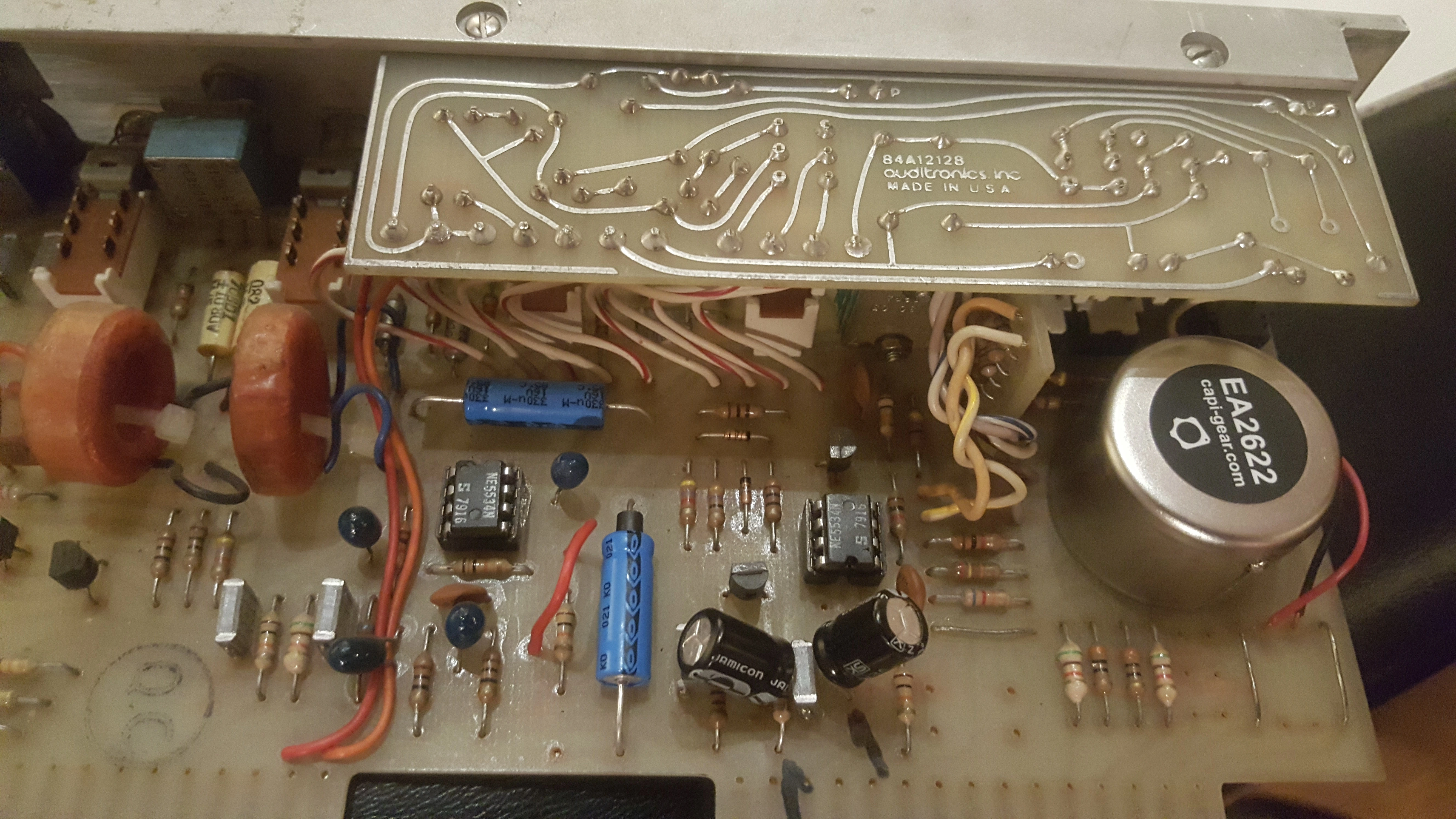

More progress this evening. Started doing some more in depth testing. As mentioned before, there is a hodge podge of input transformers on this thing, and I'd like to get them all standardized. I decided to give Ed Anderson's EA2622 a try, as it very closely matches the original specs of the Jensen iron that was original to the console.
I'm blown away by how this board, built in the 1970s, performs.
Frequency response is near ruler flat 20-20k. THD on 1kHz sine at reference level is .002%. The noise floor is slightly lower than original specs at 76dB below reference level.
Lots of functions to continue to test, but I'm 100% a believer in this board.

Man! That looks pristine! And specs are that good without any re-capping??? Or did I miss that?
