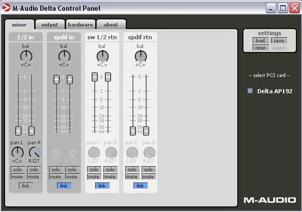

I did use the Delta 1010 for a short time and when i was setting it up, it was done through the M Audio control panel which i assume you'll have aswell? On the control panel there's a 'Routing' tab aswell as a few other hardware settings. Would this not be your answer?
Sorry for the condescending attitude . Just trying to get some straight answers.
I suppose posting this in the newbie forum I should expect to hear the most obvious answers first. Although I am a newbie to M-Audio, I am not a newbie to sound production. I have checked these most obvious answers already.
Here are the screenshots of the three tabs in the control panel.. as you can see none of them are for routing:
So I am at a loss. I do not mean to be condescending, just as you did not.
Yet I would really appreciate it if there was someone who actually has used this card and the current software to record streaming audio. Or if not someone who can tell me how to do it anyway.
