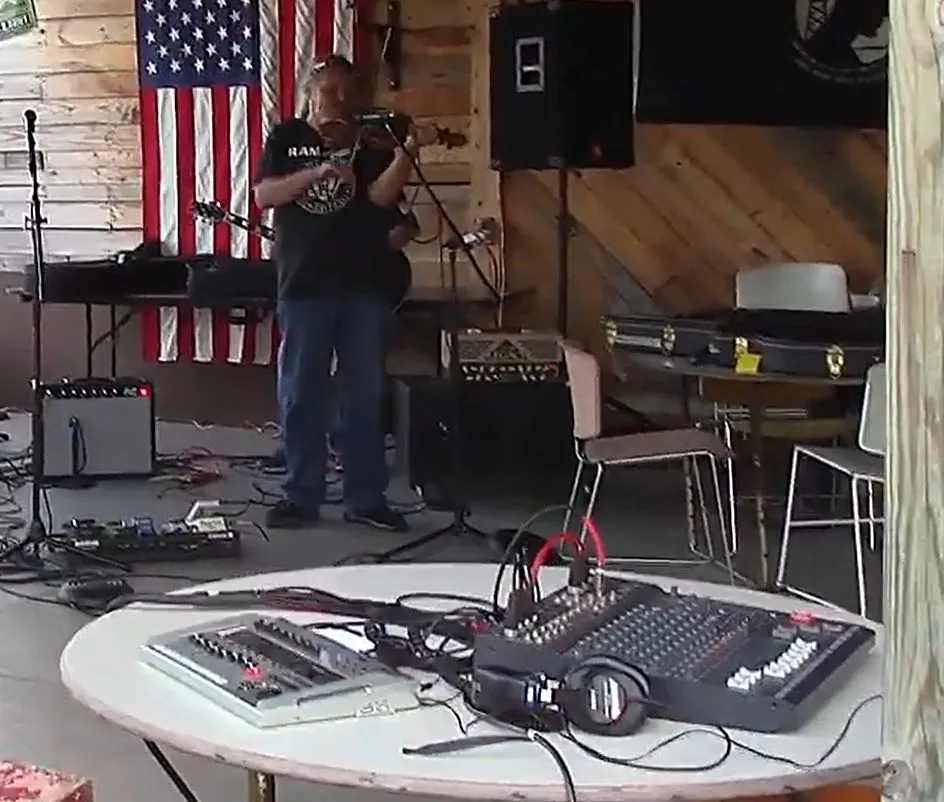

I've done live recordings with a Zoom R24, which has 8 inputs and an MX12/4 mixer which handled vocals. The vocals took one track leaving 7 tracks for instruments, not quite what you say you need. A 16 channel snake feeds the inputs to the setup. Here it is on a tabletop a few years ago. If I was starting from scratch, I would probably just grab a Model 24.
