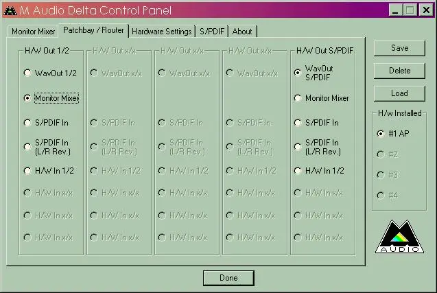

Slack I can dig what you're saying, except I can't choose what you are choosing under the patchbay tab. See the atached jpeg and you'll see that the options I have are not highlighted that you have available and vice versa. I'm not sure why this is.
Also what are the differences between wave and ASIO drivers? I'm basically using cool edit pro so how should this impact my buffer settings?

Allright. I clicked on -10 dbv on the outputs, the tried another sample recording.iT started out great then toward the end of the bit the noise came back. BTW Nothing os being overdriven so rule that right out!

Rats, you have your patchbay setup correctly. The reason that I had extra options is that I have a Delta44 which has 2 more ins & outs.

Have you tried this:
make sure in the Control panel:
MONITOR MIXER
all your faders are up, stereo groups are checked,and non of the mutes or solos are checked......slide your pan faders hard left and right....check off #1 AP.....
PATCHBAY/ROUTER
check off monitor mixerfor both H/W OUT 1/2 and H/W OUT S/PDIF.....check off #1 AP ( if you are not hearing what you are playing, ill guess you have WAVE OUT selected under H/W out)
HW SETTINGS
check internal xtal
codec sample rate to 44,100 (if thats what youll use)
check rate locked and reset rate when idle (i dont know why)
check single and in sync and consumer
check disable control of the monitor mixer........
buffer (set wherever it works for you....start off at the highest just to get started)
S/PDIF
check off consumer
of course, thats the settings if you arent using s/pdif.......
if you use these settings, you should be able to record and monitor everything.....
