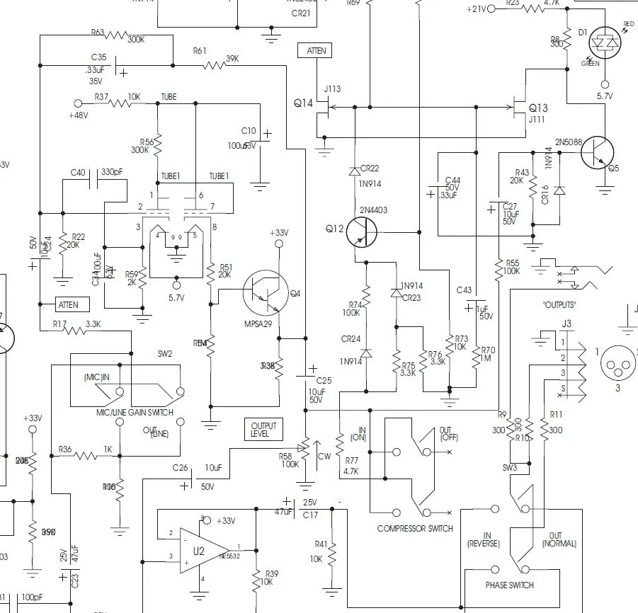

Tube section of the Tube MP (the Dual Tube MP likely similar) below for those that can follow it. Cathode follower design...
Obliged for the circuit Mark, do you have a link to the full Monte? A very good, good value ECC83/12AXY is the TAD 7025 HG. Loss his and microphony and worked very well as the front end of guitar amps. Here about £12-£15. A lot of the valves touted on the internet are re badged crap, Some GENUINE NOS can be good but you really need a valve tester to prove they meet spec' .
N.B. There is no such thing as a low or high 'gain' 12AX7! The amplification factor, 'mu' of a triode is determined by the cathode/grid/anode spacing and the tolerances are microscopic. If a '12AXY' does NOT have a mu of 100, it ain't a 12AX7! Other factor will also be out of whack such as slope resistance and bias requirement.
There are sonic differences between valves but since there is so much 'old sold for new' ***t about it is very hard to be sure. In any case the differences for a given type are not huge. That is not to say some valves are not better than others. Morgan Jones has done the tests and some double triodes produce about an order more THD than others. One of the worst valves for distortion was the ECC83 and the ECC82 (12AU7) but since the former was really designed as a driver in amps with NFB and the latter in tellies (not for audio!) should we be surprised?
Dave, the schematic came from Service manual, eprom result list | ElektroTanya | Service manuals and repair tips for electronics experts . It's actually the 'Tube MP Studio', but I suspect the other versions wouldn't be too different.
