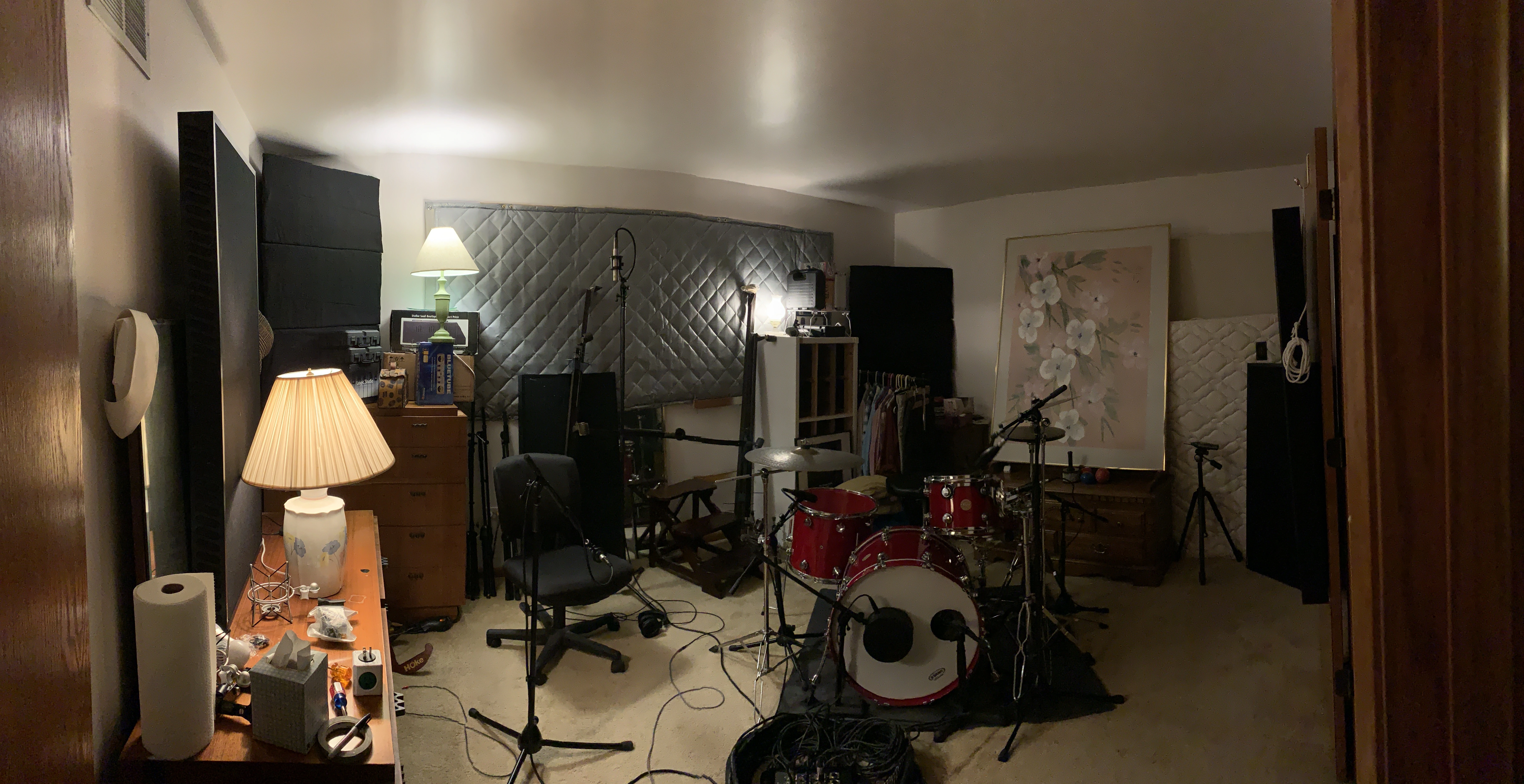

I just moved my drums out of the living room and into an unused bedroom, which I've started to treat with bass traps and minitraps. it's fun to get it all up and going! I have the ribbon front-of-kit mic out by the door, so I put a gobo/trap in the doorway so that it isn't picking up the long hallway with the back end of its figure 8

so instead of running the outputs of the kick in/sub mics to a bus and compressing that, I used sends to run the kick mic to a parallel compression bus and let the kick and sub kick mics signals go out into the regular drum bus with all the other drums. for snare, toms I did the same thing: did a parallel compression bus for them. I also turned up the room mic because then the kit became quite full. I think these are a little beefier than before. Thanks for the ears you guys. It's always good to get other opinions. You hear the thing so long you get used to it and lose a little objectivity.

Remember, treat tracking room different from mixing room. Tracking room is for the sound you want to capture, mixing room is to make the room neutral as possible.
There have been numerous stories of people recording in hallways, bathrooms, etc. to get a certain sound into the microphone. Unless you have to track and recording in the same room, treat them different. Plus, in your tracking room, you always have the option of mic placement.
I record in my mixing area and therefore have to put some life back into my tracks. Just food for thought.
